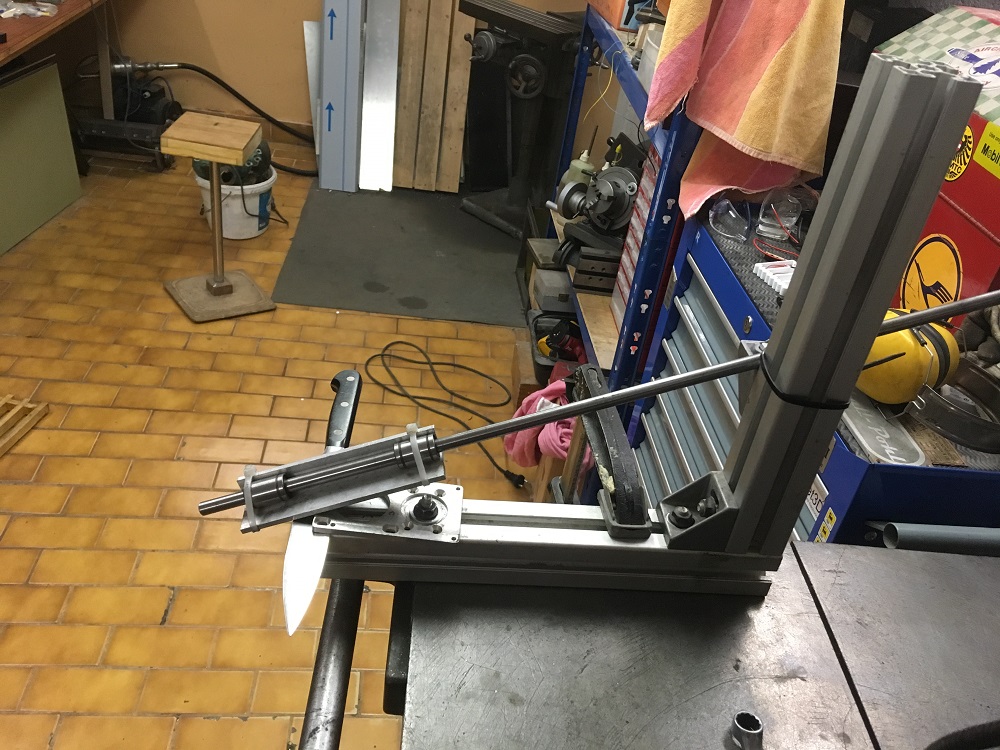

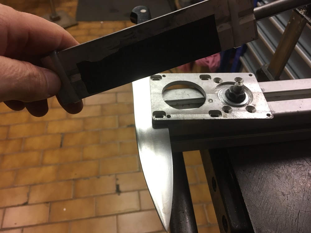

Since I practice analysis paralysis, I challenged myself to whip up a knife sharpening jig out of junk that was laying around, in one quick session without stopping. Made this in about 15 minutes.
Considering the tie wraps and double sided tape holding it together it works pretty well. Now it gets improved. I have already made stone holder with four grits of stone. Next I want to design and mill a decent knife holder.
