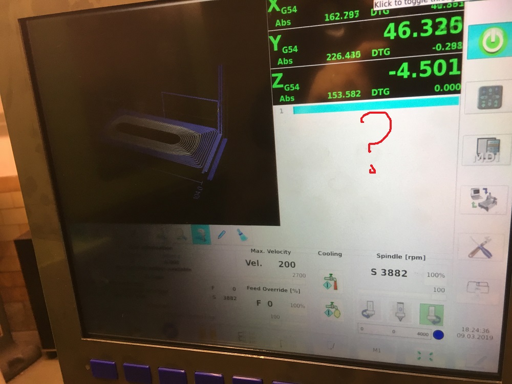

This is the first tool path I have generated with CAM.
As you can see I screwed up the tool material setting, and number of flutes, and left it as 2 flute HSS, when it was an 8mm carbide four flute, explaining the 1/4 feedrate it should have had.
I used a FANUC 11m PP to generate the code. Then edited it on a PC in wordpad to delete some of the initial codes which LinuxCNC doesn't have (G23?), and also edited the code in mousepad. It ran fine, but the code part of the window only shows a line one, the rest is blank.
I have attached the gcode file. I would appreciate if anyone could please point out what LinuxCNC is being tripped up on.

Hi Mark,
my first gues, the comment probably?
I can try to run the code on my machine tomorrow.

10 Mar 2019 08:15 #128208
by RotarySMP
Thanks Hanno, I did delete that G01 from the header, as LinuxCNC doesn't like a G01 without an F.
Mark
