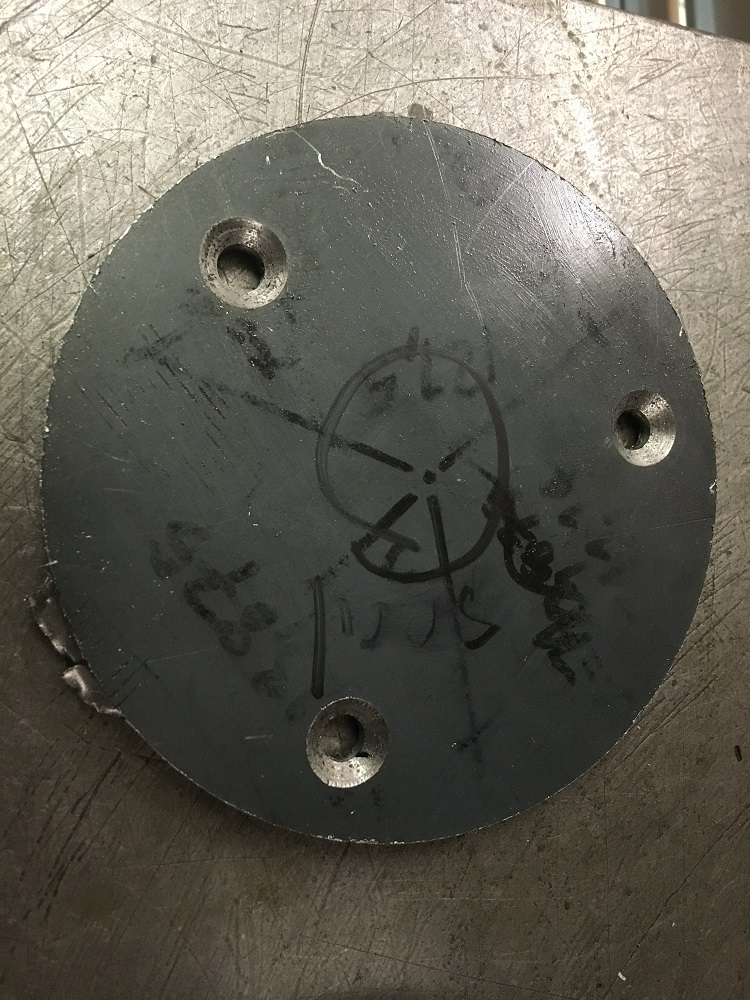

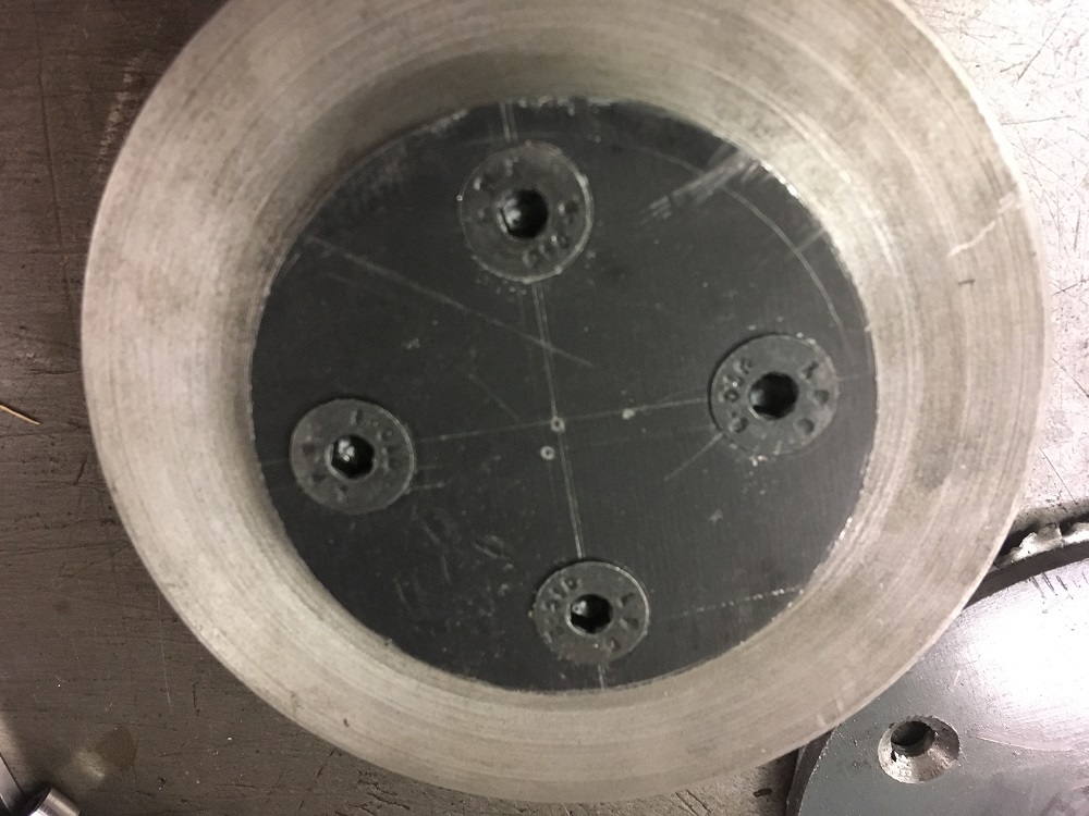

16 Mar 2019 19:36 - 16 Mar 2019 19:45 #128761
by RotarySMP
I had another play with thread milling today.
Also needed a couple of round pieces of 6mm mild steel plate.These are the end plates for the wheel of my sand muller. The Maho made pretty quick work of chopping out the circles. At least least it seemed faster while cutting at 700mm/min, and required no effort from me other than chopping out the last half mm with a cold chisel before turning the back side.
Mark
Mark
Last edit: 16 Mar 2019 19:45 by RotarySMP.

- Posts: 19753
- Thank you received: 4586
16 Mar 2019 19:54 #128764
Replied by andypugh on topic Retrofitting a 1986 Maho MH400E
Nice that it worked, but I am slightly confused why you thread-milled it when you already had it set up on the lathe?
