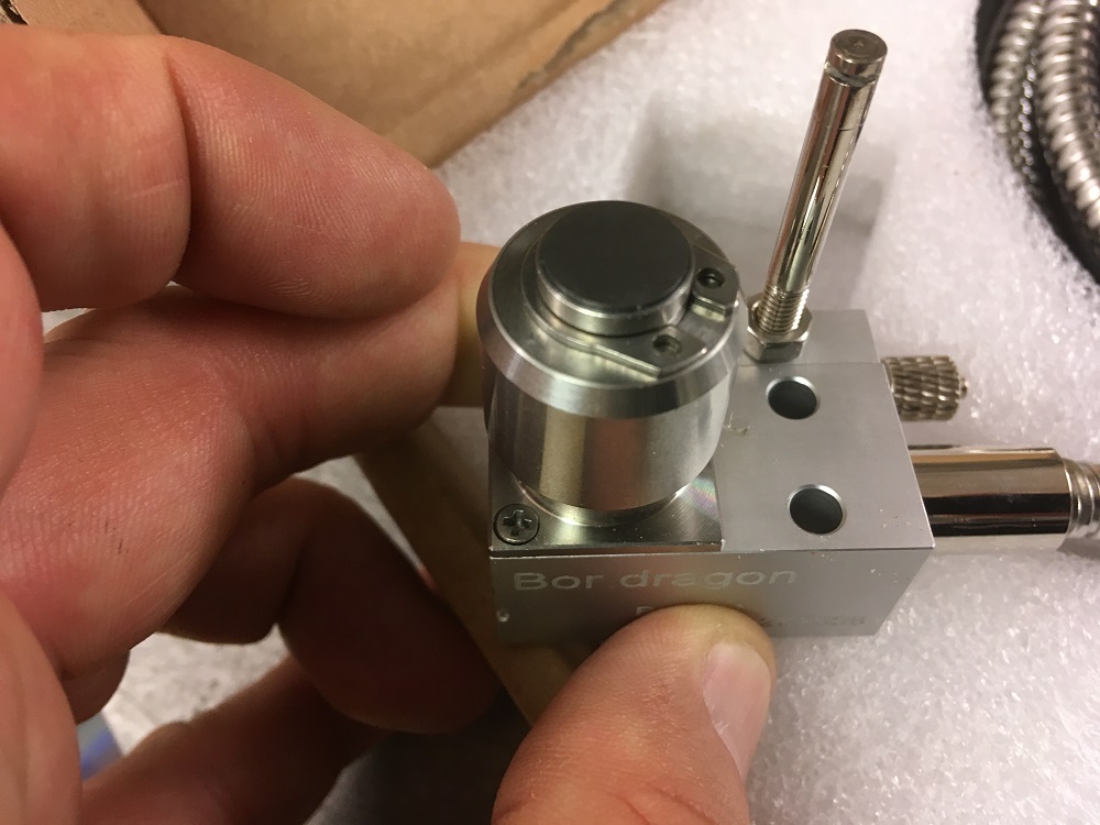

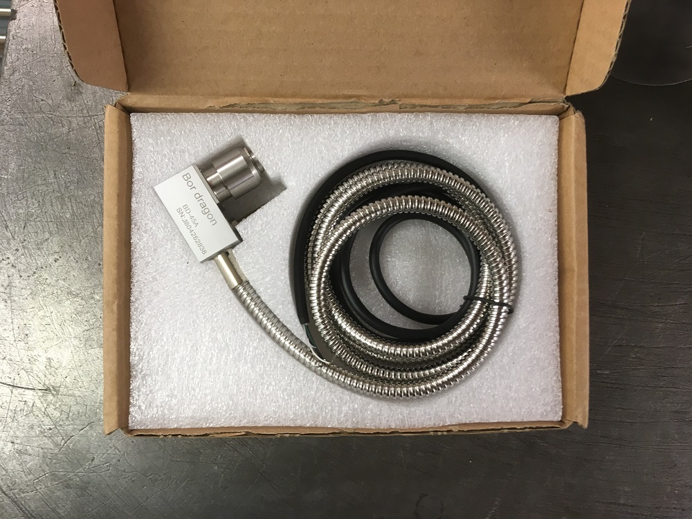

25 Apr 2019 20:11 #131880
by RotarySMP
Inspired by this post:
forum.linuxcnc.org/38-general-linuxcnc-q...inese-tool-presetter
I bought a Chinese tool height setter. It arrived today.
It appears rather well made, with nice laser engraving of the logo. The tool striker plate appears to be carbide as advertised.
Lucky it is a simple device, as the instructions are not clear for me...
Now I'll need to get it working with LinuxCNC.
Mark
Mark
