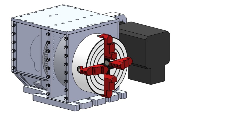

At the moment I'm working on this project which will be documented in Peter's CNC-Ecke :
Hanno
nice thread milling video Mark !
Hanno
