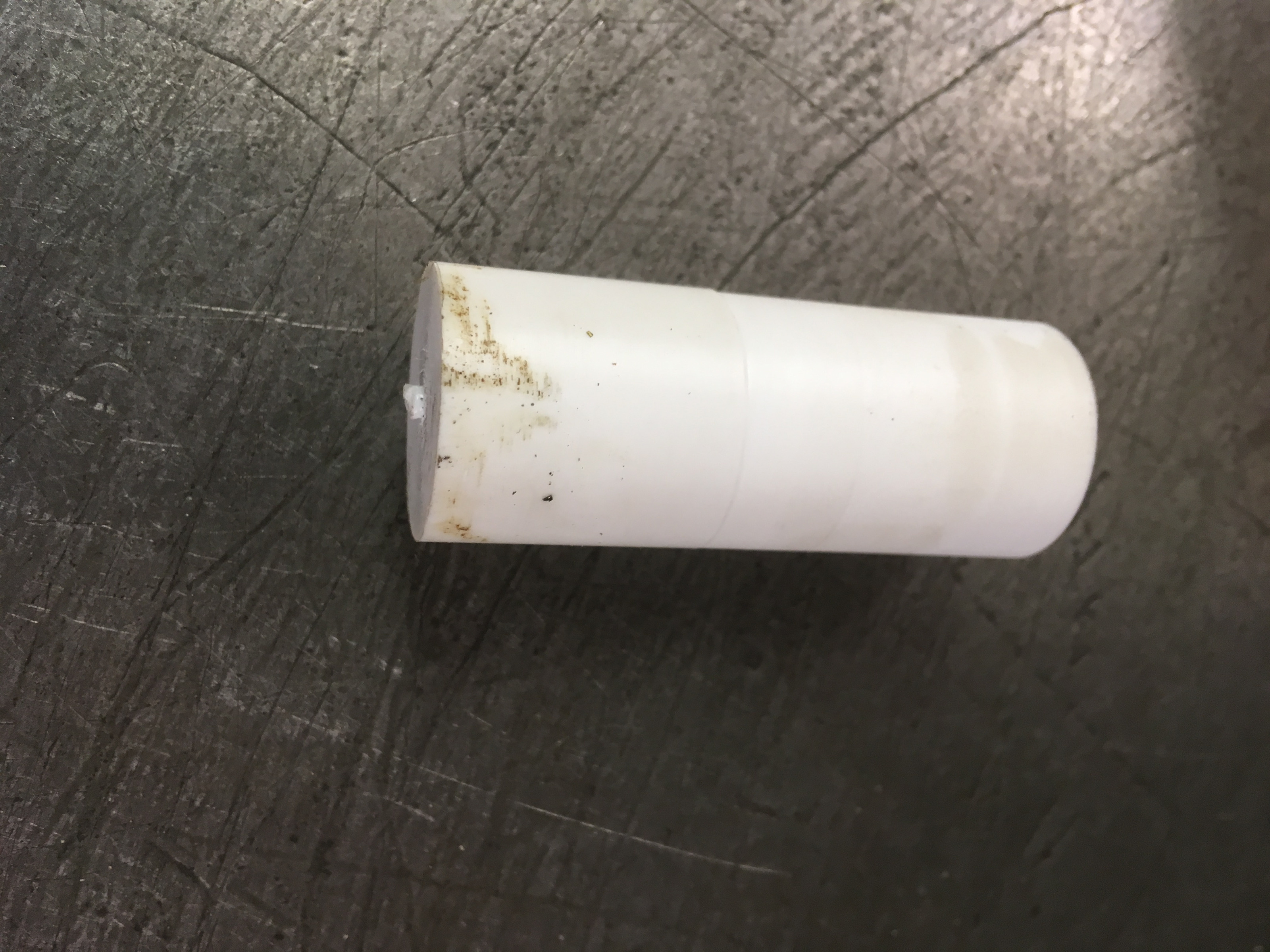

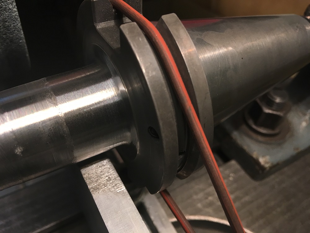

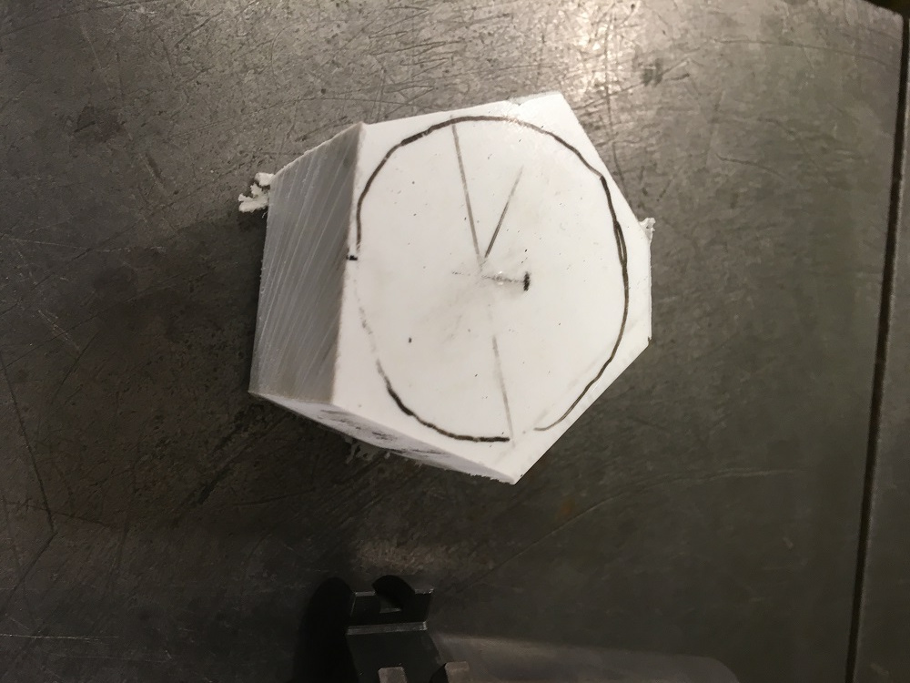

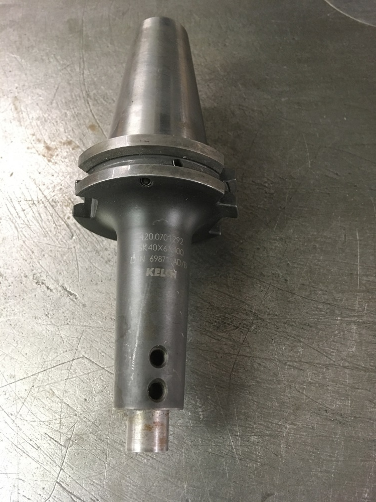

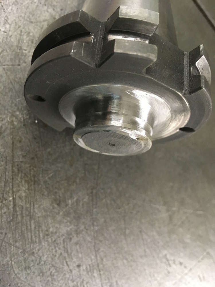

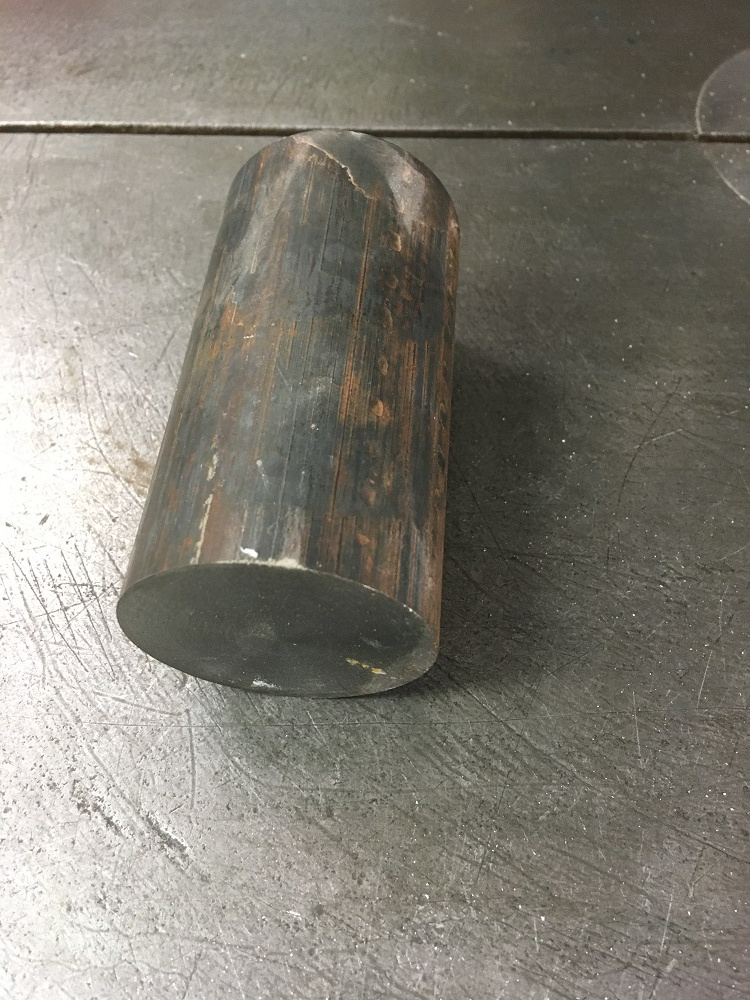

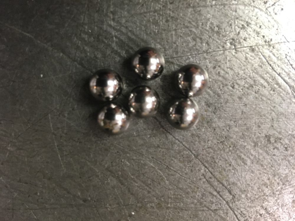

I was given a tool holder with a broken off carbide jamming the hole.
Picked up some offcuts of an industrial plastic. (something harder but still insulative would be better)
Scrap endmills provide 6mm carbide shafting. These ones I bought as scrap, although I have a talent for produing scrap end mills.
Six balls from bearing
And a slug of Meehanite.
You can probably guess where this is going.

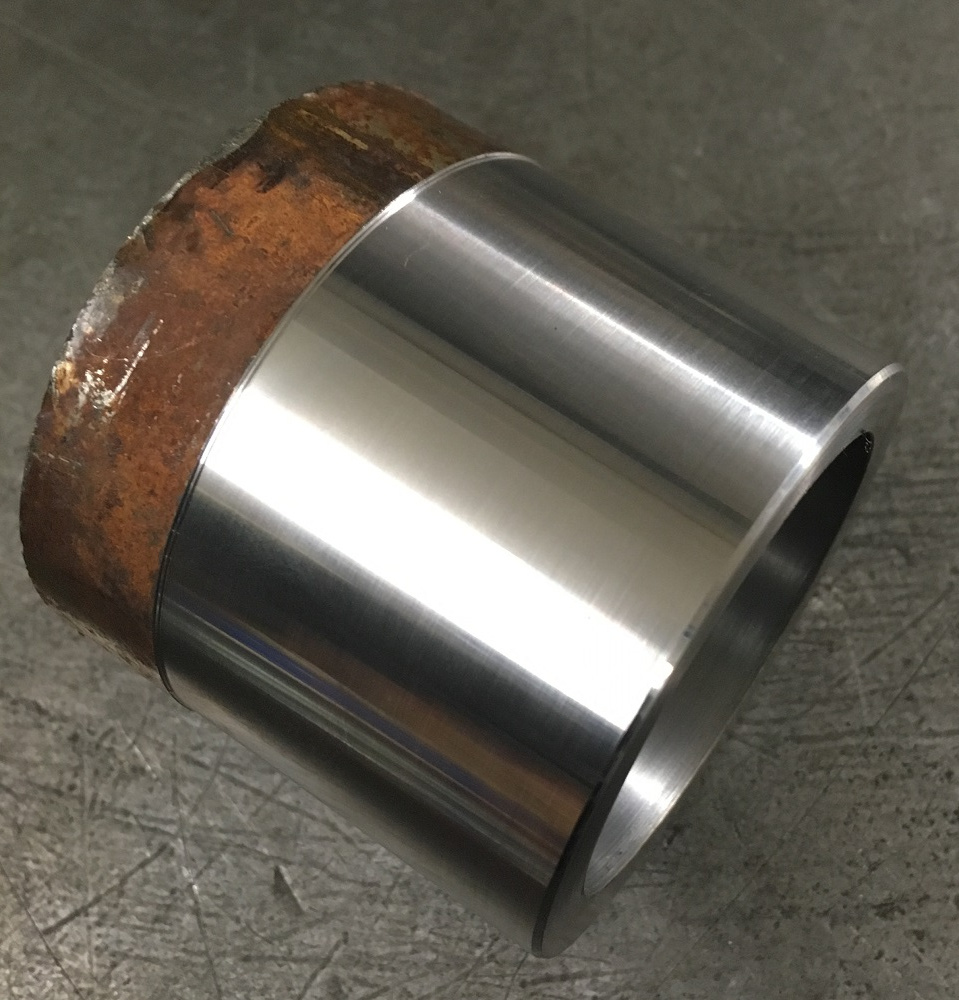

Yesterday I felt more like turning than milling. Switched from the Meehanite to a 50CrMo4 drop I got from the scrappies. The finishing pass was a fresh TMCT090402 insert at 1800rpm, very shallow cut and low feed. The swarf came off as sparks, but it looks pretty.
Ground the mounting boss round on the SK40 tool holder, and then ground in an alignment goove using a cut off disc, before parting it by hand.
My grease press arrived so I filled it with Kluber NBU15 and lubed the angle gears of the MAHO.

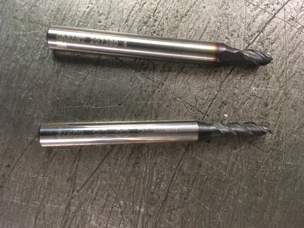

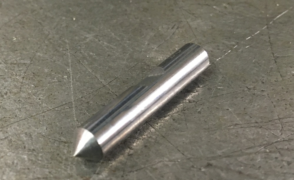

I've been thinking about how unenjoyable engraving is at 16mm/min with the MAHO screaming away at 4000rpm. Decided to add yet another project, and ground up an old carbide endmill for a drag engraver bit, and then started making a holder for it.
Mark

A lot of work for only 750rpm more, and engraving wouldn't need 1.2kW, wouldn't it be better to go with the little frame size ten, and 20K rpm. You could probably fit the tool inside an ER 32 collet
I have an ER-16 collet chuck with 20mm shaft, and a set of P4 AC bearings stashed away in my future projects treasure trove, waiting to be turned into an engraving spindle. There wasa really good one made on CNCZone years ago, where the maker used the rotor and stator from a BLDC model motor as an itegrated motor/spindle. Not sure whether the is much of a benefit now that the chinese HF spindles are so cheap.
It looks like drag engraving works very well on aluminum. Probabaly can't do a useful depth on steel. At least I won't be thrashing the MAHO at full rpm for hour doing that.
Mark
Mark
