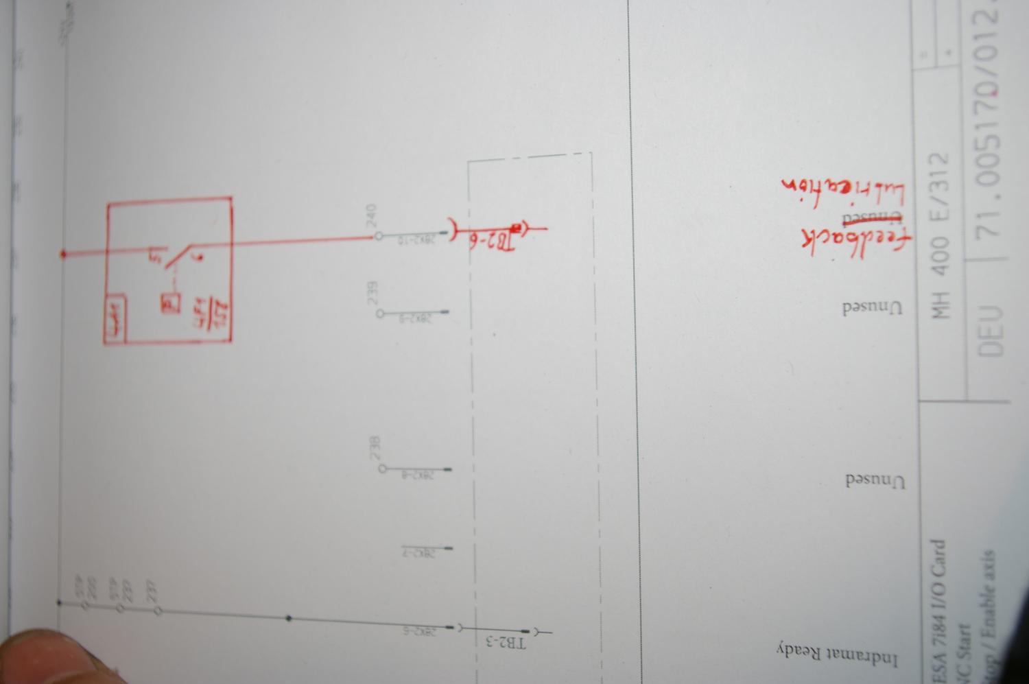

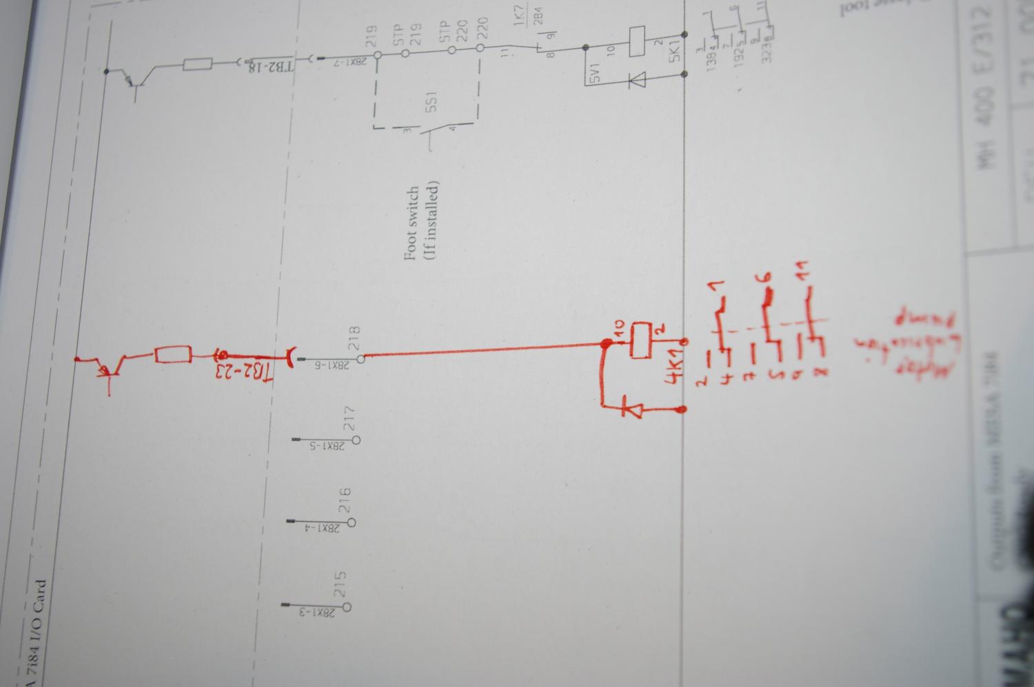

Hi All! How you solve a problem with lube? I don't understand how lube subsystem works. Whether there is a component for lubing?

05 Apr 2019 15:58 #130346
by R2AIV
Replied by R2AIV on topic Retrofitting a 1986 Maho MH400E
What i must do with the "lube" input signal on machine?
- hanmon
- Posts: 73
- Thank you received: 23
05 Apr 2019 16:42 #130352
by hanmon
Replied by hanmon on topic Retrofitting a 1986 Maho MH400E
do you have the schematics for your Machine ?
There are (little) differences through the years.
The timing of the lube on my machine is controlled via lube.py which I already sent you. It has an output to switch on the motor and a feedback signal.
See the attached schematics of the connections I made.
You might have Mark's older version which has an internal timer and probably no feedback.
