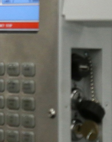

isent the USB post from the HAS control under the ROUND CAP at the side

Another idea I had for organizing computer parts in the MAHO is removing the printer receptacle and RS 232 port on the side of the electric cabinet (they're both bolted on) and replacing them with a couple of USB and Ethernet ports. I'm going to use the AMD parts that don't work with the Mesa card to make another computer for the workshop and I'm considering connecting the two with a cable for easy program transfer without worrying about having a USB stick. I could install Windows on the other computer and use Fusion360 for CAD and CAM in the workshop, saving myself a lot of hassle (the workshop is in a detached garage).

I also removed those ports from the side of my cabinet (you remind me that I was going to make a blanking plate.
Having a local network between the MAHO and the CAD/CAM station could be really nice. If you have the PC/MoBo mounted in the user module, with USB ports on the opposite side of the cabinet, you will exceed the 5m recommended cable length limit for USB. I had the same issue in the other direction, which I why I used a powered USB hub.
If you do that, I'd still recommend putting at least one USB port on the user interface module. It is very convenient to be able to plug in a thumb drive there.
I added three external USB ports to the user module for:
1/ File transfer with thumb drives
2/ the USB keyboard
3/ USB mobile internet stick which gets used for connecting the MAHO to the internet when I need to update anything. Normally it is offline.
Two ports there would have been sufficient, but I used dirt cheap chinese extensions to the Logitech powered hub which had four ports.
The fourth port is using internally to connect the touch screen.
These are the ones used...
