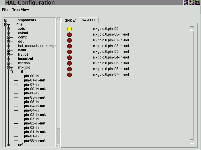

08 Sep 2012 12:11 - 08 Sep 2012 12:12 #24064 by ArcEye
Replied by ArcEye on topic Re:Running a machine with the NCBOX
Update time
Anthony sent me a hal component to access the GPIO header on the NCBOX and I have just had time to test it.
The NCBOX has a 26 pin header.
First pin on each row is power - +5v top and GND below and the rest of the 24 IO pins are divided into 3 x 8 pin virtual ports. (VP00 VP01 VP03)
The defaults for these pins can be programmed in BIOS, but standard is default to Input.
The component, hal_mxgpio.c compiled and installed without issue.
It is loaded and configured from the load_rt line in the .hal file
loadrt hal_mxgpio cfg="VP00 0x00"
for example loads the module, with Virtual port 00 activated and all bits set to 0, which is input.
To set all bits to output you would use cfg="VP00 0xFF", because 0xFF is the hexi-decimal encapsulation of binary 11111111, ie all bits set to 1
and so forth for all possible values in between.
The sample config supplied by Anthony used the GPIO to completely replace parport.0
Whilst a good demonstration of what it was capable of, I would never waste the IO setting it to the same as I could get from a parport, so I used it as a second port
To test it, I made up a 26 pin plug by cutting down an IDE ribbon cable and then connected to a parport plug, matching the existing pinouts for my MPG pendant on my big mill.
Assignments in my mpg.hal file were made as below, the syntax is just the same as a parport
net scale1 mux4.0.sel0 <= mxgpio.0.pin-04-in
net pend-scale axis.0.jog-scale <= mux4.0.out
net pend-scale axis.1.jog-scale
net pend-scale axis.2.jog-scale
net mpg-a encoder.1.phase-A <= mxgpio.0.pin-05-in
net mpg-b encoder.1.phase-B <= mxgpio.0.pin-06-in
net mpg-x axis.0.jog-enable <= mxgpio.0.pin-00-in-not
net mpg-y axis.1.jog-enable <= mxgpio.0.pin-01-in-not
net mpg-z axis.2.jog-enable <= mxgpio.0.pin-02-in-not
net mpg-4 axis.3.jog-enable <= mxgpio.0.pin-03-in-not
Tested and it just worked!
The 24 pin GPIO has great potential and should satisfy most IO requirements for stepper machines, allowing many more
input pins than a second parport would
Yet again the NCBOX has proved itself a good performer.
The only minor problem I have had, is regards parport voltage, which in common with most newer ports I suspect is 3.3V.
I have some long parport cables going through an old printer switch hub to allow one computer to easily switch between 2 machines.
This works fine with a 5V port but I had to plug directly into the relevant machine when using the NCBOX, having done so however it functioned perfectly.
regards
Last edit: 08 Sep 2012 12:12 by ArcEye.

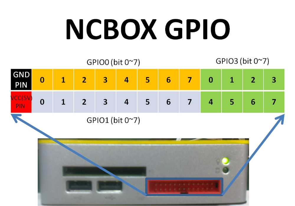

08 Sep 2012 13:25 - 08 Sep 2012 13:27 #24067 by ArcEye
And this is the GPIO layout
Last edit: 08 Sep 2012 13:27 by ArcEye.

09 Sep 2012 10:25 #24090 by andypugh
Replied by andypugh on topic Re:Running a machine with the NCBOX
A small niggle, but I think I would have presented it to HAL all as one port with pins 0 to 23 and a set of "is-output" parameters.
09 Sep 2012 13:52 #24096 by ArcEye
Yes, it does seem a bit strange, the setup into 8 bit ports is in BIOS and for some reason GP02 is disabled, so even the port numbers don't run consequentially.
DMP's main business is robotics, so it may be something to do with their requirements for that.
