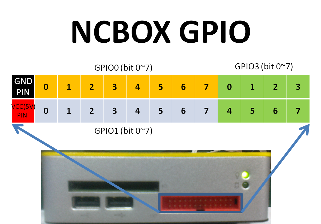

help me please with my confusion on the ncbox
(Update of status i have one cf with a manual compiled ok kernel and run linuxcnc 2.5.2 fine i had a parport config where i can also conrtol the vfd because of spindel orientation i have bought 8gb cf cards and used your binary package to be compatible ,..
that worked fine as well now i want to use GPIO
i did load down the code and compiled it in it should work
so now my confusion
1) the picture shows 2 times 8 pins
2) your text on tab 3 says you have the gpio as 3 times 8 pins
i tried the example nice but where is the pin ? i understand the masking but not where is which pin ?
so my question
would it be possible to use the "LPT" board "normal" like an lpt board
and on top configure the gpio board as 3 times 8 pins or like the picture says 2 times 8 pins
if i know which pin i can go to the machine and see if spindle orientation "likes" me ;)-
thx
thomas

10 Jul 2013 14:59 #36486 by ArcEye
Replied by ArcEye on topic Re:Running a machine with the NCBOX
Hi Thomas
You will be glad to know it is quite simple, you have been looking at a picture labelled NCBOX-PWM
The picture for the GPIO ports never uploaded for some reason, I think the picture size limit was lower then
So here it is
The ports can be set in BIOS but I seem to remember thay are all IN pins by default
regards

10 Jul 2013 15:46 #36492 by tkamsker
Replied by tkamsker on topic Re:Running a machine with the NCBOX
Ahhhhh
Verry nice thx for the picture ,..
i made yesterday pin 7 to respond
so i was afraid to use try & error for that pins now i am verry happy ,..
