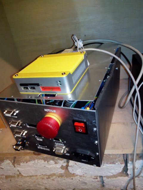

16 Oct 2013 19:04 #39957 by tkamsker
Replied by tkamsker on topic Re:Running a machine with the NCBOX
Hi
I have prepared 2a PCB which is dividing the voltage from 24v down to 5 v then uses an optcoupler to be able to selct if Pullop or down
So if there is interest i can publish the eagle files i have an PNP and NPN version ,.. I use it for spindle orientation
And here is a picture from my setup (for the endswitches i use the Functionality of my BENEZAN Triple Beast board )
thomas
