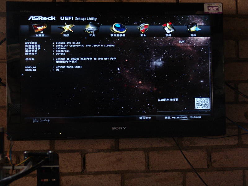

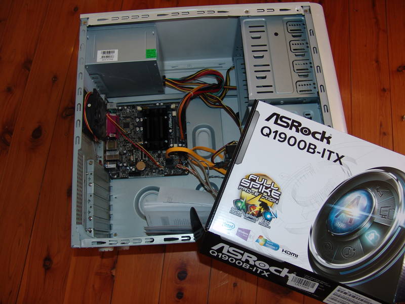

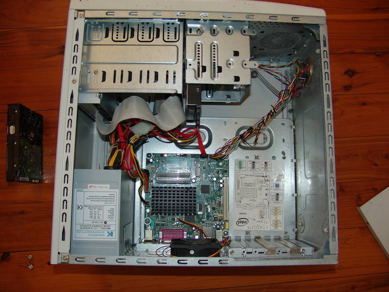

16 Jan 2015 06:31 - 16 Jan 2015 17:56 #55054
by SrLange61
Replied by SrLange61 on topic Tiny Computer with Printer port
Yesterday I upgraded my Intel D525MW with a ASROCK J1900B-ITX and the performance is much better.
For the price of a MESA board I go a up to date mainboard with processor for $90 AUD.
I'm using the old ddr3 memory and hard drive with standard 2.6 Deb Wheezy.
I plugged in the hard drive and it booted up. I'm having a problem finding HDMI sound but I think that's just a Debain issue, before I was using RGB.
The J1900 has the 1.5 bios and is in Chinese !. So far there is no need to upgrade it.
MAX latency is down 30% to about 17000.
Intel D525MW A good little board except for the GPU.
ASROCK J1900B-ITX
Anyone understand this?
srl
ASROCK J1900B-ITX
srl
