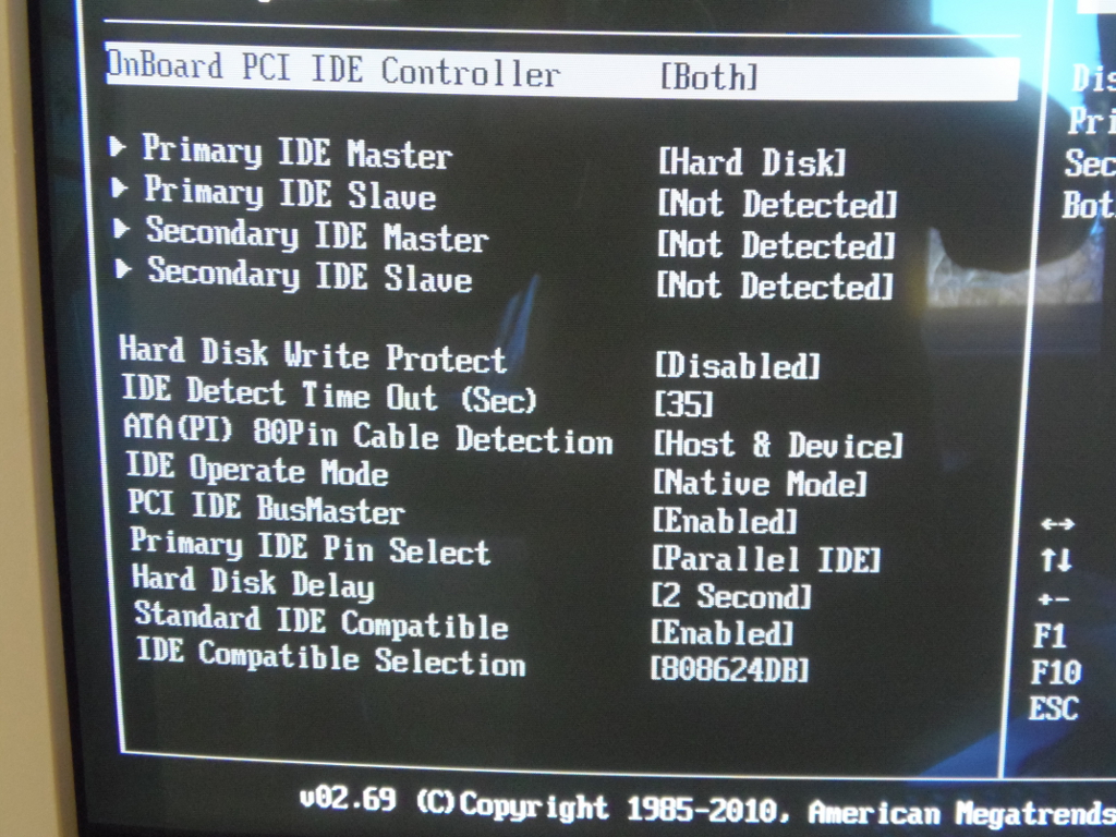

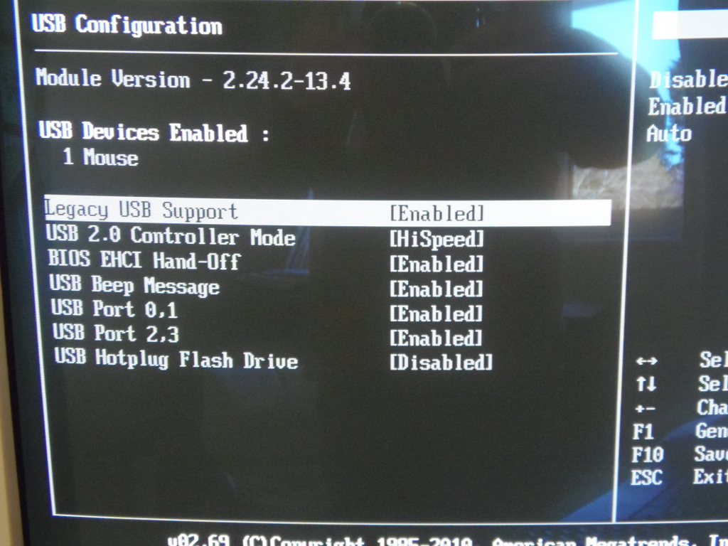

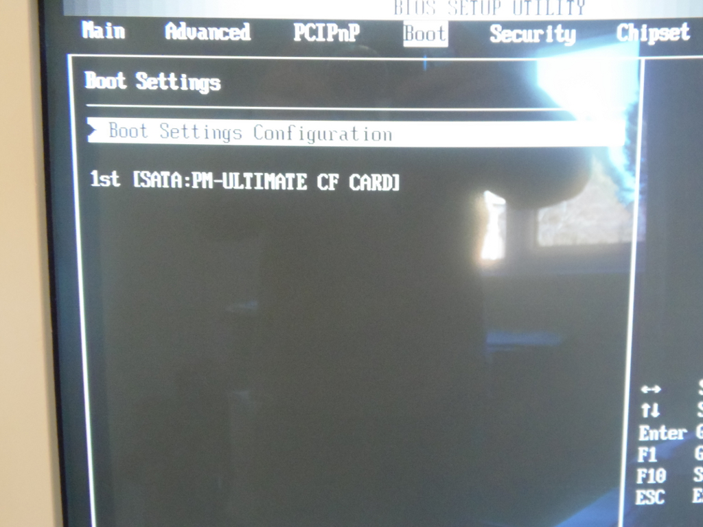

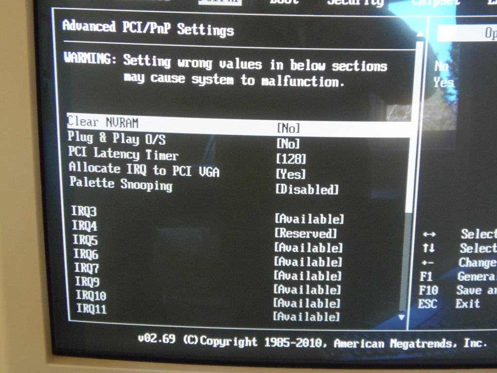

24 Mar 2014 00:13 - 24 Mar 2014 00:15 #45154 by ArcEye
Replied by ArcEye on topic Blinking cursor
+Hi
I have just downloaded the image, unpacked it and written it to CF card using a cut and paste of the instructions on my site.
It boots straight away and I am running a sim on it now.
These are the shots of how the BIOS should be set up
If you still cannot get it to run, as you are only in Eire, all I can suggest is that you send it to me with return postage and I will write the image to it and test it and return
regards
