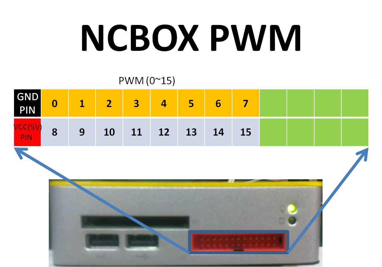

And here is the pic it did not like.

10 Nov 2012 00:23 #26413 by ArcEye
Replied by ArcEye on topic Re:Running a machine with the NCBOX
The current limit is 500Kb on file size... should it be larger?
It is probably ample for most uses, this was bloated by a high res graphic.
It is more that you do not get an error message as you used to, so are no wiser as to why it failed to attach.
