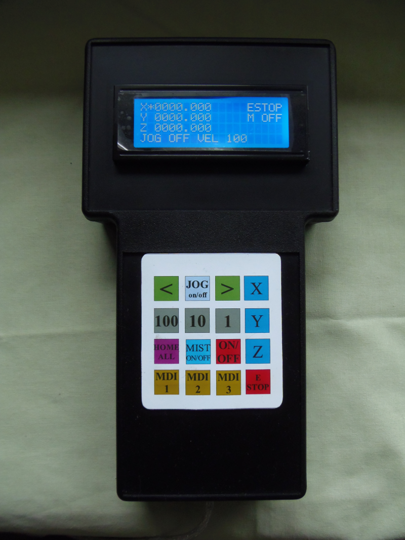

Hi
I bought a couple of arduino boards some while back, originally intending to use one of them for I/O within a machine.
That didn't happen, I solved it another way, but the idea of using one within an intelligent pendant took shape.
Someone else published something on the net about the same, but nothing that went beyond making lights flash was actually released.
This was accompanied by much grumbling about obfustication in Jeff Eplers arduino sample programs; since Jeff was squeezing everything into a couple of bytes using bitwise operators, it probably wasn't very easy to understand.
As I program in C / C++ not python, I just started from scratch.
The arduino has very good and easy to use, high level serial libraries.
It made sense to communicate with it by serial over USB, which meant the linking Linuxcnc module would have to be a userspace one.
This means the module runs in userspace rather than on a real time thread.
serialcon.comp
A userspace component can still create hal pins to connect with other parts of Linuxcnc, it will just be slower, but can use all the standard libraries for port access etc.
The first requirement for a component module is that it is launched from Linuxcnc and linked to the running system. Mine has HAL pins which connect to existing axis pins to fetch the current relative position of each axis.
It transmits these readings in fixed size charactor string packets to the arduino. This approach was chosen because the arduino then needs to display the readings onto a LCD screen and update approx every 1/4 of a second. It can display a string immediately without any extra processing, quite important with such a low powered processor.
The output side of the pendant takes the form of a 16 key membrane keypad. I made a printed self adhesive mask for it, to change the key designations. The arduino transmits a single charactor code for each key pressed to the serialcon module.
This is processed and translated in the serialcon module, for the main part into system calls, using the halui interface to Linuxcnc.
halui is a very powerful interface, giving access to most of the commands and data necessary to run a GUI.
From the pendant I can set and reset ESTOP, Machine On, Home All, Mist on / off, select axes, select Jog rates, Jog all axes.
It also operates 3 pre-defined MDI commands.
These could be very powerful commands, running entire programs if so desired.
Mine are currently set to simple movement co-ordinates; MDI 1 commands G28, MDI 2 commands G0 X20 Y20 Z20 and MDI 3 another set of test moves.

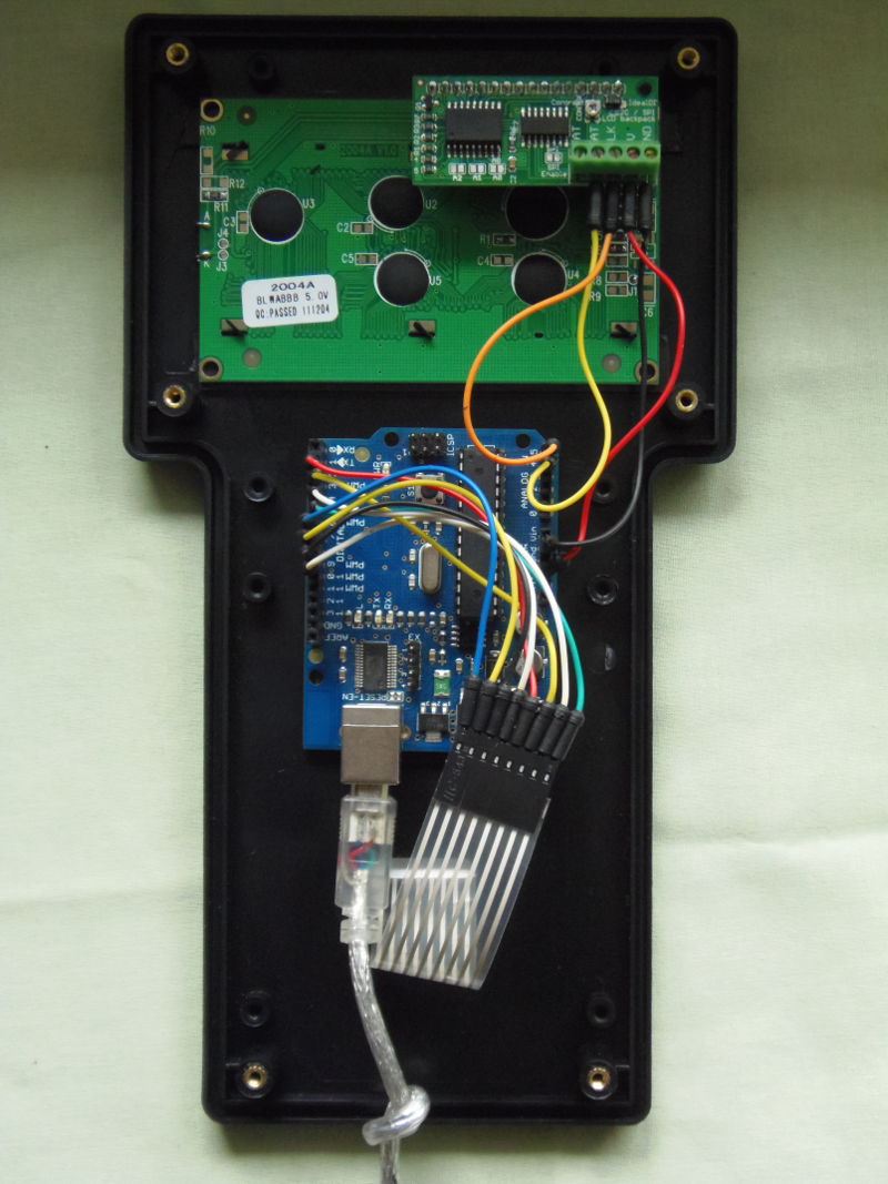

The Arduino sketch
The arduino sketch first sets up everything we need, which basically is Serial, Keypad and LCD
I used an i2c backpack on the LCD display which allows everything to be done through 2 wires.
You might not need to do this, the keypad takes up 8 inputs and you could redefine some others
But I had one so I used it.
The main loop listens to the serial port and waits for 9 or more bytes, since that is the packet size
The normal packet consists of the axis letter in upper case and a 8 place float value in a string.
As explained previously this enables the arduino to just write the string to the LCD.
The extra code size and time taken to format to a string from a real float number outweighed any extra time spent sending or receiving the packet.
Things can be kept very simple if you stick to strings over the arduino Serial.
After each check for a serial packet a check is made for keypad inputs
If found they are processed and sent as a single charactor command back to the serialcon component.

The Arduino sketch

The circuit: using i2c backpack
* 5V to Arduino 5V pin
* GND to Arduino GND pin
* CLK to Analog #5
* DAT to Analog #4
// Connect via i2c, default address #0 (A0-A2 not jumpered)
LiquidCrystal lcd(0);

Limitations of the Arduino
I did create many more pins and try to display much more system data originally, but found that the poor little arduino just could not cope.
My priority was axis position display as near to real-time as possible, coupled with the swift re-action to keypad commands.
I found that 1/4 second usleep() pauses in the main LinuxCNC component loop, gave the best performance in terms of steady display updating. Any faster and the arduino could not keep up.
If more data was transmitted, the arduino spent too long processing it and keystrokes went unsent.
I am still working upon a reliable method of only sending data if it differs from the previous packet, thus cutting down needless refreshes, without spending the same amount of time doing the checks.
The whole thing is 'work in progress' to an extent, it may take a while to get it exactly as I want, but it works and shows what can be done
What precisely you do, especially with the keypad commands, is entirely down to you
Enjoy if of use

That is one nahhh-is setup.
I just have one question...
Where did you get the enclosure?
Frank
Frank
