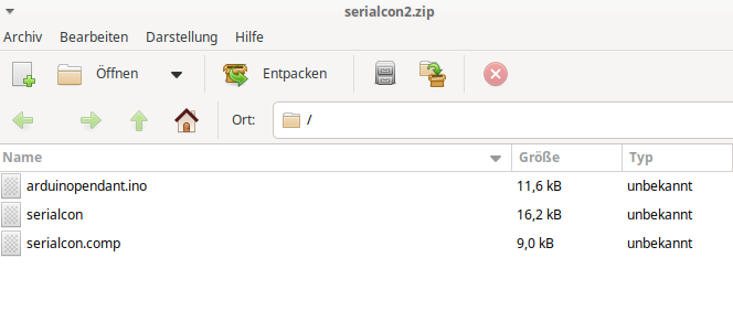

21 Aug 2023 13:14 - 21 Aug 2023 14:26 #278611
by step4linux
Replied by step4linux on topic Arduino based USB Pendant for Linuxcnc
hello everybody,
I was investigating for a flexible arduino-based, USB pendant solution and I came up to this old thread, since I did not find something more exciting (except HID based, which I would avoid).
My question: is there an "official" source for serialcon2? I found a link here, but the serialcon2.zip contains serialcon versions (without "2"). I could compile/install it anyway and it seems to be ok for my linuxcnc 2.8. What is the difference to "2"?
Any other suggestions?
kind regards, Gerd
kind regards, Gerd
