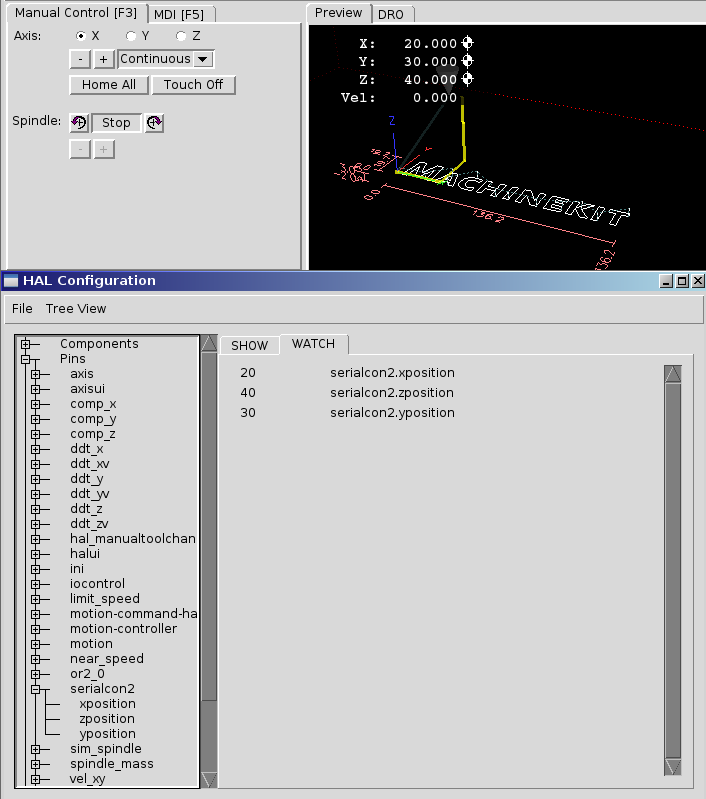

Start the config, look at Machine > Hal Configuration, check to see the component and its pins are connected to halui.
Then watch those pins and see the values changing as you move the axes in the sim.
If that works, it must be your connection, check the physical connection and that your Arduino actually uses /dev/ttyUSB0
AND that the device exists in /dev. udev might not have detected it and created the port for some reason.
A lot of Arduinos use different ports, but you should have seen which port it was on when you flashed it.

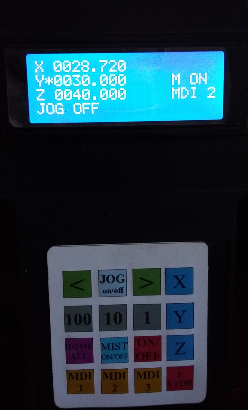

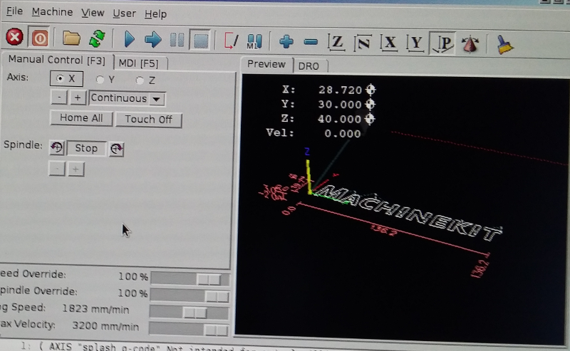

Running under Machinekit because that was what I had installed, minimal alterations to core_sim.hal file, just to load tp and declare kins and tp in the EMCMOT line, and the pendant just works.
Axis
Pendant
Hopefully you will find your problem soon, my best guess has to be the port address, which is hard coded in the component.
