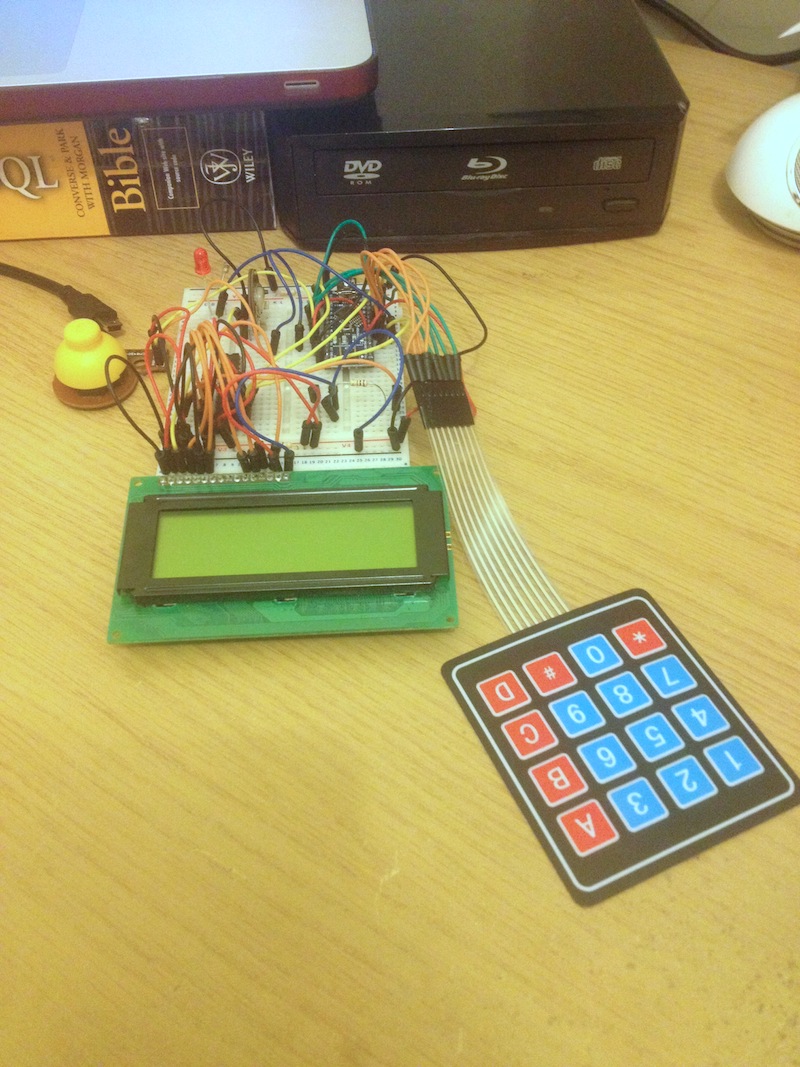

Hi All,
Just thought I would share the progress of my Arduino based pendant.
At the moment it lives on a breadboard, pending the construction of the required PCB. I am using an Arduino Nano as it has everything I need, including FTDI usb to serial chip and is very small.
I was not happy with the amount of time that the standard Keypad library took, so I wrote my own that uses direct port manipulation rather than digitalRead and digitalWrite and I reduced the scan time from 430us to 20 us. Unfortunately this used the majority of my pins, so the LCD has been attached on the SPI bus, clocking the bits out at 8MHz to a 74HC595 shift register; a full update of the screen takes 14ms. The purpose of these speedups is to leave more runtime available for serial processing. The keypad is scanned every 10ms using a timer based interrupt so as to ensure that I don't miss any key strokes and keystrokes entered into a buffer. Another feature I have added to my Keypad library is the ability to return the keypad status as two bytes, with each key represented by 1 bit. This reduces the amount of data that has to be transferred to two bytes, regardless of how many keys are active. Keys can also be set up as either momentary or toggle.
I have also begun work on a serial packet-based protocol for reliable communication of different data types. So far I can send integers and strings with no problem. The reason for this is that I am intending to use wireless which is especially prone to data loss so I need a protocol with error checking and rejection in it; we don't want the machine doing strange things due to corrupted data now do we? It would be a good idea to adopt such a protocol regardless of connection type, as any connection will suffer some data loss from time to time.
More information as I progress.....
Chris
