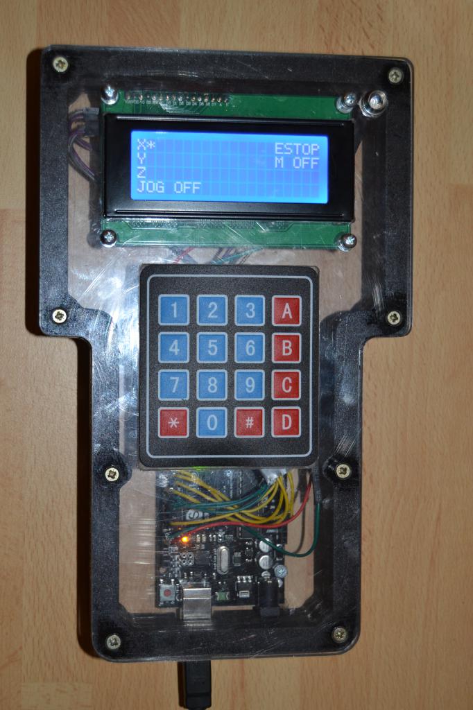

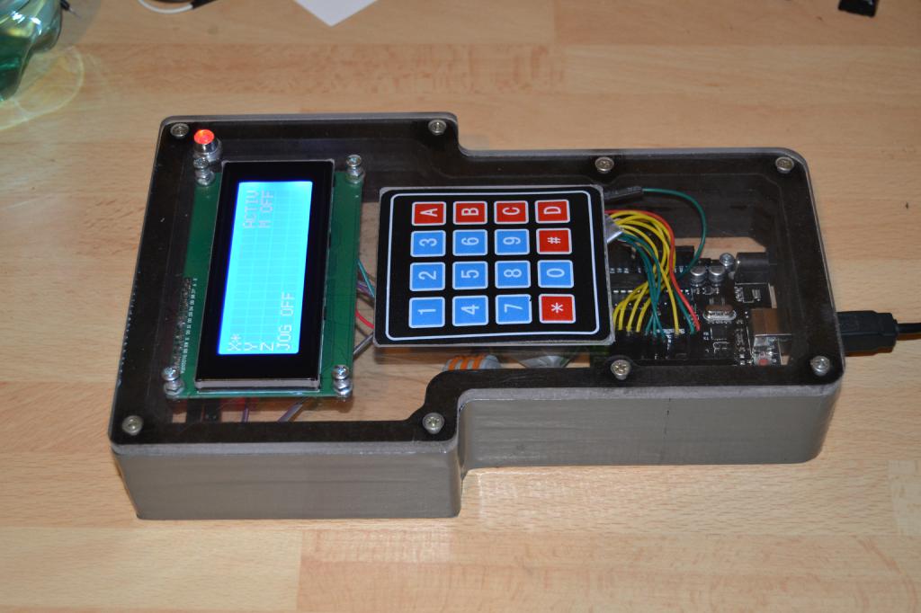

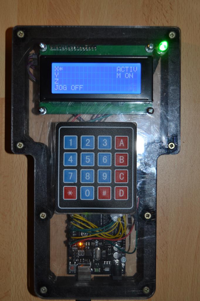

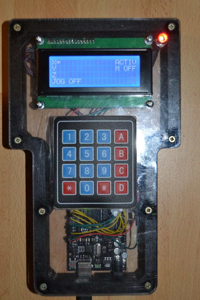

24 Sep 2016 17:47 - 24 Sep 2016 17:48 #80859 by Tchefter
Replied by Tchefter on topic Arduino based USB Pendant for Linuxcnc
Since I have to wait 3-4 weeks on the 7-segment displays, to build my external DRO, I thought I build the equivalent of ArcEye's Pendant also because all the material was in the drawer. The first test went well. Now I must learn as I adjust the fields on the keypad for me and as I have the DRO display on the counterpart and in Axis at the right side. The housing consists of 4 parts 8mm black MDF. The bottom and the lid are 6mm Plexiglas.
I have installed a red / green LED: red Estop is free, green machine is on :)
Thanks again! :)
Last edit: 24 Sep 2016 17:48 by Tchefter.
