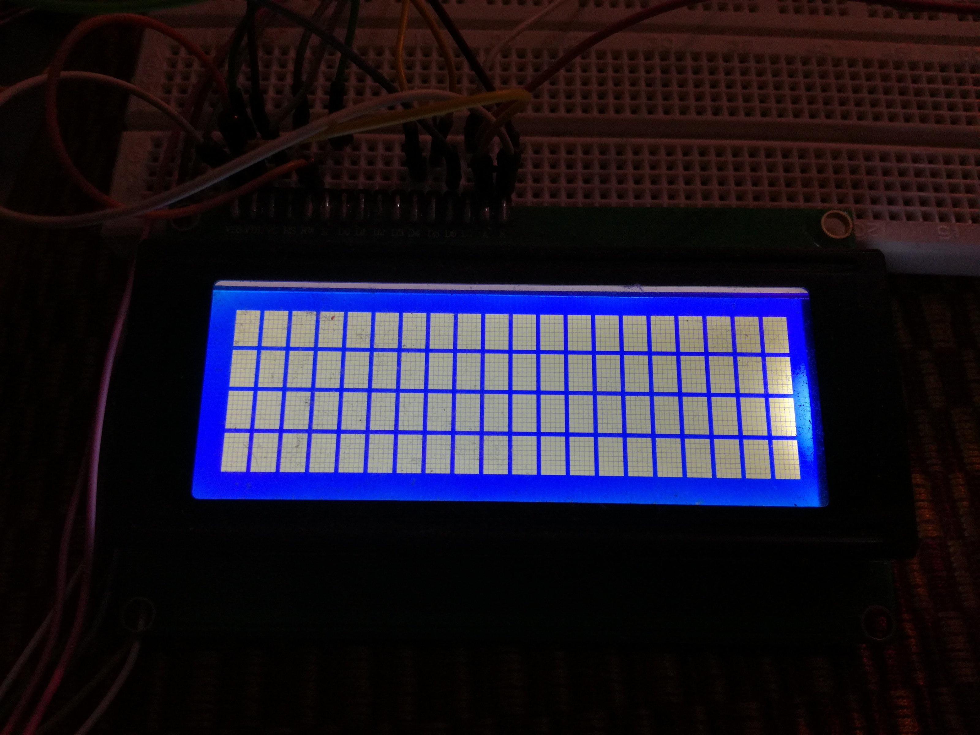

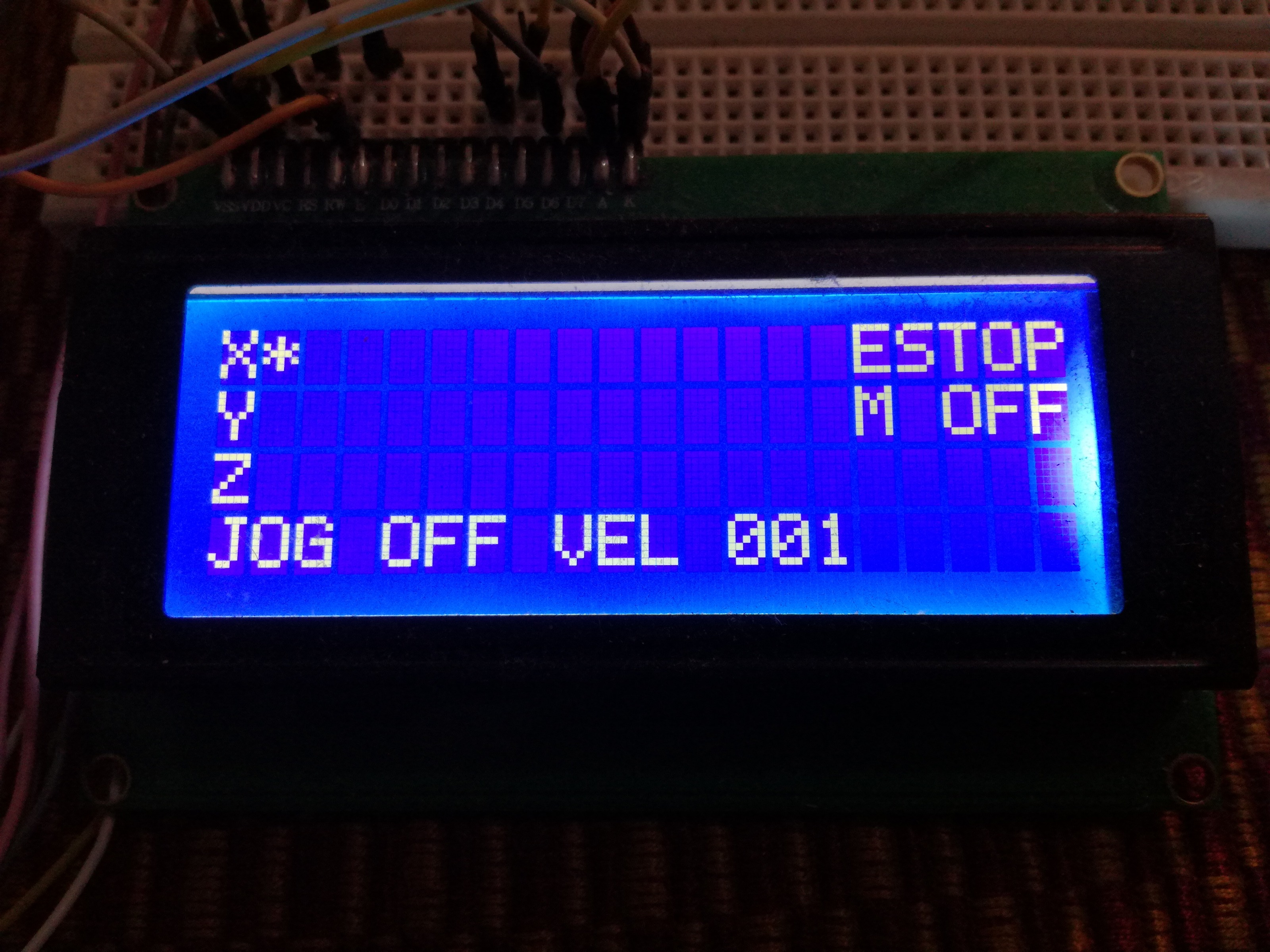

Hello, I am new to Linuxcnc, and i need some help. I tried to make the arduino pendant but I have a problem. You can see in picture 1(Linuxcnc is not started)
and in picture 2( that's what appear on the lcd when I start linuxcnc). I think it's a connection problem. Any advice? Thank you

Without a lot more information I can only guess.
At the most basic level, make sure that the #define DEVICE= definition in serialcon2.comp is correct for your board, it needs to be whatever port you used to upload the arduino script arduinopendant.ino
Failing that, you need to attach all your config files (ini and hal), run with DEBUG=7 in your ini file and attach the debug output from stderr and linuxcnc.log

16 Feb 2017 14:30 #88051 by ArcEye
Replied by ArcEye on topic Arduino based USB Pendant for Linuxcnc
For starters, you are trying to load the component twice
Once right at the start of adna.hal, before any rt components have been loaded
loadusr -W serialcon2
loadrt trivkins
loadrt [EMCMOT]EMCMOT base_period_nsec=[EMCMOT]BASE_PERIOD servo_period_nsec=[EMCMOT]SERVO_PERIOD num_joints=[TRAJ]AXES
loadrt hal_parport cfg="0 out"
setp parport.0.reset-time 5000
loadrt stepgen step_type=0,0,0
loadrt pwmgen output_type=1
and then again in custom_postgui.hal
It should only be loaded once in custom_postgui.hal, after everything else is loaded.
19 Feb 2017 12:28 #88256 by andypugh
Replied by andypugh on topic Arduino based USB Pendant for Linuxcnc
It looks to me like the brightness might just be turned up way too high.
