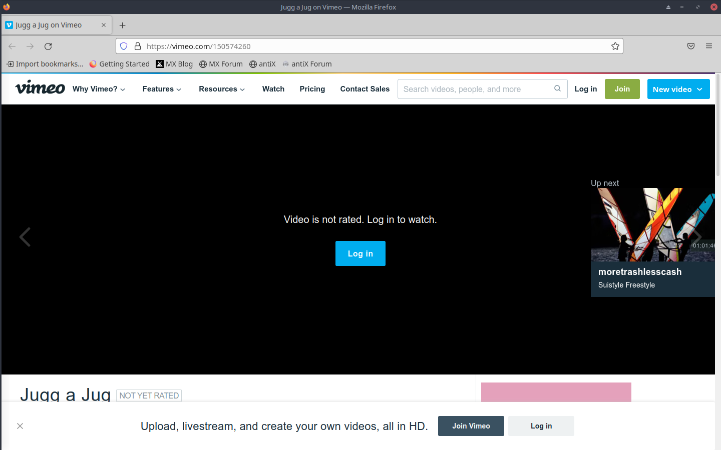

I am trying the script, it works but the video does not start "video not rated" I let it go like this?
I tried to verify this on different machines, even a windows pc. Never got this message. Could you kindly try again manually and describe what you did as close as possible?
greez
chris
10 Mar 2022 10:59 #236829 by seuchato
billykid
could you kindly do
wmctrl -l | grep -i vimeo
in a terminal while running the script?
You should get something like
0x050002ac  0 {pcname} Jugg a Jug on Vimeo - Mozilla Firefox
The "Jugg a Jug" should change as soon as the next video is being played. Kindly also verify this.

10 Mar 2022 11:55 #236835 by tommylight
Vimeo issue, age related most probably.
Just click on next video, although might get that again.
