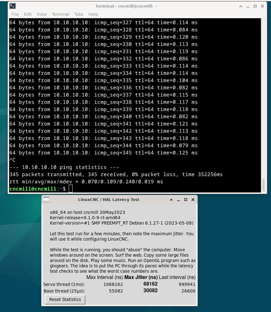

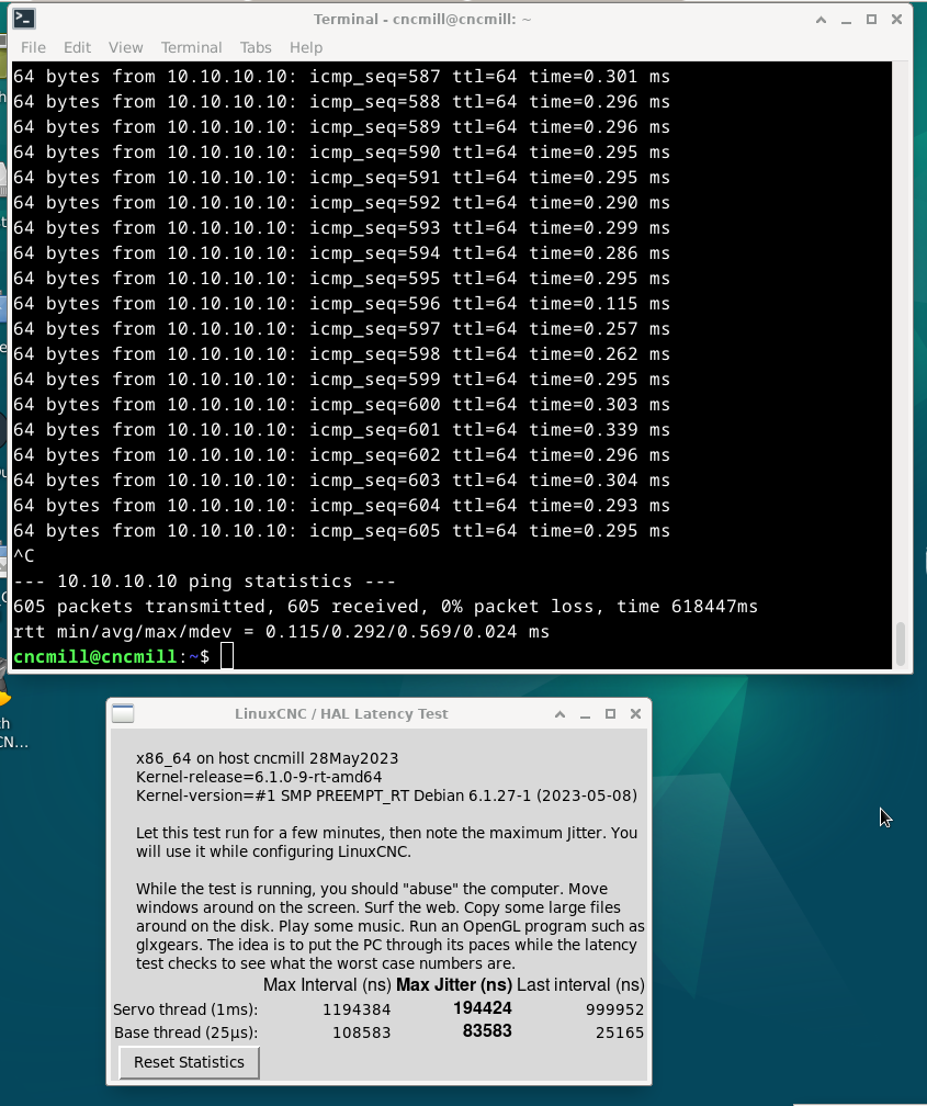

I added a graphics card to see if I could reduce the latency. Here is what I added.
Radeon RX550. From MAXSUN. It's cheap and others have it working on linux just fine so I gave it a go and the results are impressive.
Max Jitter without GPU (onboard GPU only) 194424
Max Jitter with GPU (Radeon RX550) 68162
Ping latency test without GPU (onboard GPU only) min/avg/max/mdev .115/.292/.569/.024 ms
Ping latency test with GPU (Radeon RX550) min/avg/max/mdev .070/.109/.240/.019 ms
I am not using the standard test as i have a few issues with it. Which I am working on and will be reporting on that thread.
This test is the same test for each. I have two windows open both playing YouTube videos while the test is performed. My machine has 12 cores for the CPU I think and none of the cores have been partitioned or dedicated to any particular purpose. It may be possible to get similar results as what I have done here without the GPU just by separating the tasks on the CPU. If some one out there can confirm or deny this it would be great to here your thoughts and experiences. But I think adding the GPU is as easy as it gets. I just put the card in and had to update the addresses in the NANO network settings. That was it. Pictures are attached for your reference.
I have also done this test with just linux cnc running and nothing else and the numbers are even lower. When the machine is fully assembled and working I will do a full 3 axis test to see where it all lands. Having lots of fun and really enjoy this community and my build.

Yes that's a big difference.
The ryzen 5600g is a 6 core with 12 threads. You might have (much) better results with disabling hyperthreading (HT) and isolating a or some cores. If you disable hyperthreading you could start with "isolcpus=5" otherwise "isolcpus=3-5".
Without disabling HT "isolcpus=10,11" or "isolcpus=6-11"
Edit: With AMD HT seems to be called SMT.
