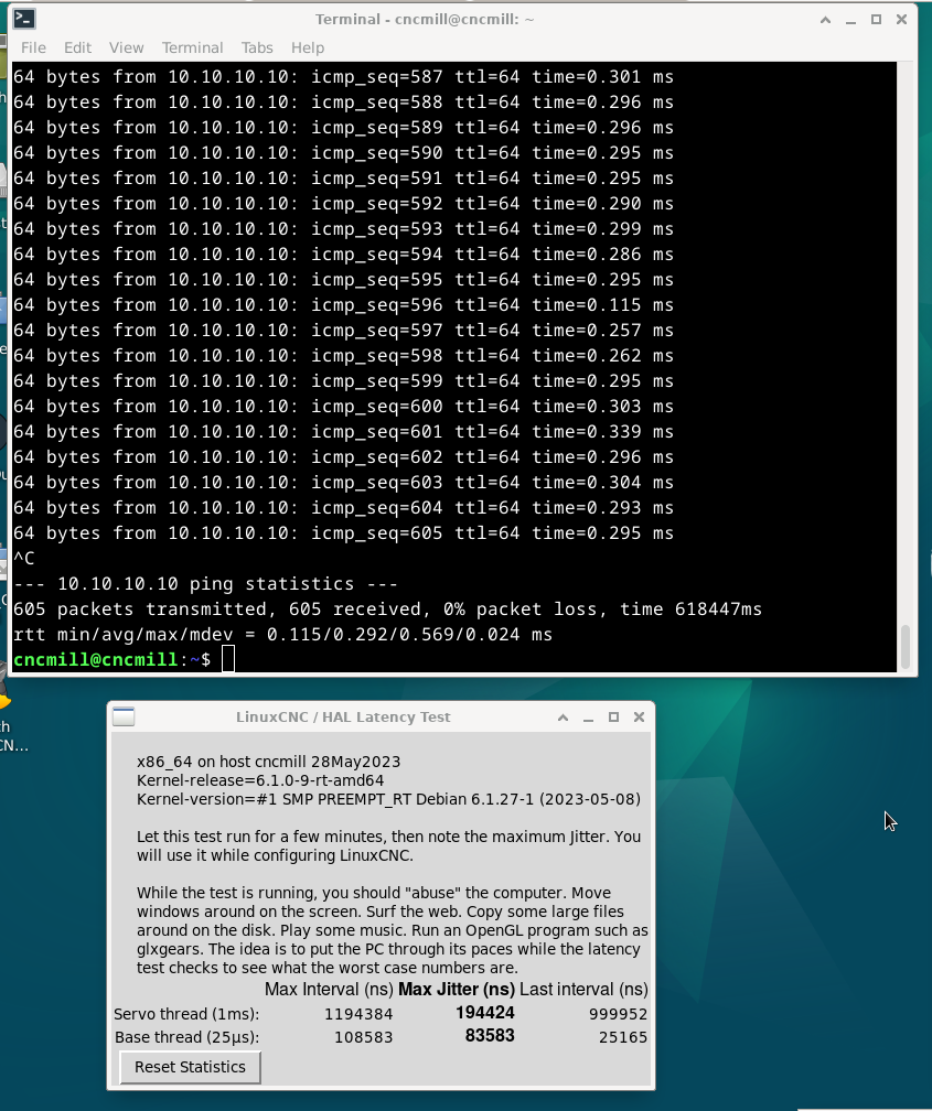

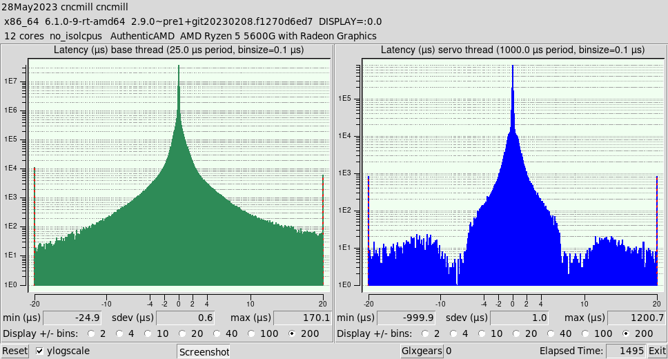

29 May 2023 01:43 #272384 by mattdom142
hello all,
I had a bit of trouble with the automated test and will post my issues in that thread. But i did get some results. here they are. i do not understand them nor do i know what to do with them.
my machine is a HP M01-F3006
I added a network adapter as the built in one dropped tones of packets and was not useable. This is the one I added.
Gigabit CT PCI-E, EXPI9301CTBLK intel based chip that works just fine.
Your thoughts and questions are highly welcome. I will be testing the machine latter this week or next in the cut to se how it dose.
FYI i have 1um glass scales attached to the machine and will be using them for feed back.
I had two windows open running youtube in the background for this test for less then 30mins.

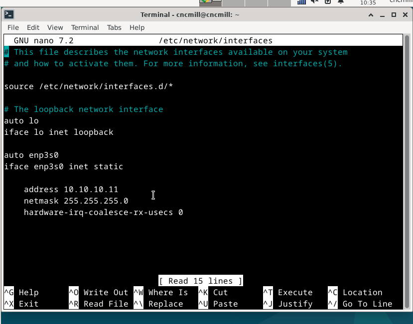

29 May 2023 16:55 #272439 by mattdom142
Thank you @tommylight.
I am having a few issues with getting the latest 6.3 kernel. I run the update and upgrade commands and still have 6.1. Do i need to udgrade the kernel some other way?
And when i use ethtool to try and change the coalescing to 0 it won't accept the command and returns.
ncmill@cncmill:~$ sudo ethtool -C enp3s0 coalesce 0
[sudo] password for cncmill:
ethtool (-C): unknown parameter 'coalesce'
cncmill@cncmill:~$
am i using that tool wrong?
29 May 2023 17:24 - 29 May 2023 17:27 #272440 by PCW
it would be
sudo ethtool -C enp3s0 rx-usecs 0
Not that this will be lost when you reboot.
To make this permanent, you would need to add something like:
       auto enp3s0
       iface enp3s0 inet static
           address 10.10.10.100
           hardware-irq-coalesce-rx-usecs 0
to the network/interfaces file
Last edit: 29 May 2023 17:27 by PCW.
The following user(s) said Thank You: mattdom142
29 May 2023 17:37 #272441 by mattdom142
ok so in the nano network. something like this see picture
29 May 2023 17:43 #272443 by PCW
Yes.
You can verify if it worked with:
sudo ethtool -c enp3s0
29 May 2023 18:42 #272450 by mattdom142

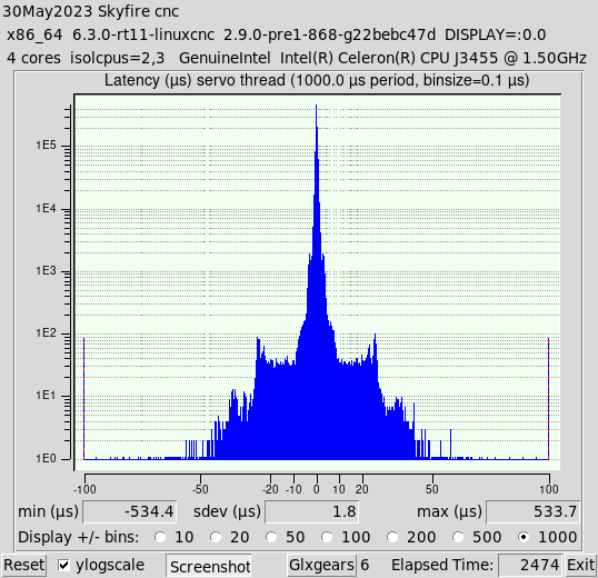

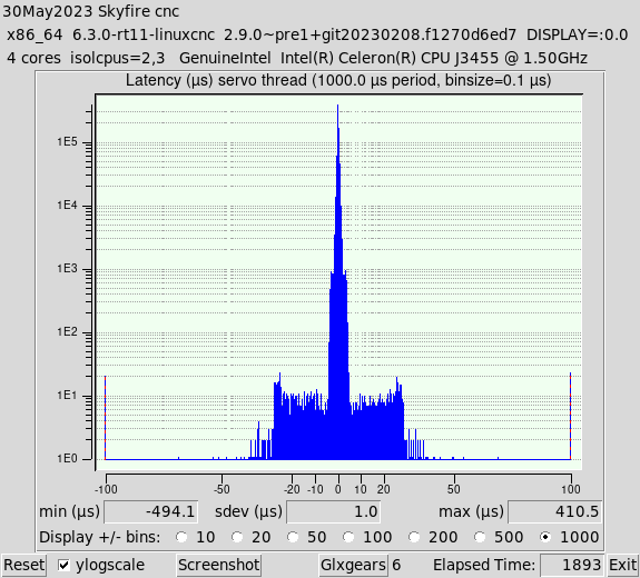

31 May 2023 02:17 #272535 by jhandel
I think the little machine I got for this is not going to fly (even for a Mesa Card install).
Most of the time it runs sub 50k jitter, but just occationally it will jump up to 500 to 900k... the realtime ping test was also very good but would randomly hit a max of 3mx

Latency testing loop started Tue May 30 07:24:59 PM CDT 2023,
should end after Tue May 30 09:24:59 PM CDT 2023
>>>Unexpected realtime delay on task 0 with period 1000000<<<
Useless to proceed, read the relevant part in 1685492681.lat
