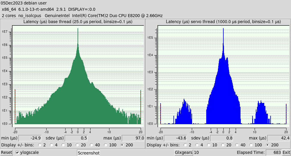

In any case on the same hardware latency is many times more than on 2.8.4.

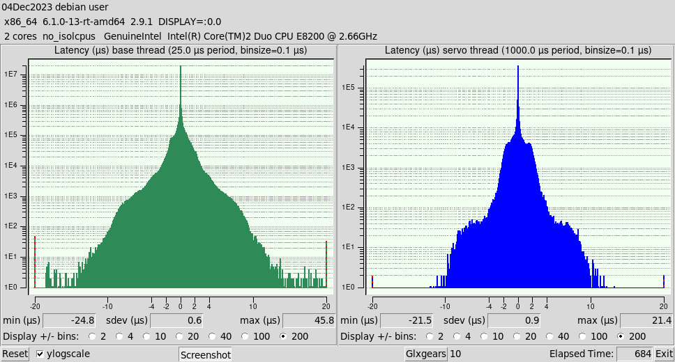

Also tried it on an old desktop, E8200, 2GB of memory (one slot on the board doesn't work for some reason), video Radeon HD5450 512Mb:
And without GPU:
And now I have a dilemma: to use these mini-itx boards with large latency or to put mesa everywhere (but it happens better to use LPT for simple machines). Or look for desktop hardware, but it is not always convenient to place it.

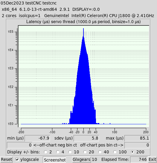

Turbo boost enabled
C states disabled
Command line: idle=poll mitigations=off cpufreq.default_governor=performance
7203 s servo min: -88.800 us max: 92.000 us sdev: 2.600 us
Core 0: +68.0°C (high = +105.0°C, crit = +105.0°C)
