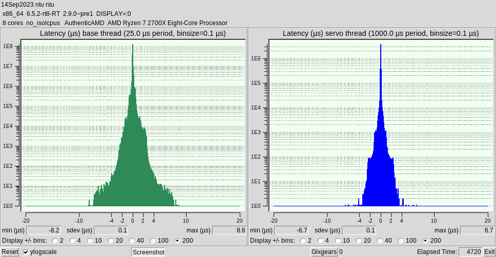

15 Sep 2023 00:23 #280797
by NTULINUX
Replied by NTULINUX on topic Results of latency test, list of computers tested for use with LinuxCNC
The following user(s) said Thank You: seuchato, tommylight

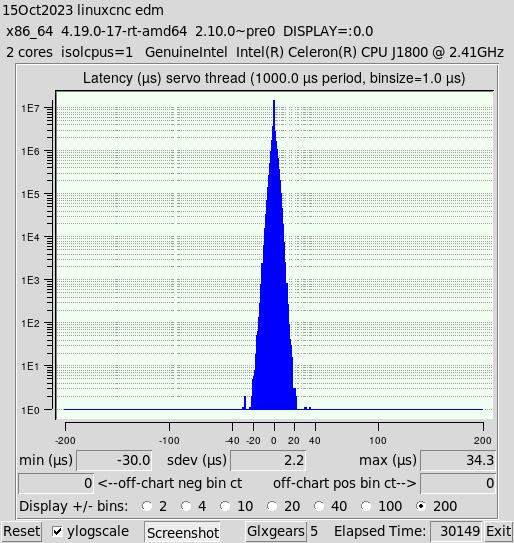

15 Oct 2023 19:55 #283088
by D.L.
Replied by D.L. on topic Results of latency test, list of computers tested for use with LinuxCNC
- Posts: 21958
- Thank you received: 7478
15 Oct 2023 21:51 #283096
Replied by tommylight on topic Results of latency test, list of computers tested for use with LinuxCNC
Looking good !

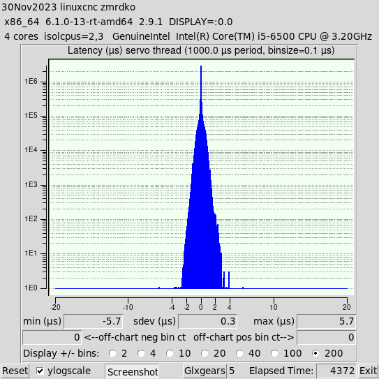

30 Nov 2023 15:05 - 03 Jan 2024 18:47 #286874
by zmrdko
Replied by zmrdko on topic Results of latency test, list of computers tested for use with LinuxCNC
Last edit: 03 Jan 2024 18:47 by zmrdko.

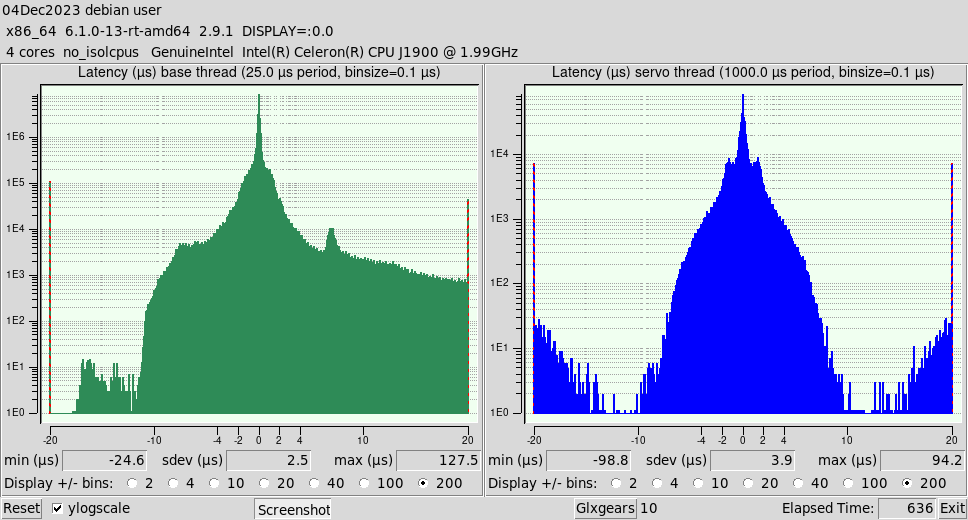

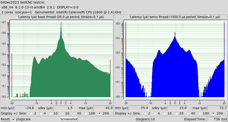

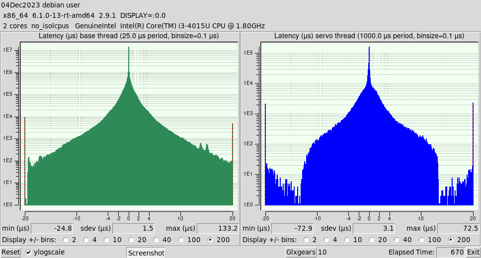

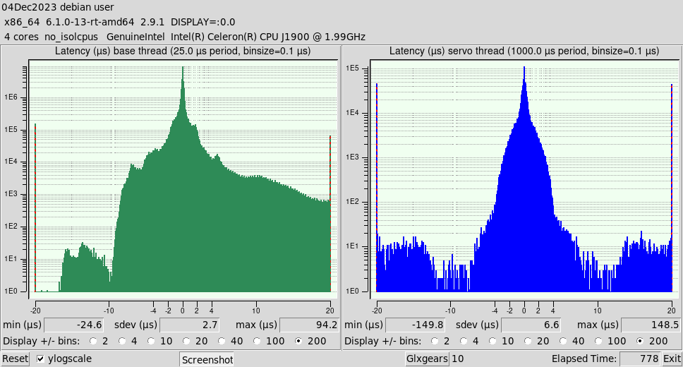

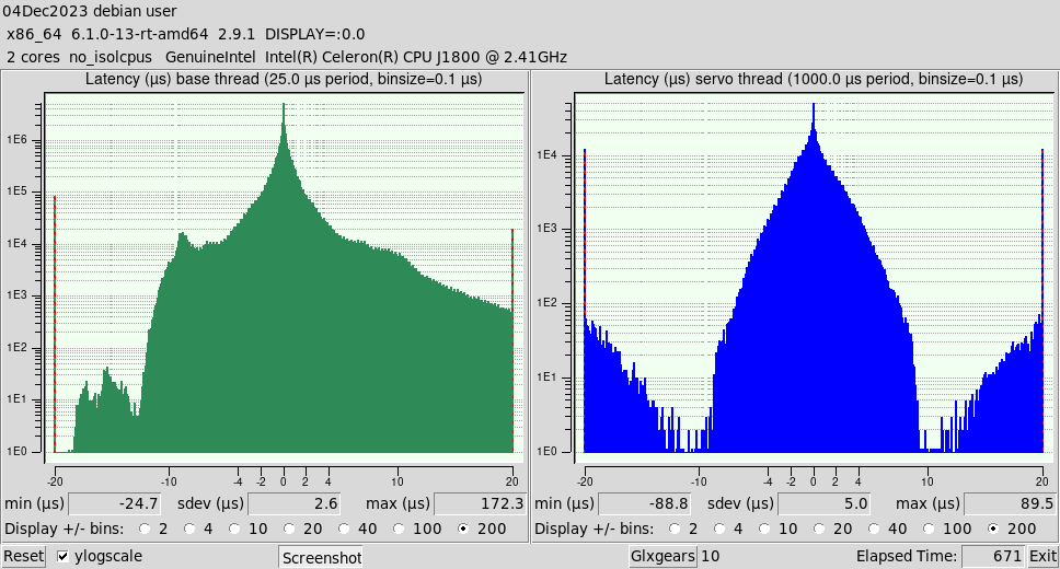

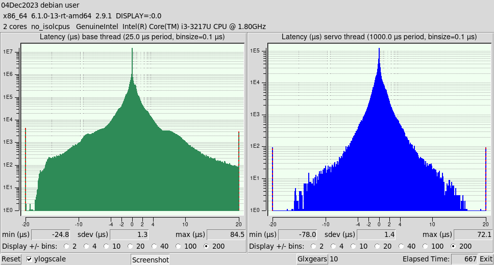

05 Dec 2023 12:32 #287267
by Mr. Mass
Replied by Mr. Mass on topic Results of latency test, list of computers tested for use with LinuxCNC
I have several industrial boards and thin clients and did a quick test on the new 2.9.1 from the download section site. All systems had 4GB of memory each, all power saving features were turned off in the bios.
2 different boards on J1900:
On one of the systems on the J1800 I did 2 tests, one default with a live install from a flash drive, the other with the system installed and kernel parameters isolcpus=1
Not very good values, but I think for mesa all these boards will be enough, but for LPT.....
- Posts: 21958
05 Dec 2023 12:34 #287269
Try without the base thread/period
latency-histogram --nobase --sbinsize 1000 --show
