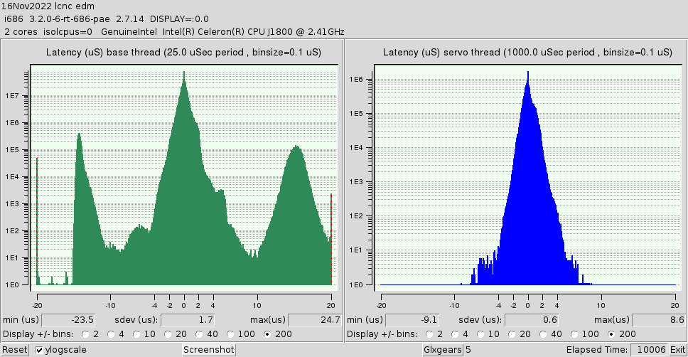

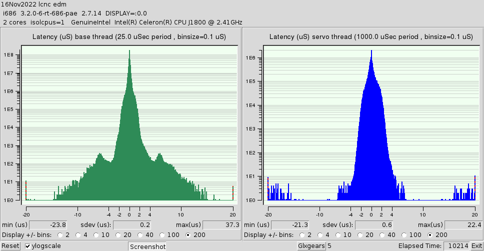

Add
--show
At the end of latency-histogram command, there are spikes outside of visible area on both screenshots.
Those two colored columns at both sides of the plot in red and green or red and blue, those are spikes.

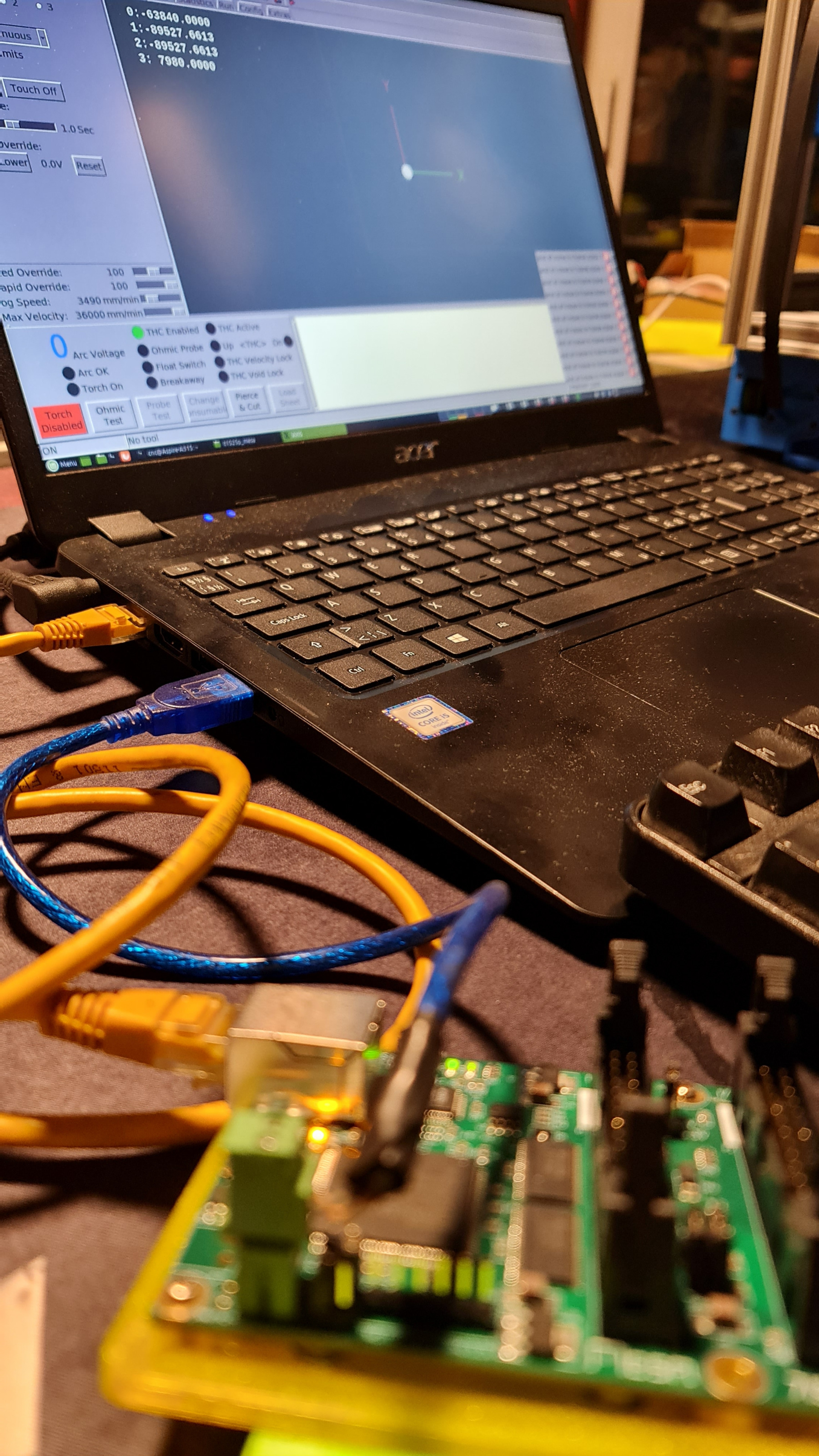

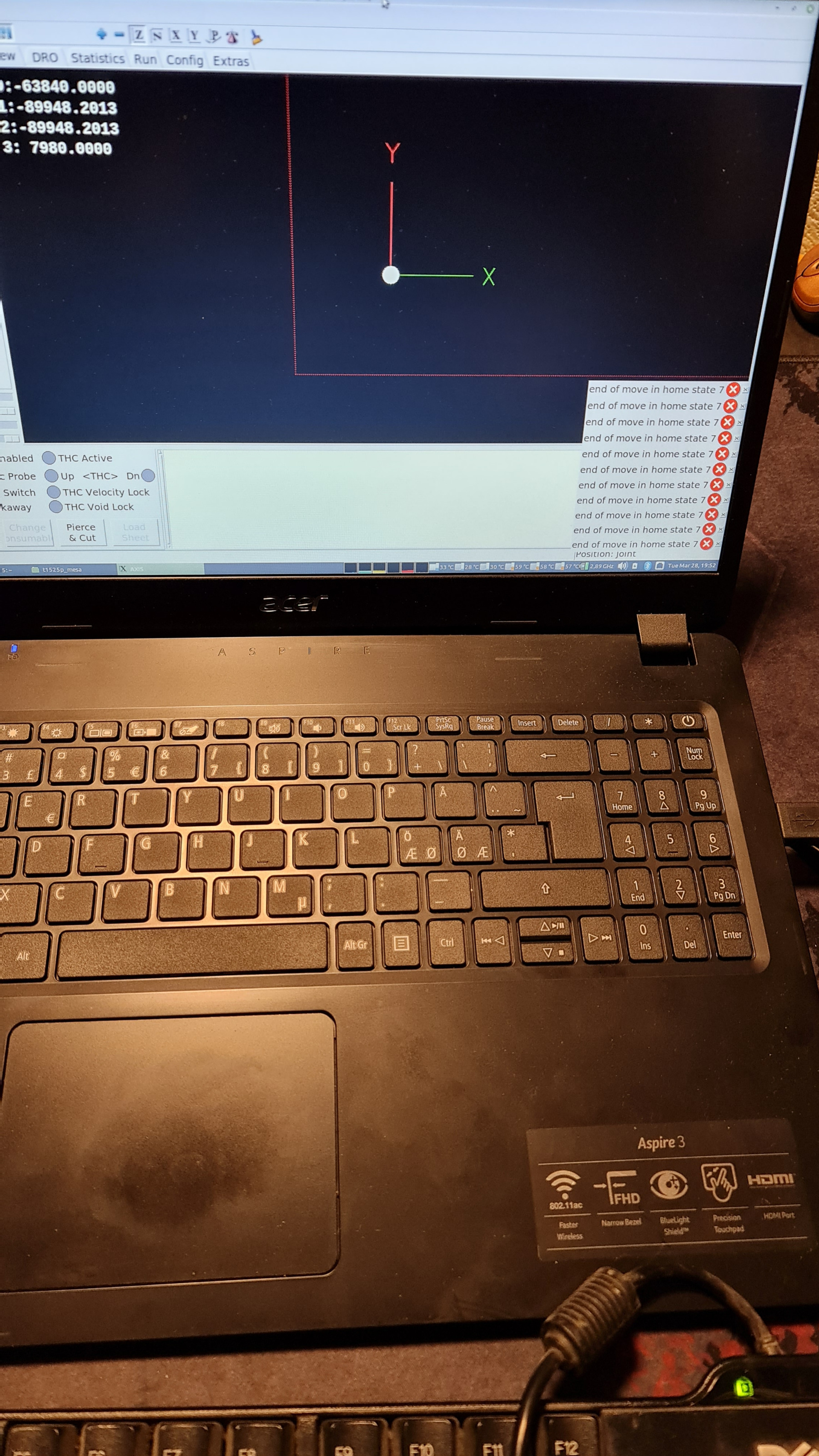

Acer Aspire 3 laptop, works perfectly with LinuxCNC, been on since last night trying to home a machine.
Mint19.3, LinuxCNC 2.8, kernel 4.9.
Removing power adapter does drop the link to Mesa, but works on bateries for nearly 3 hours without issues.
Beware that this model has issues with keyboards, this one does not work at all most of the time. Pity as it is very thin and lite with a nice full HD screen and a very cr@ppy 640x480 camera, good batery life.
Will add more info later.
Also got an Acer Switch 5 tablet PC, using a USB>LAN dongle can run machines very nicely for testing, but if screen blanks it does drop the link on wake up.

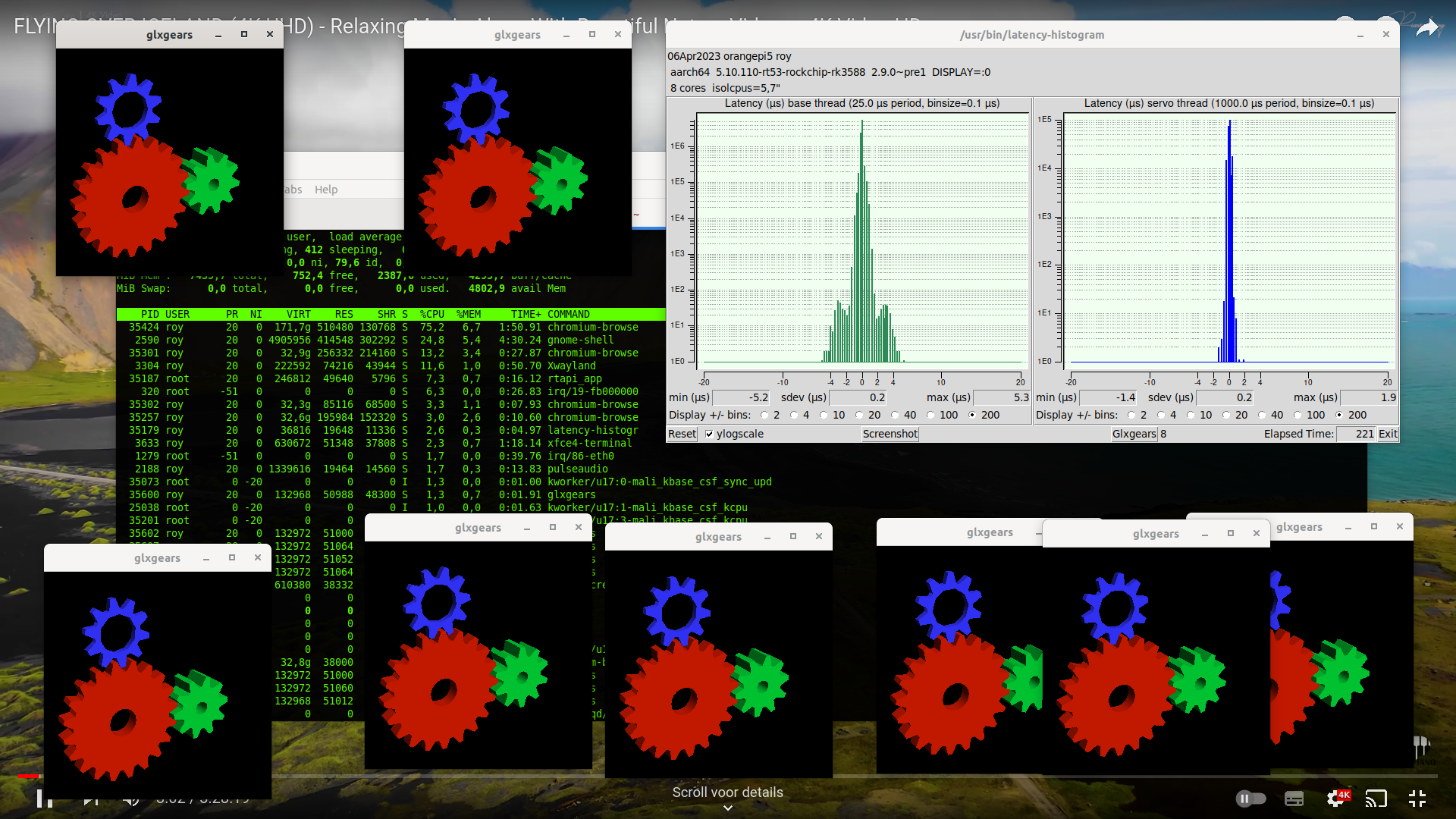

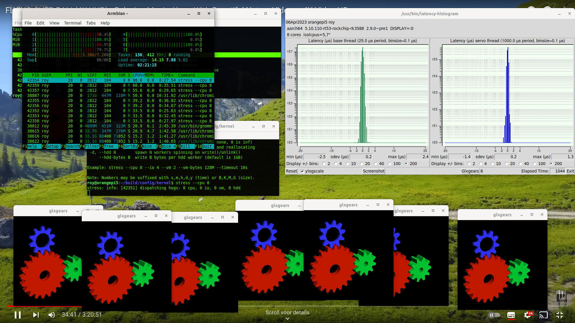

OrangePi-5 with rt-kernel, in another thread you could find how to build this kernel/image.
I did try to make it harder for that board but it improved the latency, perhaps the same kind effect as idle=poll.

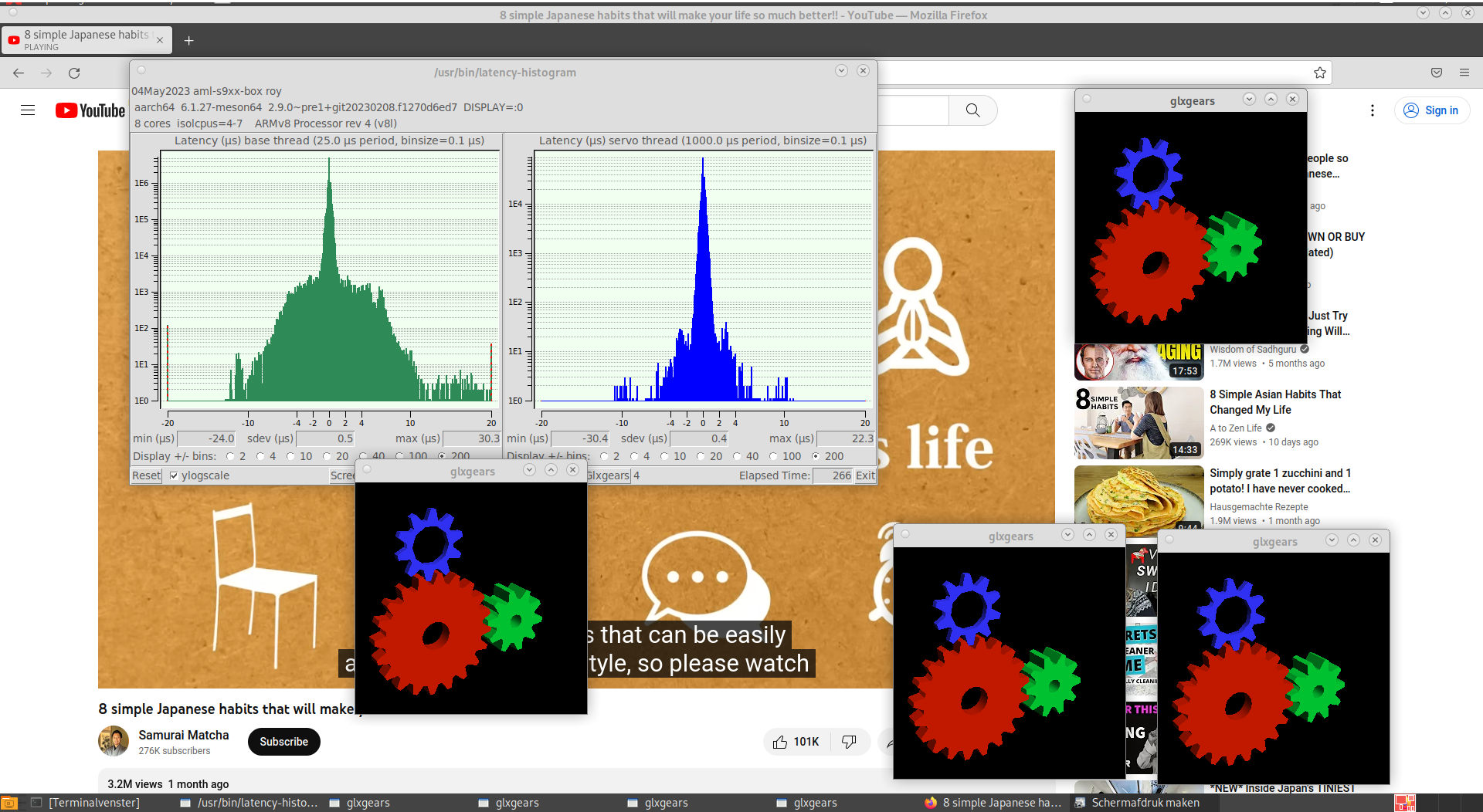

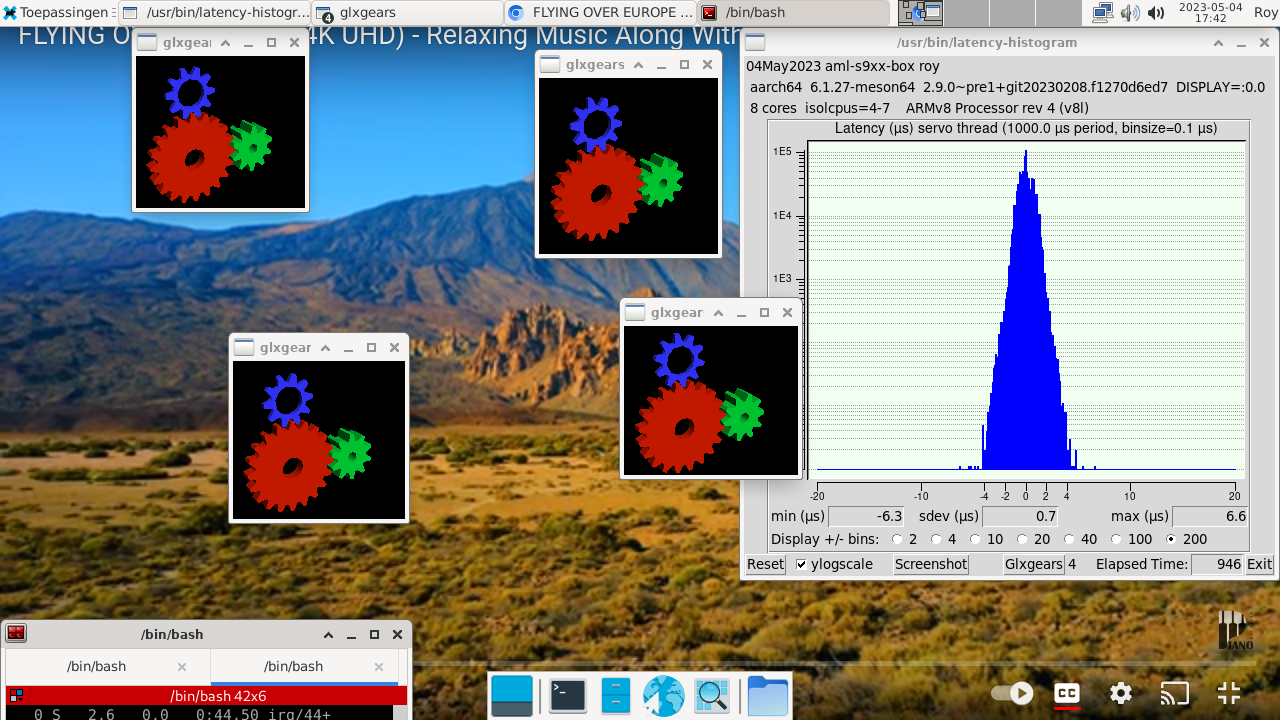

Old tv-box I had lying around, S912-2gb. It could be a bit tricky to install.
The emmc of this box is damaged, to be able to boot from sd I'd to write a different u-boot to the sd. This box froze every time while it was reading/writing from sd with the preempt_rt kernel and some cores isolated. Eventually with the boot partition and u-boot on sd and rootfs on usb it performs fine.
Perhaps it works even better when it's installed to the emmc. The servo thread stayed below 10uS until itdid IO heavy tasks. ran out of ram.
After replacing Mate with xfce and lowering the resolution to prevent it from running out of ram the result is much better.

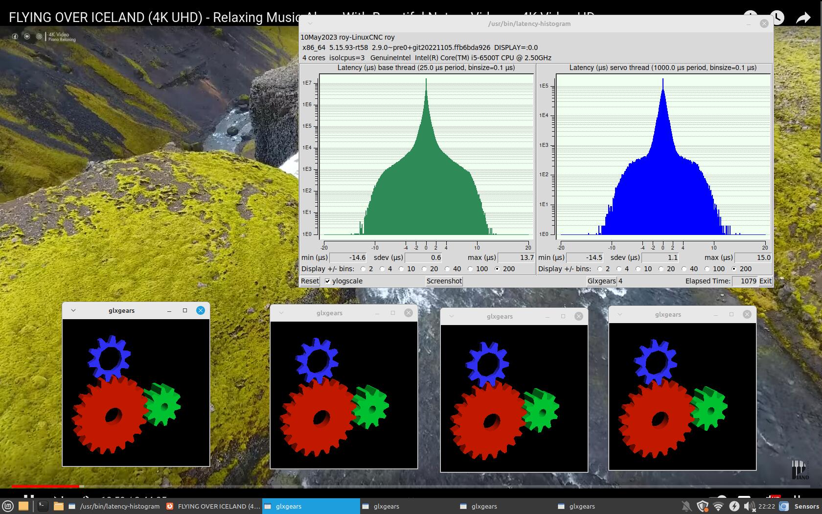

Optiplex 7040 mini i5-6500T + 2x4gb (DDR memory works faster in pairs)
extra boot archs: isolcpus=3 intel_pstate=disable processor.max_cstate=0 idle=poll cpufreq.default_governor=performance i915.enable_dc=0 ahci.mobile_lpm_policy=1 irqaffinity=0 nomodeset quiet
Kernel compiled + config: mega.nz/folder/T9gCUZCQ#aQDlVgPDAMtaRgF_-Vzd5g
