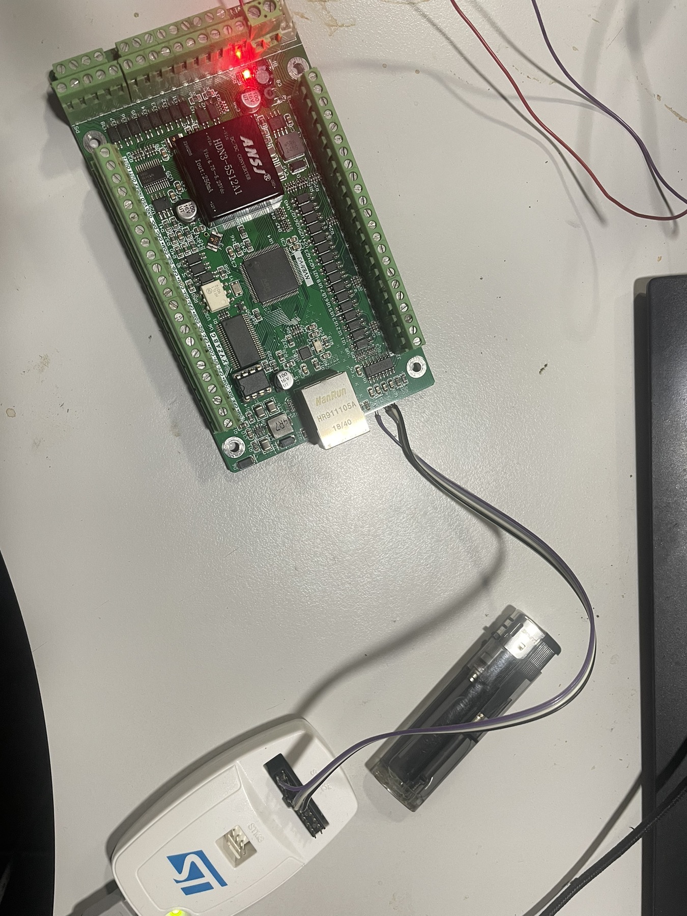

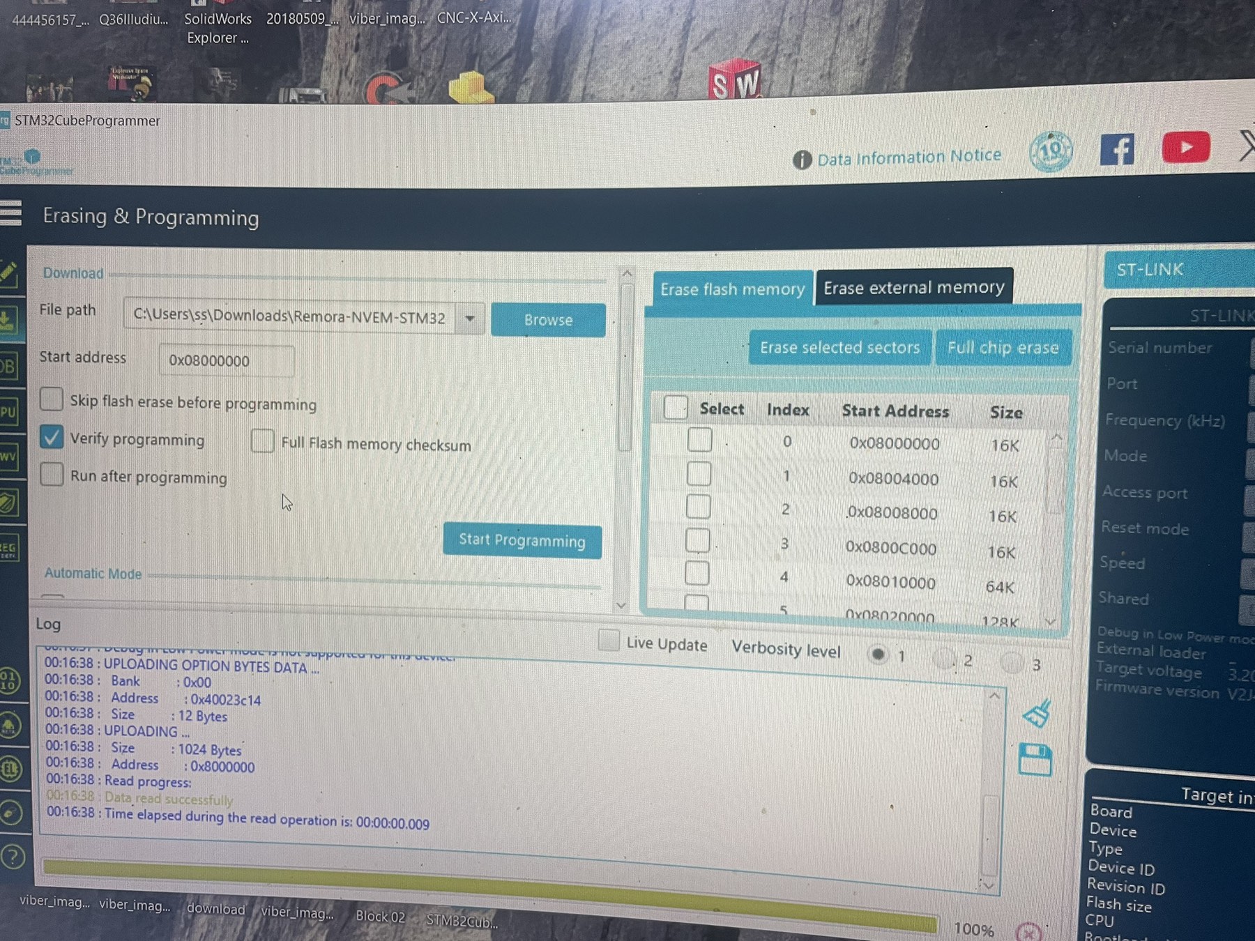

hello, I managed to insert the firmware, I managed to ping my nvemV2 10.10.10.10, i also managed to do halcompile, i also transferred some of the basic configurations... unfortunately, starting linuxcnc via the command line, I get a blank, i.e. I can't start either one of the configurations. do you have any ideas? Thank you

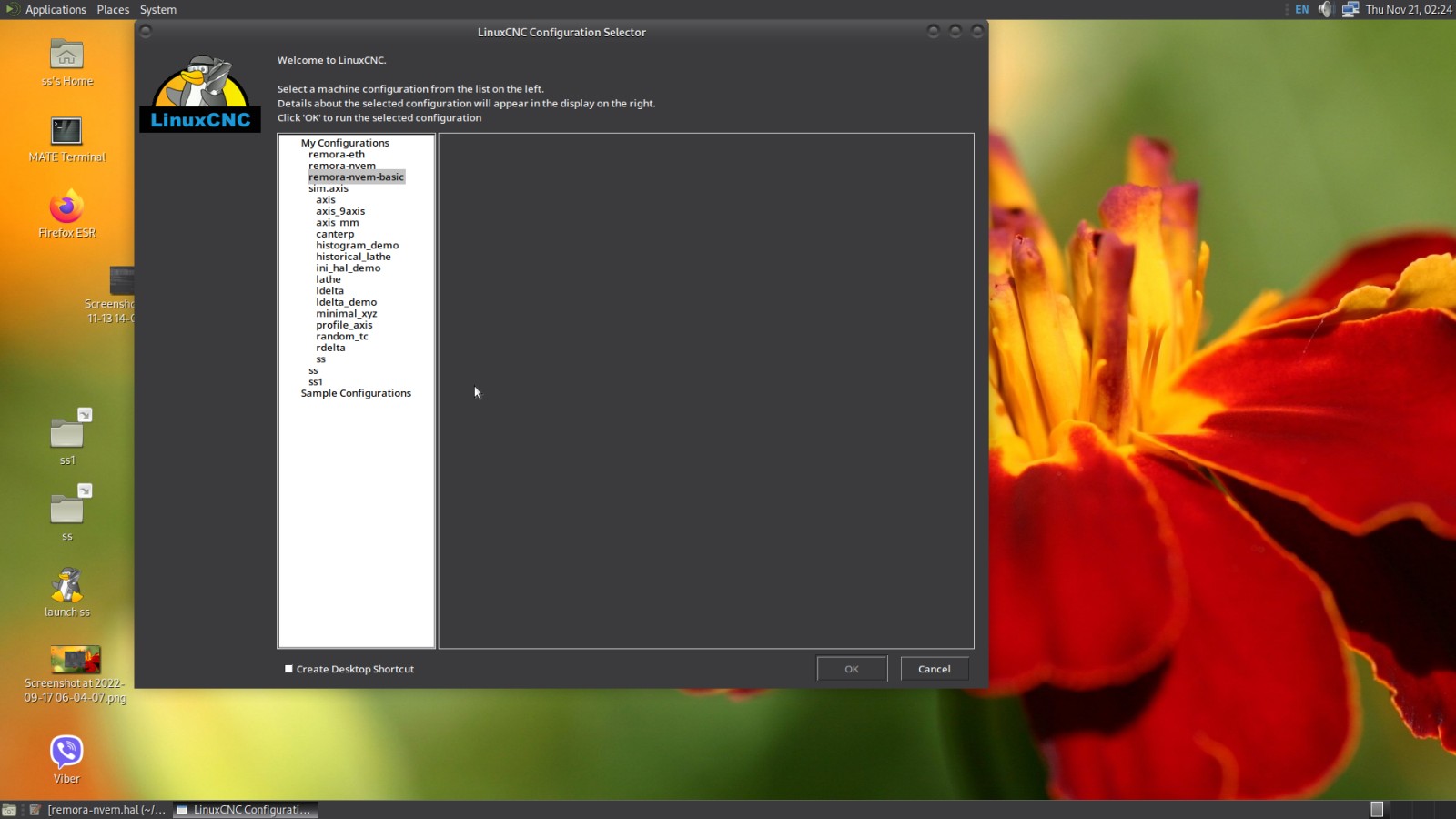

thank you very much Roy, it is not able to start, it reports that it does not find the ini file even though it is there in the config/remora-nvem folder.. I managed to start it by transferring the files from the remora n-vem folder to the sim-config folder. it wants to start..it reports a joint following error, but this is probably because no any motor is physically connected, no is the set scale etc. changed. my question is, does the firmware support 6 axis even though it is factory nvem2-4axis version?

Perhaps a typo or a space in the folder name why it didn't work before, but if it works in this folder it's alright. Yes the firmware supports 6 axis, it can even be set to 8 axis in the firmware and component.
