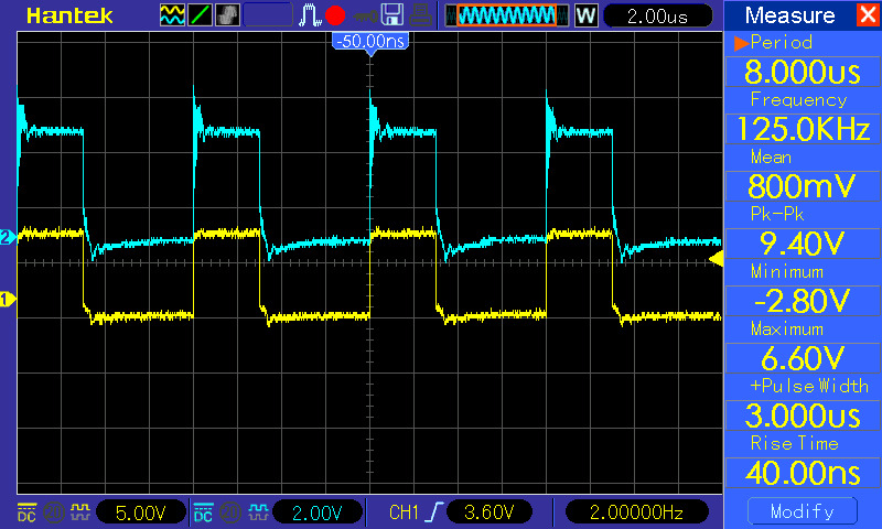

20 Nov 2024 18:15 - 20 Nov 2024 18:20 #314932
by LabOuest
Replied by LabOuest on topic Remora - ethernet NVEM / EC300 / EC500 cnc board
Looking at the oscilloscope I found out that my timing is wrong.
There isn't any Dir Hold or Dir Setup in my signal as is required by my drivers.
(Yellow: Step pin Blue: Dir pin)
Following Scott's post I edited and uploaded my config.txt
Unfortunately, looking at the scope, there still isn't any Dir Hold or Dir Setup in my signal !
I made sure my config was updating properly by changing the timing and looking at the scope, which it does.
I made sure the dir signal was wired correctly to the scope by moving the axis back and forth, which it is.
I reinstalled remora ethernet component by downloading the repo and doing sudo halcompile --install remora-eth-3.0.c inside Remora-RT1052-cpp-main/LinuxCNC/components/Remora-eth/
Is there a bug, did I overlook something ?
Last edit: 20 Nov 2024 18:20 by LabOuest.
- scotta
- Posts: 959
- Thank you received: 489
20 Nov 2024 19:40 #314935
by scotta
Are you sure the blue trace is the Dir pin. It should only change from high to low on a direction change. I doubt you are changing direction every step pulse.
The LinuxCNC component does not control the setup and hold times. This is done in the firmware.
- LabOuest
- Posts: 11
20 Nov 2024 20:02 - 20 Nov 2024 20:12 #314937
by LabOuest
Yeah, that's what I though, the direction signal going to 0 at every step is dubious at best. Especially looking at your older posts which clearly show a logic analyser graph with the expected step dir behavior.
I made a short video so we can all better understand what's happening, would you mind taking a look ?
(Keep in mind, these are differential signal, the dir pulse is not going in the other direction between step pulse, it's just going to the mid point, 0v)
Last edit: 20 Nov 2024 20:12 by LabOuest.
