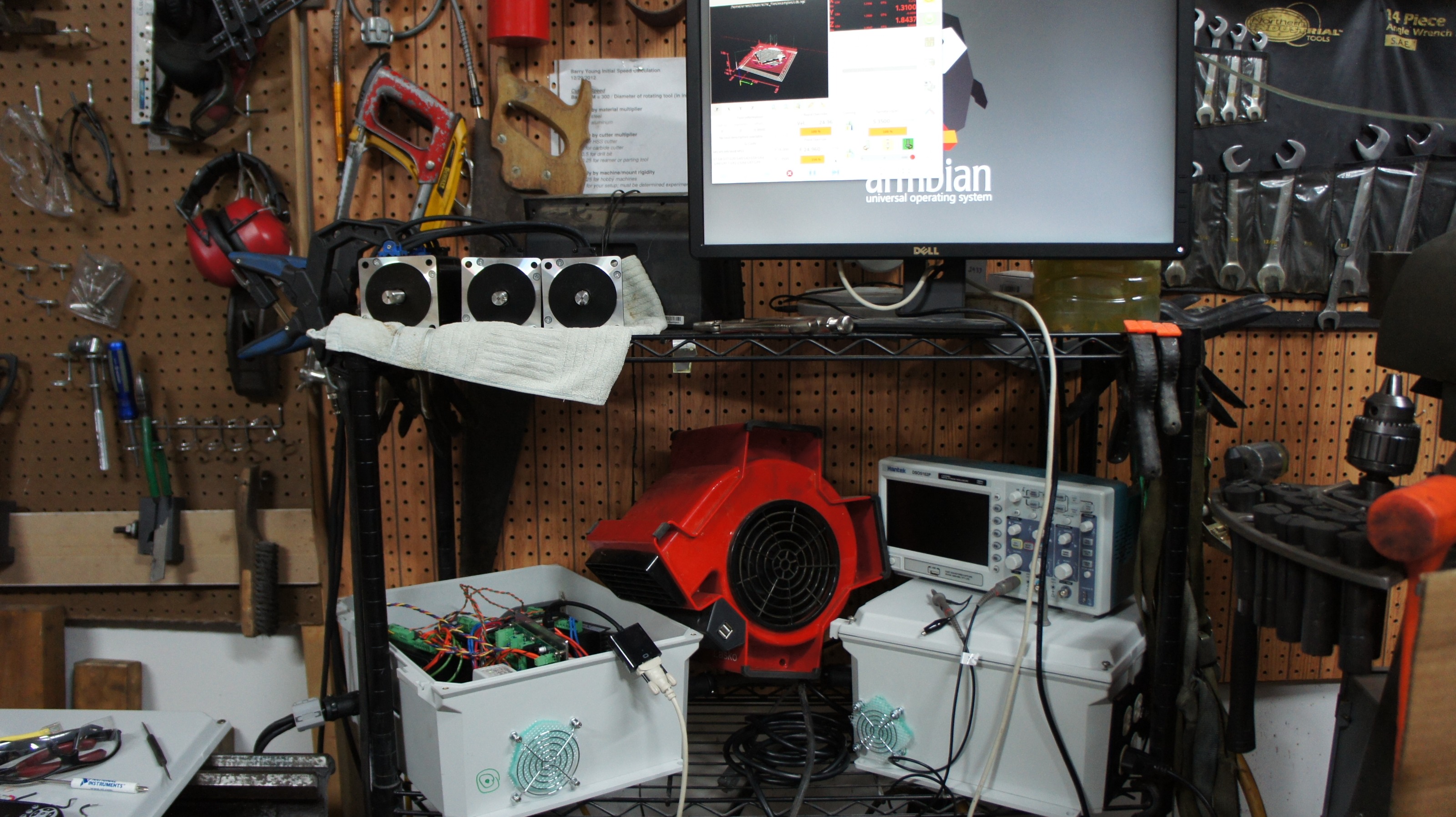

21 Jun 2023 00:03 #273972
by echristley
Picture of the setup. Motors on top, beside the monitor. White box on the right with the scope sitting on it is the power box. Fan is blowing directly on the OPi5.
I moved the servo period to 10000000, and the P factor to 1000. Opened up Gmoccapy and loaded the "cds" example file. Before it got the bit into position to do the first cut, it failed to read.
Shifted to 1500000 (how ever many zeros that is supposed to be). Ran the same example file, and got maybe halfway through.
Replied by echristley on topic Can the OPI5 be Configured to Run LCNC?
