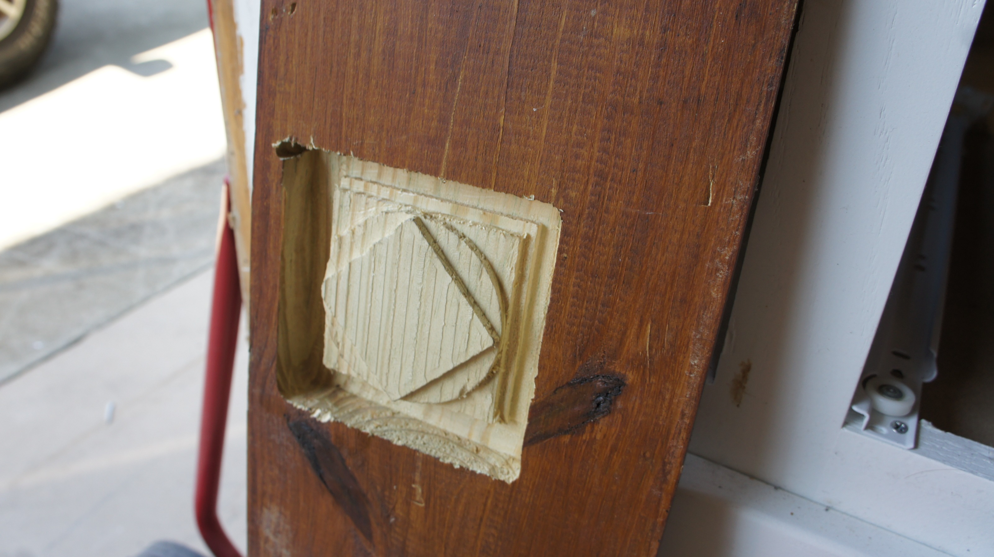

20 Aug 2023 20:50 #278570
by echristley
Replied by echristley on topic Can the OPI5 be Configured to Run LCNC?
The following user(s) said Thank You: tommylight, royka
