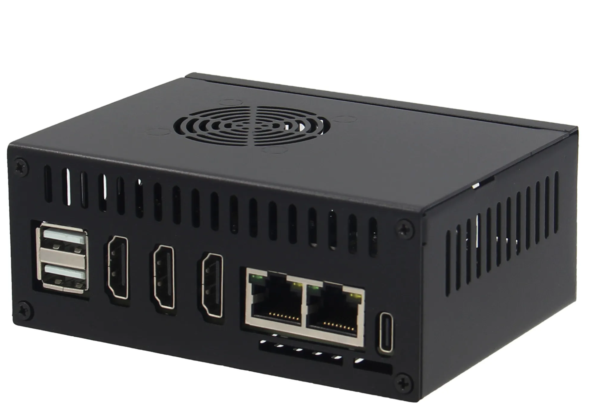

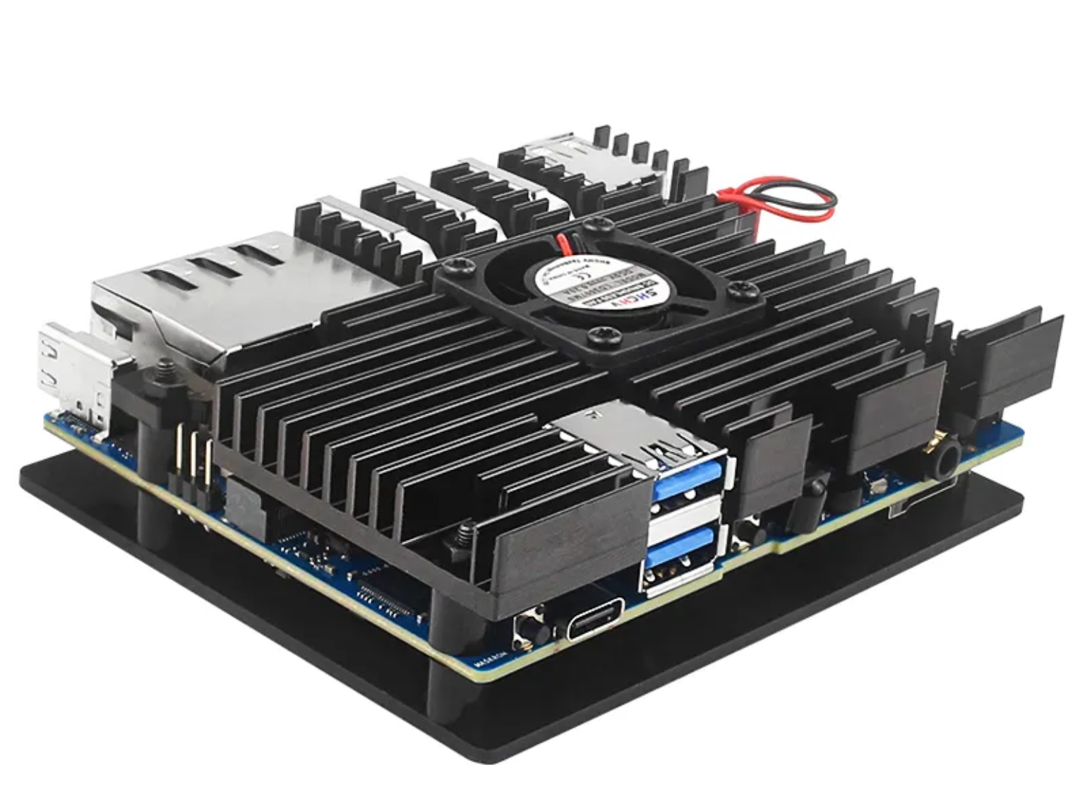

Currently there are 2 metal cases for the OPi5+
There is this one from geekworm which has internal heatsink and 5v fan, the heat sink is only for the cpu chip and not the ram.
www.aliexpress.com/item/1005005698413948.html
There is also this one, no clue who makes it but it is available from a few stores on aliexpress. This one also has a fan but the case is the heatsink with a cover plate for the bottom. It looks like the heatsink contacts 4 chips instead of just the cpu. This doesn't provide as much protection as the first one but is probably better for anyone who plans to embed their SBC in their CNC controller box like me.
www.aliexpress.com/item/1005005731835349.html
