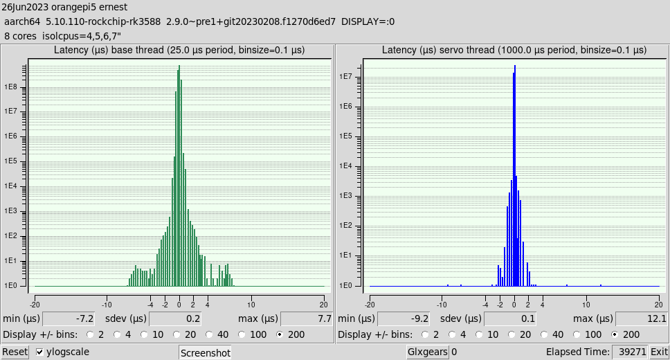

I had to bring the Control Box back in for some rework anyway, so I put it back to the latency test for an overnight run. isolcpus=4,5,6,7 and "f0" in the smp_affinity. Six glxgears, and a browser playing YouTube videos. Left it running all night and all day.
The previous large outliers are gone, so I think I can safely rely on 15us for latency, with the correct IRQ correction command in rc.local
Also, even with all the large cores dedicated to the rt threads, the UI was still plenty responsive.
Also again, @royka 4,5,6,7 worked much better than 2,4,5,6
Replied by echristley on topic Can the OPI5 be Configured to Run LCNC?

I added the affinity commands to /etc/rc.local, but they aren't getting picked up.

Fixed it.
Put "sleep 10" on a line before the echo commands. It appears that /proc hasn't been created by the time rc.local gets run. sleeping for 10 seconds gives it time, and I can't log in that fast anyhow.
