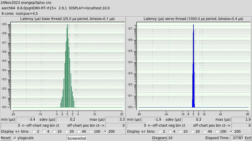

24 Nov 2023 22:10 #286432
by jsg001
I wanted to add another data point for the community. This is....
() orangepi 5 plus (not using hdmi, but rather remote with 'ssh -X'. I've not see that make much difference from being on the head)
() kernel: github.com/Joshua-Riek/linux.git branch v6.6-rk3588-hdmi with patch-6.6-rt15.patch
() linuxcnc from raspberrypi iso
() cmdline: idle=poll isolcpus=4,5
() latency-histogram --sbinsize 400 --show (with 10 glxgear and misc other commands being run)
() rtapi_app:T#[01] assigned to cpus 4 and 5, respectively (manual reassignment of threads for testing)
>> ps -T -eo pid,tid,class,rtprio,ni,pri,psr,pcpu,stat,wchan:14,comm | grep rtapi
1614 1614 TS - 0 19 6 8.4 SLsl - rtapi_app
1614 1615 TS - 0 19 7 0.1 SLsl - rtapi_app:mesg
1614 1616 FF 98 - 138 4 8.1 SLsl - rtapi_app:T#0
1614 1617 FF 97 - 137 5 0.2 SLsl - rtapi_app:T#1
>> sudo taskset -cp 4 1616
>> sudo taskset -cp 5 1617
cpus 4-7 appear to be the faster A76 cores; there seems to be a noticeable speed improvement over cores 0-3.

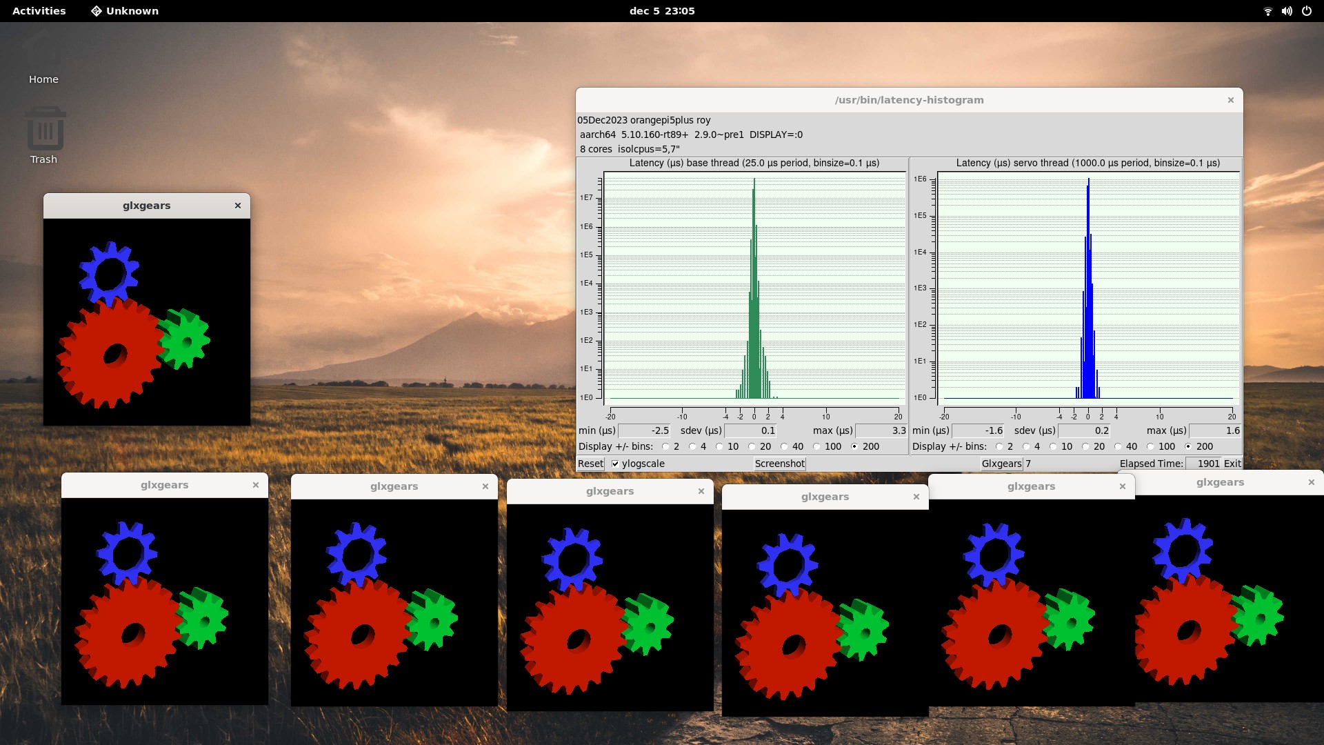

05 Dec 2023 22:33 #287319
by royka
Replied by royka on topic Can the OPI5 be Configured to Run LCNC?
This is the result with the 5.10.160 rt-kernel of Orange Pi. I was able to compile it with the config in the attachment. Afterwards you'll need to copy the compiled DTB manually to /boot/dtb/rockchip otherwise it won't boot.
