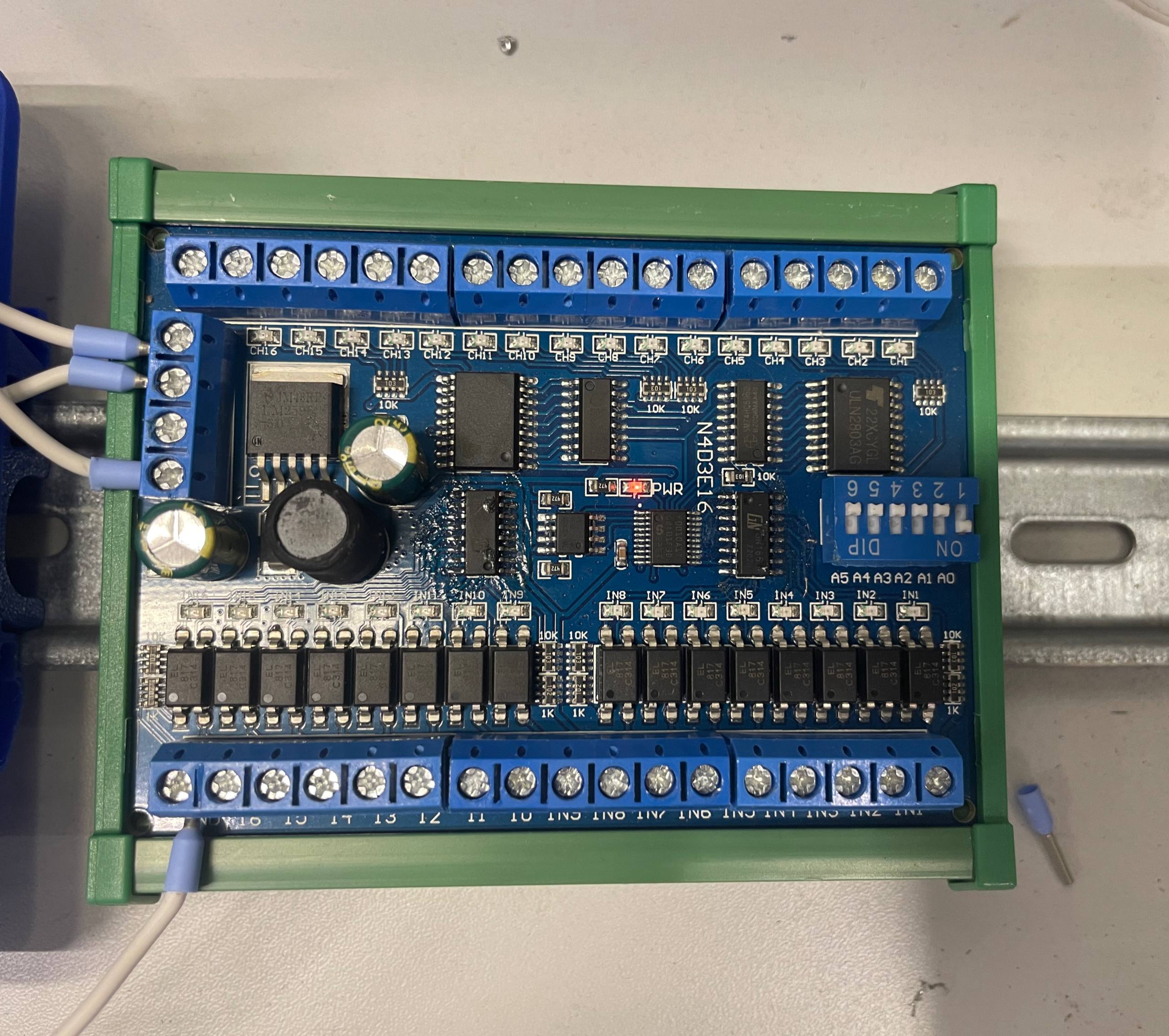

- Oxbown
- Posts: 10
28 Aug 2026 12:44 - 28 Aug 2026 12:50 #349076
by Oxbown
Replied by Oxbown on topic LinuxCNC-RIO - RealtimeIO for LinuxCNC based on FPGA (ICE40 / ECP5)
Hi,I am currently configuring a Modbus RTU I/O expansion board with RioCore / RioFlow, and I ran into two issues:1. Unable to read digital inputs (N4D3E16 board)
- Board model: N4D3E16 (16 Digital Inputs / 16 Digital Outputs over RS485 Modbus RTU).
- Current status: Controlling all 16 digital outputs works without any issues. However, I am unable to read the status of the 16 digital inputs.
- I am following the register addressing and function codes described in the board's documentation (which I have attached). Could you check if there is an issue with how RioCore handles the Modbus function code (e.g., FC02 vs FC03 / register offset) for this mapping?
2. RioFlow device renaming bug in LinuxCNC- When I assign a custom name to the devices in the RioFlow interface, LinuxCNC throws an error on startup and fails to load.
- If I leave the device names blank (default), LinuxCNC starts and runs properly.
Last edit: 28 Aug 2026 12:50 by Oxbown.
