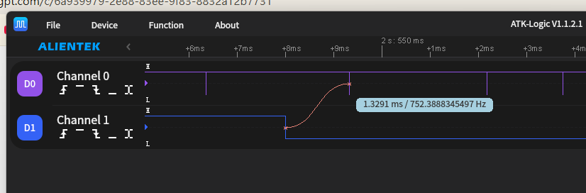

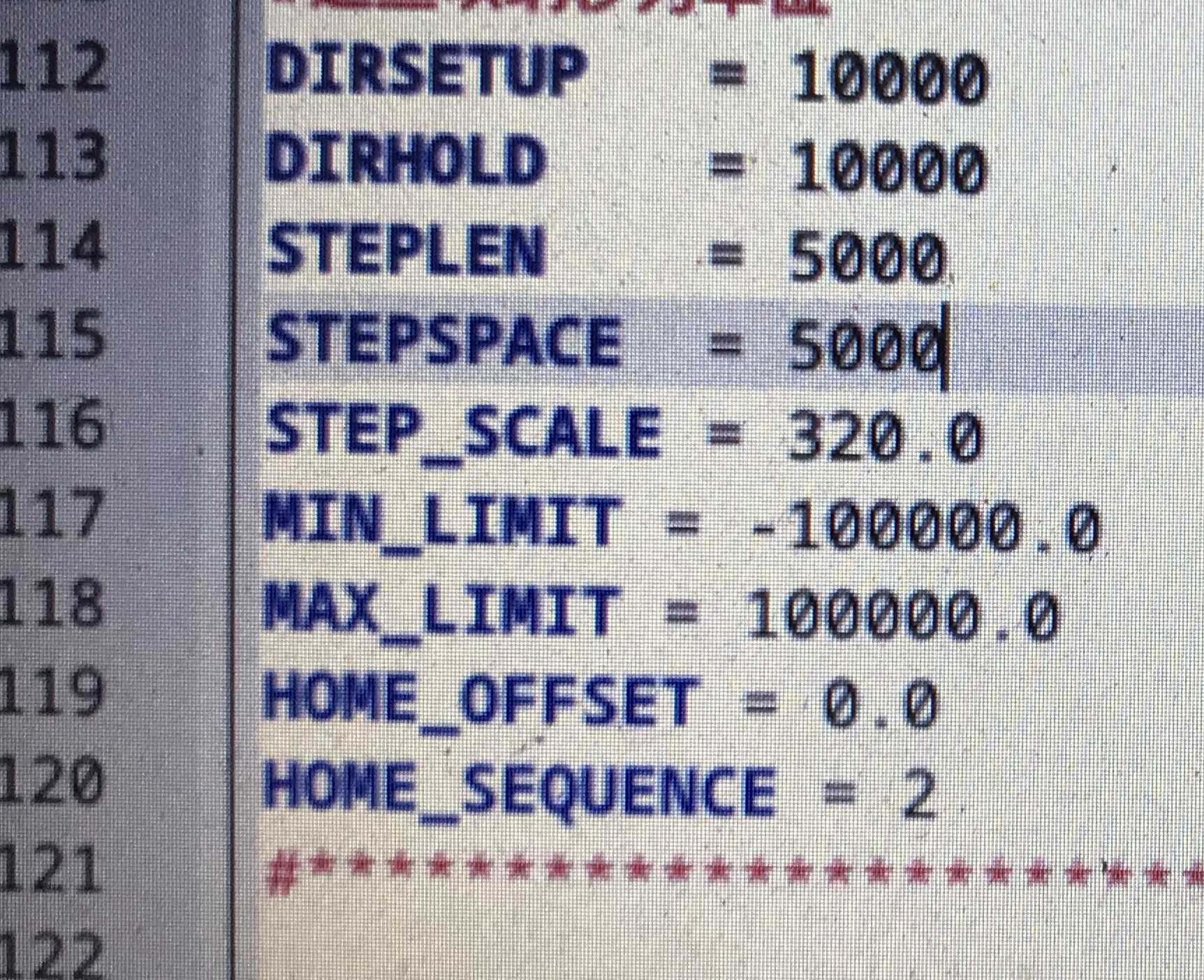

30 Aug 2026 03:19 - 30 Aug 2026 03:22 #349135 by viewsat
When I use pncconf to configure the MESA7i92 card, I set the dirhold to 10us, but the actual measurement is about 1ms. It automatically increases the value when executing linuxcnc. This is why I previously mentioned it works correctly on the dm542 (dir use pc817).
mesa7i92 step/dir

30 Aug 2026 17:12 #349144 by PCW
The Hostmot2 Stepgen/LinuxCNC does not increase the time between steps. What you are seeing is that
the actual direction change may be some distance from the step pulse  time because
the actual step direction logic depends on the sign of the velocity command and at slow speeds
this velocity change may occur at a time determined by the _fractional_ position count. The hostmot2 stepgen
hardware position is a 16.16 bit number so has a resolution of 1/65536th of an external step.
The setup and hold timings set the minimum timings, but not the maximums.
