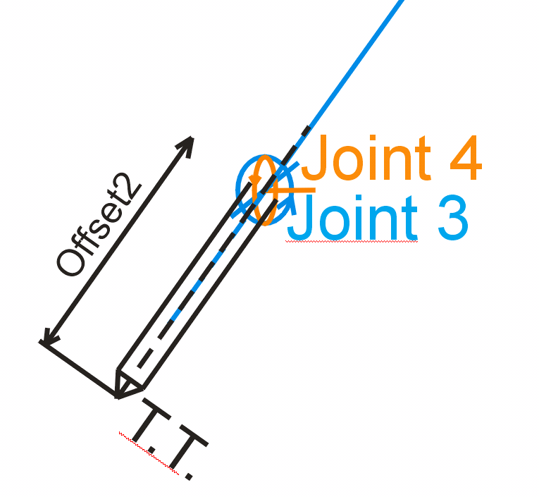

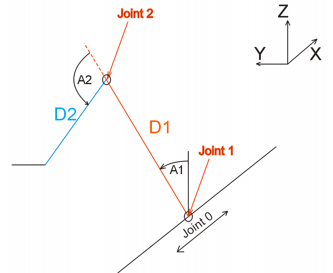

15 May 2017 10:46 - 15 May 2017 10:56 #93214
by Boogie
Replied by Boogie on topic Kinematics... again:/
there are still many mysteries. Some are solved some still waiting to be solved. To understand how this kinematics work i drew some sketches.
First joints (joint 0, joint 1 and joint 2) are easy and well described for me as well as arm lenght D1 and elbow lenght D2. Joint 1 angle (A1) is easy too. Angle 0 means arm D1 is pointing upward as cartesian Z axis. Joint 2 angle (A2) is bit tricky to draw because it is described as:
joint[2] = Outer arm rotates around a horizontal axis at its inner end
which is attached to the outer end of the inner arm. A
value of zero means the outer arm is parallel to the
inner arm (and extending outward).
but later in C code a2 is denoted as a sum of a1 and a2.
D2 is self explainatory.

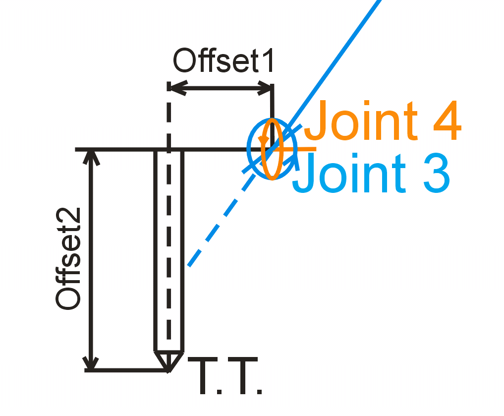

And now the harder part:
joint[3] = End effector rotates around horizontal axis, that is
parallel to previous rotation axis and also X axis.
A value of zero means that the tooltip (if offset from the axis)
is pointing in the same direction as the centerline of the outer arm.
Is centerline of the outer arm (elbow) correctly drawn in blue dashed line? what does it mean: "if offset from the axis"? in what direction? How to draw it? Is it Offset1 in my drawing below?
closer view:
Above: joint 3 in blue reloves aroud axis parallel to cartesian X axis. Joint 4 in orange revoles aroud axis parallel to cartesian Y axis.
Does above tekst mean the situation in the drawing below:
In fact Offset2 is D3 in robokins.c, right?
What if i use i.e. milling router instead of welding head. I will need change tool offsets (D3 parameters) for different bits. Is kinematics we are talking about here ready for it. D3 is fixed in INI file. Can it be changed 'on the fly' when tool change in G-code is needed?
What about Offset1 in my drawings? Is this distance matter assuming tha angle of joint3 always set the tool perpendicular to Y axis?
