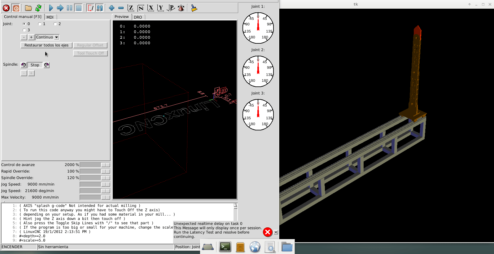

Replied by andypugh on topic Kinematics... again:/
I don't think the Y axis is wrong, as such. If you look at the Axis preview it is showing the tool cone _under_ the engraving.
It is as if the A axis is at 180 degrees, but it isn't.

Replied by Todd Zuercher on topic Kinematics... again:/
Are you sure it isn't your X axis that is backwards?

21 Dec 2018 10:51 #122683
by thang
If you set this, your robot can only use 1 config.
In your inverse kinematic, you used q1 = acos(cc), exactly there is one more solution that q1 = - acos(cc) ( most of time i use atan2 to caculate inverse kinematic). So we need to know which solution we should use, there is a method that is detect current config ( pumakins is using this).
So in your forward kinematic, we can find current robot config by something like:
cc = (rsq - D1*D1 - D2*D2) / (2*D1*D2);
p1 = acos(cc);
if ( abs(p1 - joint[1]) < 0.0000001)
*ifflag = 1;
In inverse kinematic :
if (!*iflags)
q1 = - q1;
When kinematic is already ok,we better leave it. I think you can invert Y axis in 3D file.
It happened to me too but i dont know how to change offset of it
, This might happen because how we put coordinate on robot, that will make Axis A diverse default ( like follow clockwise is increase A)
Replied by thang on topic Kinematics... again:/
Hi Thang,
thank you very much for the help, modified the flag "if (* iflags)
q1 = q1; // q1 = -q1 "I'm learning little by little .. I attach the modified file and the screenshot to see the result, now I have to invert the Y axis, where would it be better to do this? in the cinematic model?, thanks Chimeno

21 Dec 2018 10:56 #122684
I suspect it comes down to a joint axis being reversed. You need to keep your right-hand rule for axis vectors in mind.
Also: I think that "elbow up" will always be the required solution for this robot.

21 Dec 2018 19:54 #122719
by chimeno
Replied by chimeno on topic Kinematics... again:/
Hello Andy,
If I think I have an inverted joint as you say, I will try to reassemble everything again following the rule of the right hand.
hi Todd Zuercher,
If possible, I will look at it with more details if I have not followed the rule of the right hand well.
Hello Thang,
Well that was an easy solution to see how he behaved, I will look at what you have explained to me and I can apply it, I am not an expert on this topic but I am going to try it !.
thanks for everything guys, great guys!
Chimeno

04 Jan 2019 20:25 #123502
by chimeno
p1 = acos(cc);
*ifflag = 1;
if (!*iflags)
q1 = - q1;
Hi Thang,
I attach the modified file with your instructions, at the end it has the same elbow effect above, thanks
Chimeno
