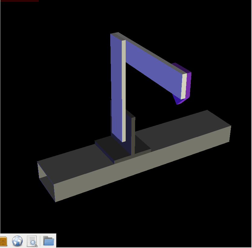

Hello Andy,
I read vismach several times in linuxcnc and wiki but I can not understand, I do not know how to change the center of rotation,
this is what I do,
1-move piece to the location
link3 = Translate ([link3], 60, -150, 70)
2-nest the piece and connect it to the HAL
link3 = HalRotate ([link3], c, "joint1", 1, 1,0, 0)
In the end I found the solution, I think something started to understand, I will continue ...
link3 = Translate ([link3], 30, -50,-50)
link3 = Translate ([link3], 30, -100,120)
Thanks for the help
Chimeno

Replied by andypugh on topic Kinematics... again:/
You need to move the part so that the origin as at the rotation axis, then do the halrotate, then move it to the final position.
Halrotate "inserts" an axis in the part at the coordinate origin.

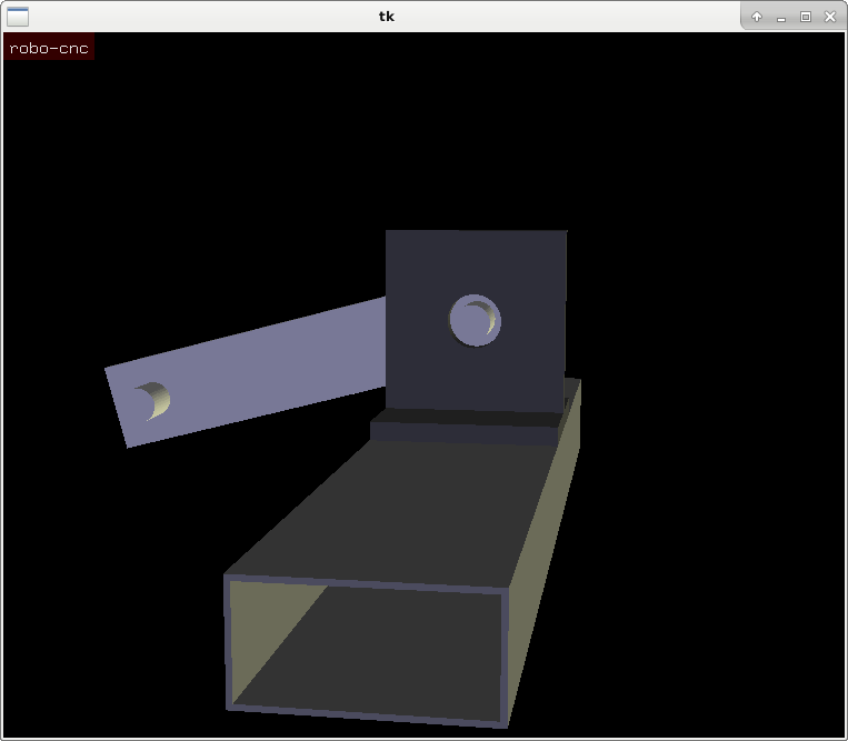

I am _far_ from an expert in kinematics, but I wonder if this is possibly a home position problem? Are the angles correct in machine space?

Hello Andy,
sorry but I just can not understand "Corners are correct in the space of the machine", you mean the angles of the pieces placed in vismash?
Regards, Chimeno
I didn't say "corners" I said angles.
If you look at the model and look at the joint angles in the GUI does 90 degrees look like 90 degrees?

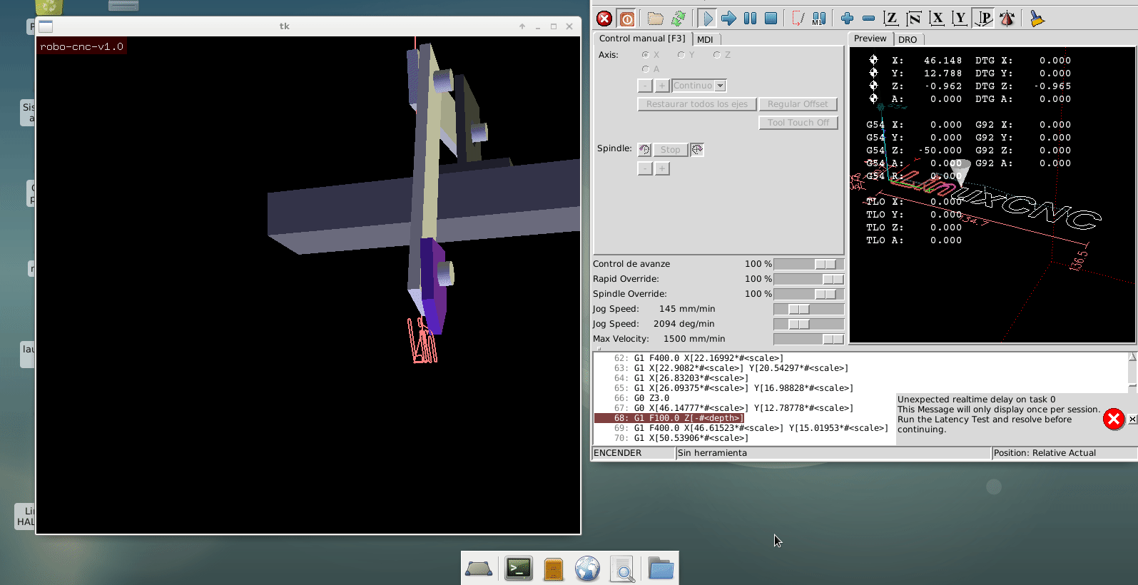

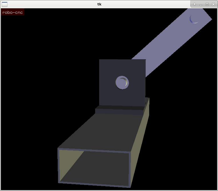

Hello Andy,
sorry I was wrong to write, been looking at the GUI but I am not able to see it ... I think it is 90º, but in the vismash it is not reflected.
Thank you
Chimeno
Try jogging to zero and 180 too, those should be fairly clear.
Unless the joint angles in the model match the commanded positions the Vismach preview will be inaccurate.
