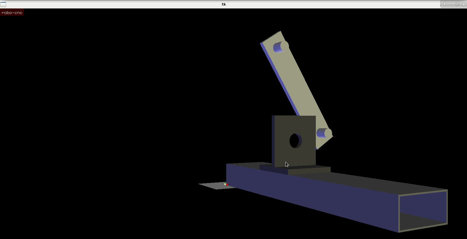

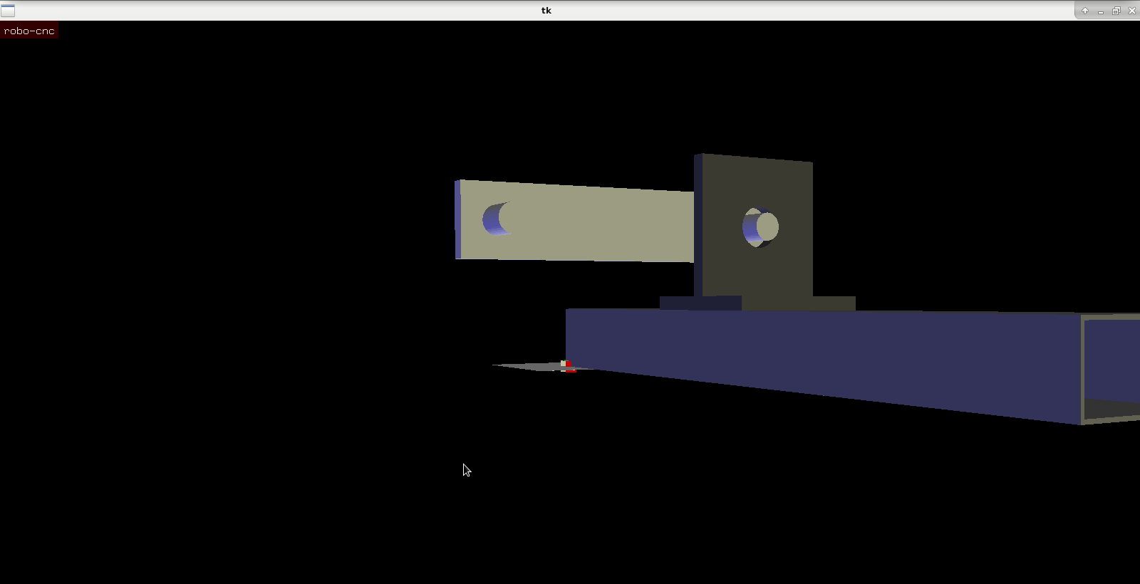

Hi guys,
I have a problem with the vismash simulator, I am not able to understand how I can change the center "arm-1" link3 to rotate on the cylinder, thanks Chimeno.
21 Nov 2018 17:07 #121137
Replied by andypugh on topic Kinematics... again:/
do you mean that it articulates on the wrong pivot point, or that you can't make it move at all?
I wrote the Vismach docs, but only after working out a lot of stuff by trial and error that I have since forgotten.
I can only suggest the same for you, look at examples and experiment.

21 Nov 2018 19:24 #121160
by chimeno
Replied by chimeno on topic Kinematics... again:/
Hello Andy,
thank you for answering, I mean that the pivot point is wrong, I tried to change it, I think there is some step that I do not do well, I am looking at all the examples in / usr / bin, I attach some screenshots to see if I am better, I'll keep doing tests, thanks Chimeno
