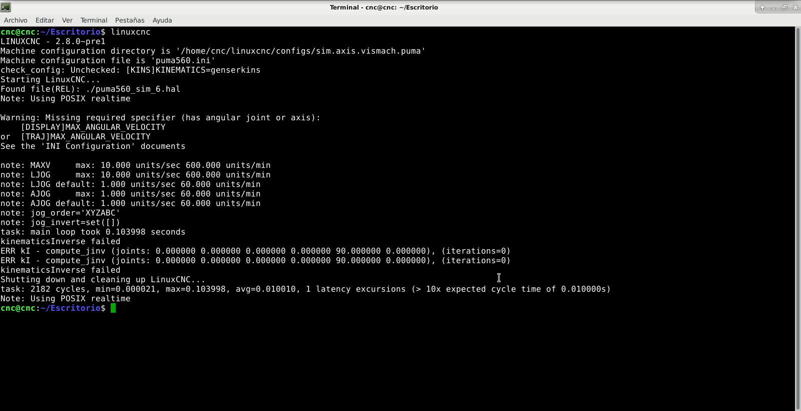

Hello Andy, I'm sorry if I did not explain myself well, I say if modified genserkin is tested and it works?
I don't actually know, sorry. I just advised a bit by email.

07 Jan 2019 21:12 #123723
Replied by andypugh on topic Kinematics... again:/
Hmm, not really.
I wonder if that was something that needed to be added to gomath to support sliding joints?

08 Jan 2019 19:56 #123788
by chimeno
Hi Thang,
these are the files that I used, if it works, let me know, thank you
Chimeno
Replied by chimeno on topic Kinematics... again:/
Where can i get that modified version? I assume i saw it somewhere but forgot.
Hi Thang,
Chimeno

11 Jan 2019 01:28 #123935
by thang
Replied by thang on topic Kinematics... again:/
Try change "Home" of joint 2 and joint 4( count from 0) in INI file to avoid singularities
The following user(s) said Thank You: chimeno
- chimeno
- Posts: 295
- Thank you received: 125
11 Jan 2019 20:14 #123989
by chimeno
hello Thang
Thank you, I have tried some different ways to start HOME_SECUENCE, but I still get the same error,
thanks Chimeno
hello Thang
thanks Chimeno
