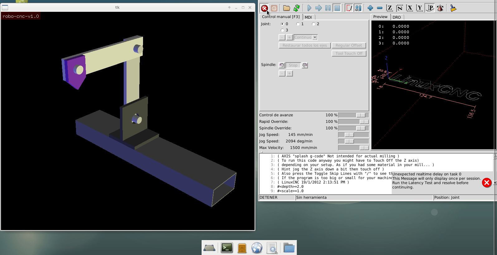

09 Dec 2018 19:58 #122112
Replied by andypugh on topic Kinematics... again:/
It clearly starts with the angles at 0,0,0,0. And if you look at the model they are x,0,90,90.
If you fix that then it might work properly.

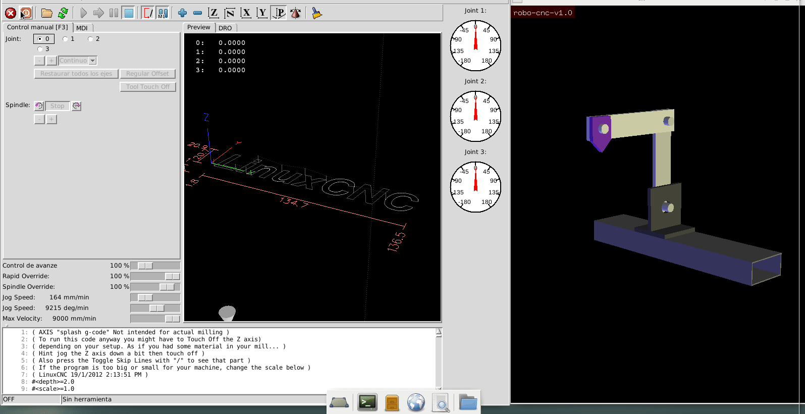

11 Dec 2018 20:44 - 11 Dec 2018 20:44 #122233
by chimeno
Hello Andy,
I'm progressing, I have corrected the angles .. I still do not work well the simulation as it should be, do you have any more idea that I can look at?
Thank you
Chimeno

11 Dec 2018 22:25 #122237
The angles still do not look right to me. Just before switching to world mode the arm is showing 0,0,-90, 90. But the sections are all 100% in line, so the angles can not be right.

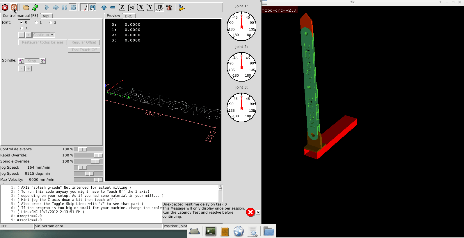

17 Dec 2018 20:11 #122532
by chimeno
Hello Andy,
Now I know how the angles issue works, now if I'm still perfect, the next problem that I find is that when I go to world mode joint 1 and 2 are reversed, I've been looking for a solution but I can not find it, you know the cause or where can I look ?, thanks
Chimeno

17 Dec 2018 20:42 #122533
Well, the position it goes to is a valid solution to the inverse kins.
So that looks like something that needs to be addressed in the kinematics file (it should always prefer an elbow-up orientation, I suppose).

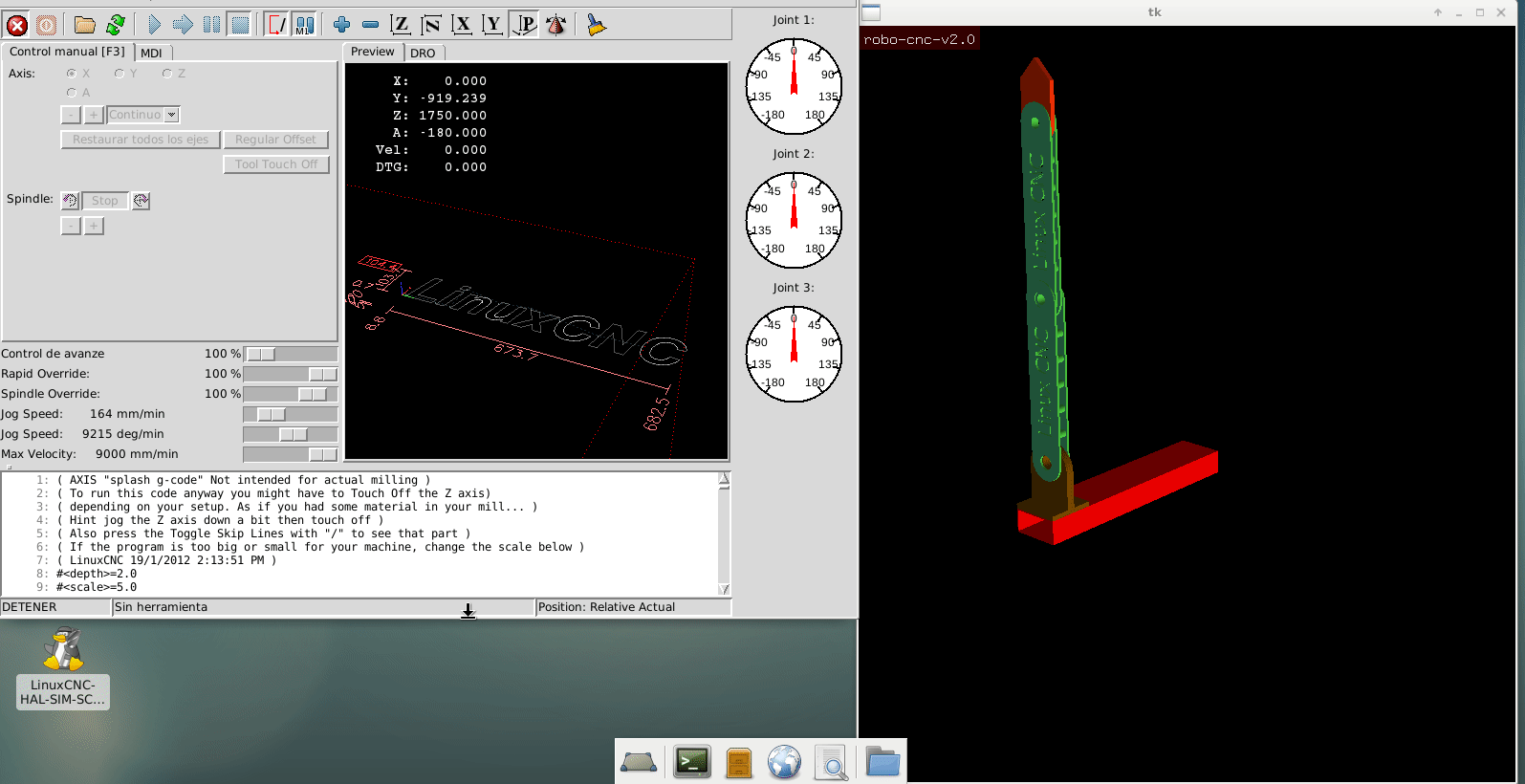

20 Dec 2018 20:13 - 20 Dec 2018 20:15 #122651
by chimeno
Hi Thang,
thank you very much for the help, modified the flag "if (* iflags)
q1 = q1; // q1 = -q1 "I'm learning little by little .. I attach the modified file and the screenshot to see the result, now I have to invert the Y axis, where would it be better to do this? in the cinematic model?, thanks Chimeno
