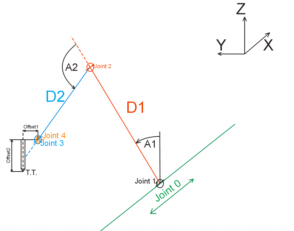

23 May 2017 16:27 #93552 by Boogie
Replied by Boogie on topic Kinematics... again:/
Giorgio The Kinematics Chellenge is great idea!:) Possibly is will lead us to the working kinematics module, and working examples of HAL and INI files.
However i'm not sure i understand your explainations on post #93474.
Let's assume the following kinematic model:
I believe many people will find it useful.
Assumptions:
Joint 0 - linear axis along X Cartesian axis
Joint 1 - angular axis. Rotation around axis parallel to X Cartesian axis
Joint 2 - angular axis. Rotation around axis parallel to X Cartesian axis and parallel to previous Joint 1.
Joint 3 - angular axis. Rotation around axis parallel to X Cartesian axis and parallel to previous Joint 2.
Joint 4 - angular axis. Rotation around axis perpendicular to previous axis.
Rotation axes of Joint 3 and Joint 4 intersect with each other and are perpendicular to each other.
D1 - arm lenght. The distance between Joint 1 and Joint 2 rotational axes.
D2 - elbow lenght. The distance between Joint 2 and Joint 3 rotational axes.
Offset 1 - the distance between Joint 3 rotational axis and spindle (tool) axis. Measured along Joint 4 rotational axis.
Offset 2 - the distance between Joint 4 rotational axis and spindle tool tip. Offset 2 vector is perpendicular to Offset 1 vector. Offset 2 have to take into account Tool Lenght Compensation from Tool Lenght Table (?).
Joints 0 thru 3 are used to move tool in Castesian X, Y, Z world. Joints 3 and 4 can be used to change tool angle U (around X axis) and V (around Y axis).
Are above assumptions correct?
Andy is it what your kinematics do?:):)
I do not understand why there is no Offset 1 distance taken into account in robokins?
23 May 2017 17:44 #93555 by andypugh
Replied by andypugh on topic Kinematics... again:/
Have you seen this page, which writes a simple kinematics module?
linuxcnc.org/docs/2.7/html/motion/kinematics.html
You can ignore joint 1.
x2 = d1.sin(a1)
z2 = d1.cos(a1)
x3 = x2 + d2.sin(a1 + a2)
z3 = x2 + d2.cos(a1 + a2)
And so on.
