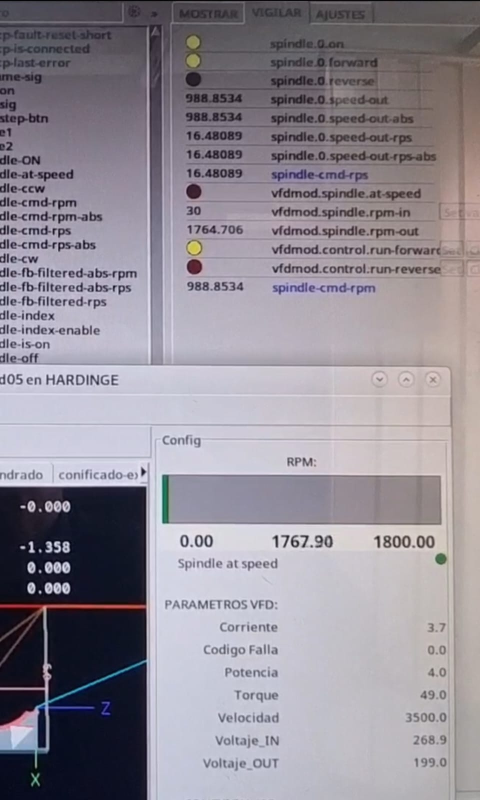

18 Mar 2024 21:12 #296254
by COFHAL
Replied by COFHAL on topic [ Vfdmod ] problems
I have found several problems with this component. First, it takes as feedback to the spindle the values reported by the control, but not by an encoder, for example from the spindle of a lathe, therefore the pyvcp is designed to obtain information from the readings via RS-485 but not from an encoder. external, therefore some files have to be modified so that spindle at speed is used with this feedback and not the original one. Another problem that I found is that the override control of the Axis GUI no longer responds, when the speed of the spindle is varied with this control in Axis, to vary its speed it does not respond even though the values in HAL do vary between what has been set in the ini file, the spindle speed only responds to G code commands or + or - in the Axis GUI, but not to the slider in the Axis GUI. Finally, when I controlled the VFD with +10 volts, the G96 code worked in CSS mode, now with control by 485 the speed of the spindle is always the same and the spindle does not accelerate as it does. diameter is smaller, nor does the feed increase.

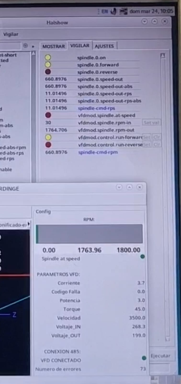

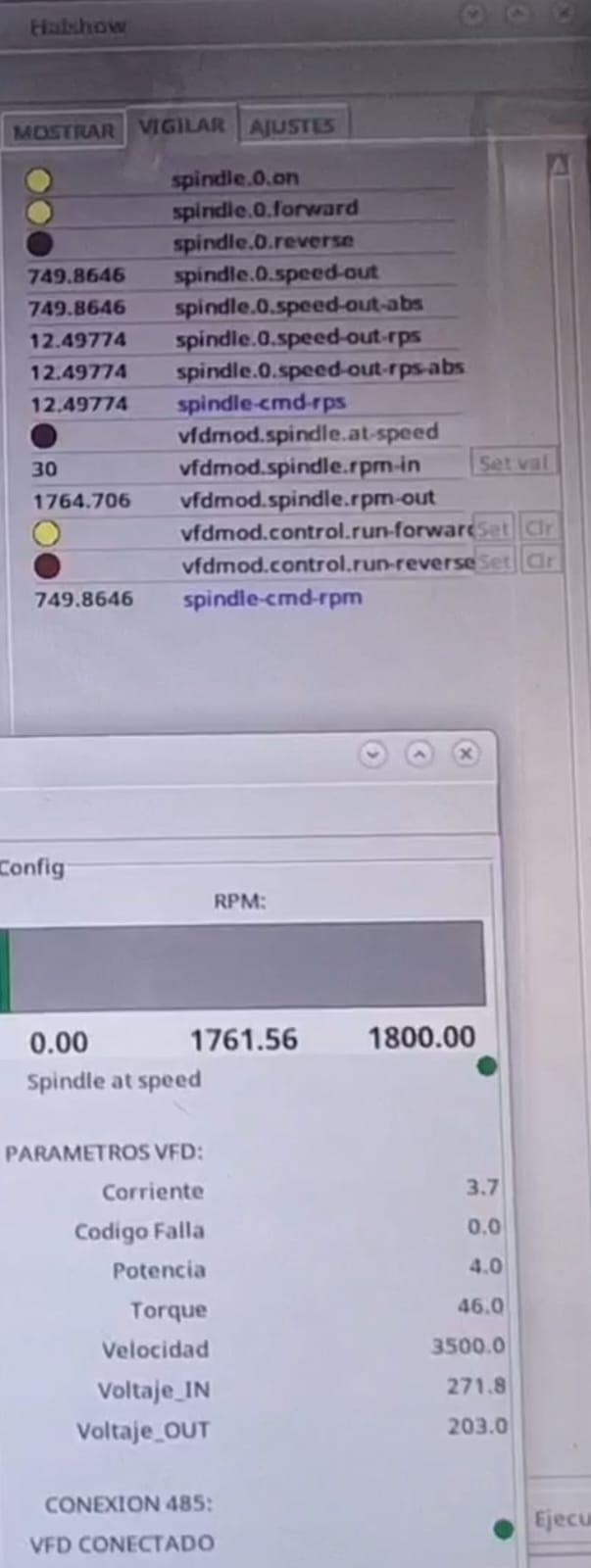

29 Mar 2024 16:23 #297120
by COFHAL
The VFDMOD component does not work with g code G96. When a code that contains that G code is executed, it automatically writes to the vfdmod.speed-in PIN the value declared in parameter D of G96. While in the other pins the speed change is reflected, which indicates that CSS is working. I think that since this component is designed for VDF of milling machines where lCSS is not used, for that reason it is not very useful when used to control the speed of a lathe motor. In the photos you can see that the commanded speed is different from the commanded output of the component, which always adjusts it to the maximum of parameter D of G96. I don't know if the same thing happens with the MB2HAL component.
- Posts: 12148
- Thank you received: 4144
29 Mar 2024 18:26 #297129
Replied by rodw on topic [ Vfdmod ] An easy VFD control over MODBUS RTU
I'm not convinced vfdmod won't work. Linuxcnc is controlling the spindle speed so it does not care about G96 or what kind of machine you have or even how you control your VFD. A spindle is a spindle. As long as your X axis is touched off on the centre line of the spindle, G96 should work if your config is correct.
I found this thread helpful when I set up mine. Please review the first post on page 2

30 Mar 2024 20:16 #297232
by COFHAL
You were right, VFDmod works with G96, it's all in how the different spindle and vfdmod pins are connected, unfortunately there are no clear examples of lathe configurations with this component.
