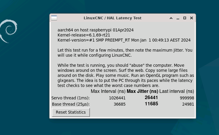

01 Apr 2024 11:18 #297355 by Pickle
FYI .. Pi5 works well with mesa 7i92 to give latency results shown in attachment.
