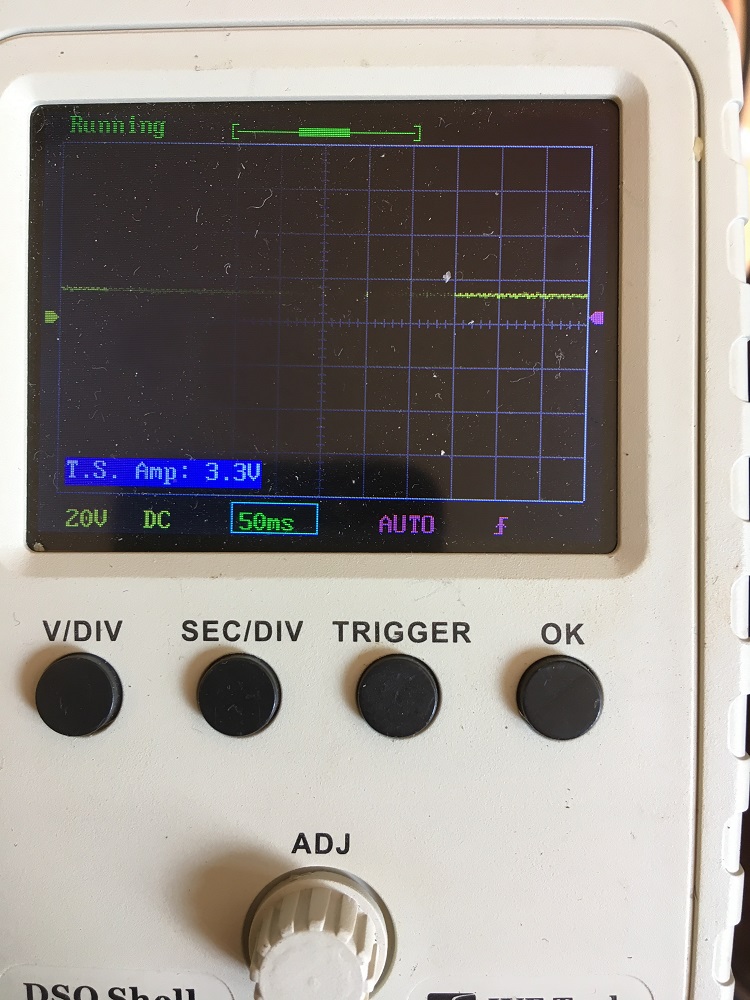

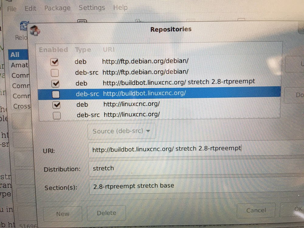

I was trying to add the correct buildbot URL's when it froze up. Should this be correct to update to 2.8?

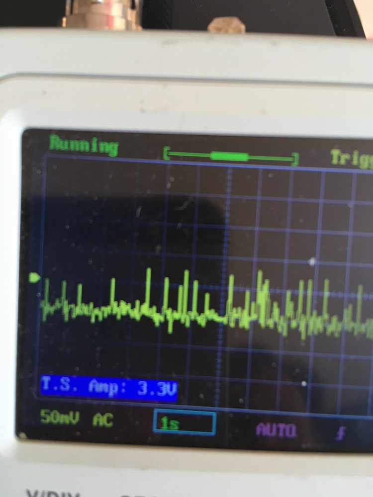

I was monitoring DC, and there was no obvious spike. The PSU outputs a pretty solid 19V, with just a very faint 50Hz ripple overlaid.
The next one shows the psu without a load,

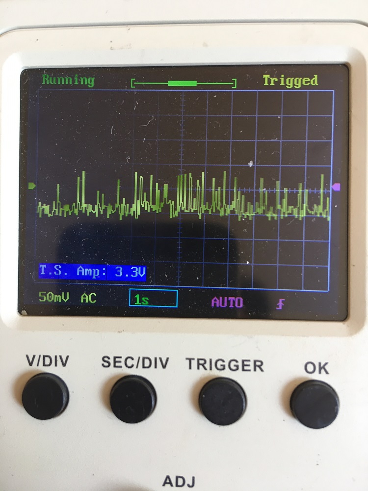

... and the trace just after it froze again. There was no obvious sag or spike.
