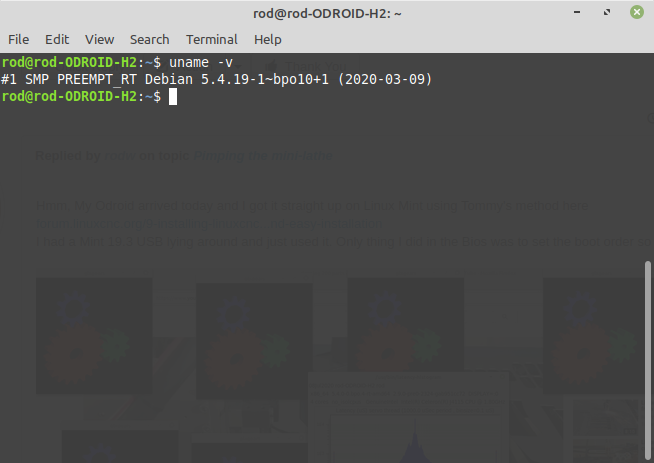

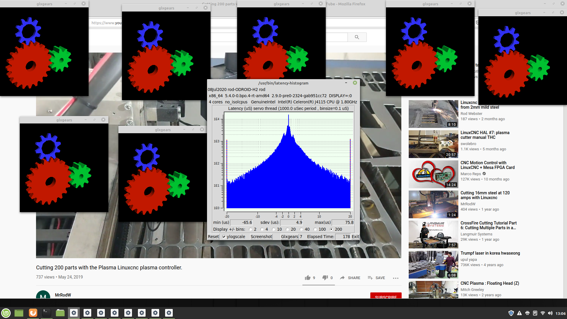

08 Jul 2020 03:21 - 08 Jul 2020 03:23 #173950 by rodw
Replied by rodw on topic Pimping the mini-lathe
Hmm, My Odroid arrived today and I got it straight up on Linux Mint using Tommy's method here
forum.linuxcnc.org/9-installing-linuxcnc...nd-easy-installation
I had a Mint 19.3 USB lying around and just used it. Only thing I did in the Bios was to set the boot order so the USB went first.
Bloody amazing!
Sorry Mark!
