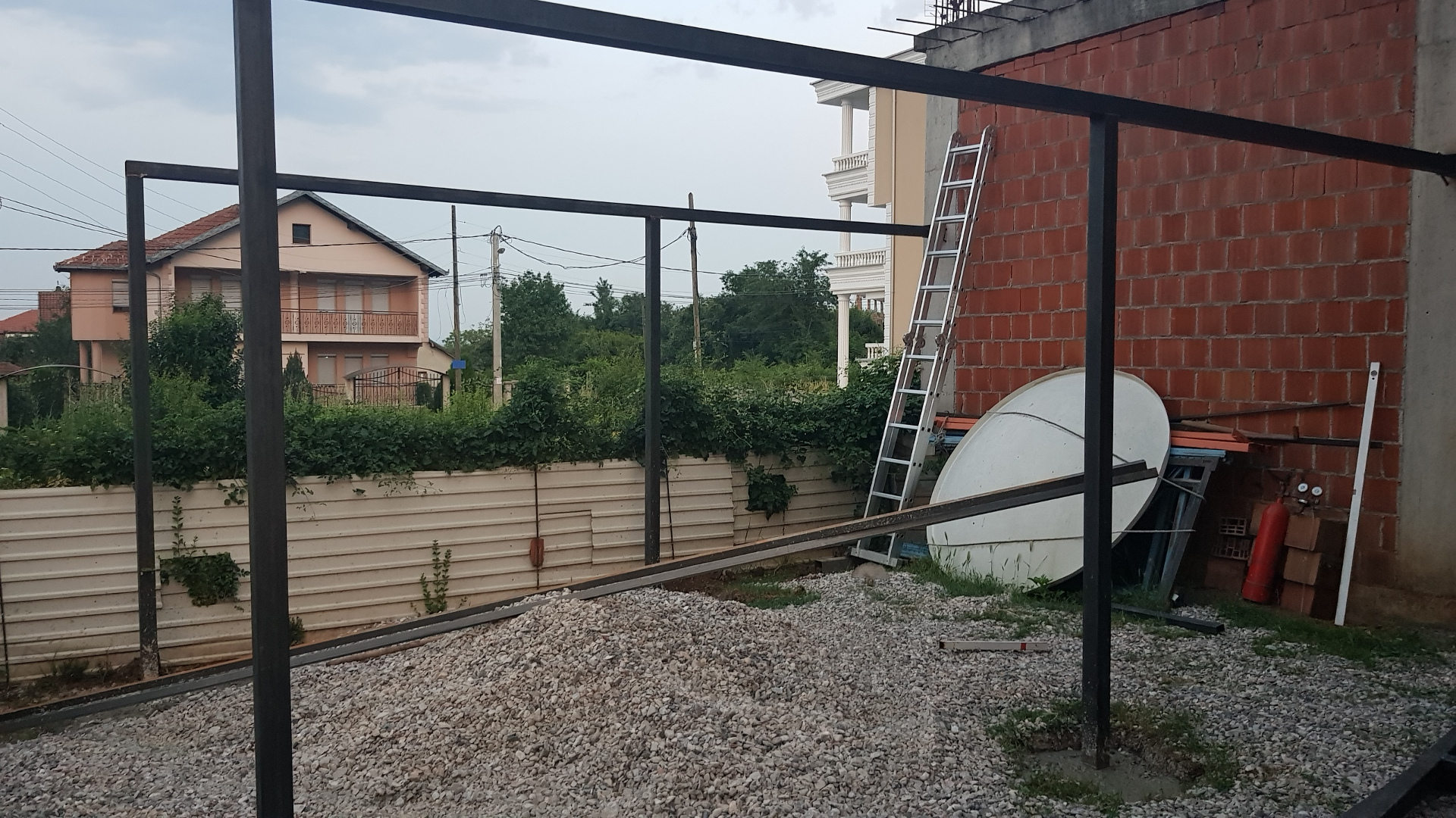

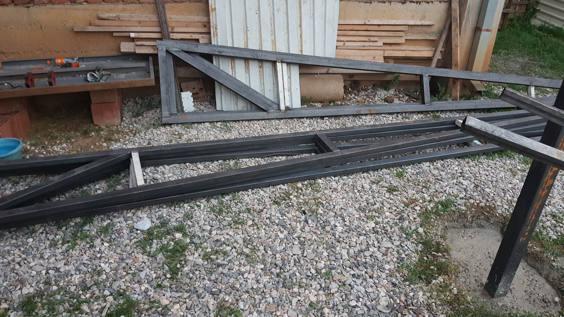

11 Jul 2020 18:33 #174318
Replied by tommylight on topic Pimping the mini-lathe
- RotarySMP
- Posts: 1635
- Thank you received: 595
11 Jul 2020 18:56 - 11 Jul 2020 19:09 #174319
by RotarySMP
Replied by RotarySMP on topic Pimping the mini-lathe
Some serious fabrication going on there. Like!
Last edit: 11 Jul 2020 19:09 by RotarySMP.
- Posts: 21959
- Thank you received: 7478
11 Jul 2020 19:35 #174320
30 SqM hut or carport as US calls it, but no cars will enter there, just my two newly built plasma cutters.
