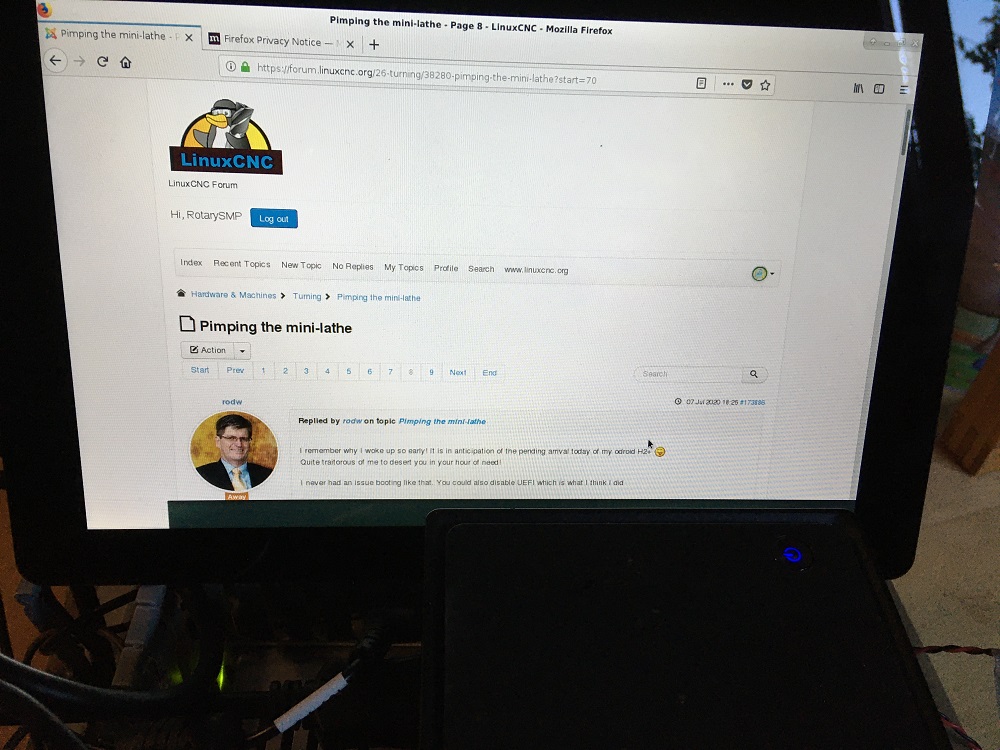

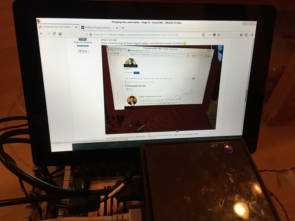

Well, it turned out that the MoBo Bios backup battery was completely flat. I replaced it, and then the Mint Iso worked. The stretch ISO still hung up the CD-Rom step, although both have the same Debian 9 installer.
So I got Mint installed, but something is unstable. I have booted it four times, and each time, about a minute after loging in, it freezes up.
Once, when that Mint "Panels" pop up came, the other times while I was loaded this thread in the internet browser to look up what to do next.
Once, I froze as soon as Rods mugshot loaded. I am starting to suspect his Karma
I am starting to regret buying this Gigbyte Brix. It is a real PITA. At this rate I might also start getting Oroids.
Mark

Does that have a J1900 in it? That cpu has a bug that seems to cause it to crash if the Max C-state isn't set to 1 on most newer Linux kernels. Check the C-state settings in the Bios. The J1900 I have works fine on my Wheezy Linuxcnc install though, but the same MB has given me no end of grief in my HTPC at home. You'll need C-state set to that anyway for real-time performance.

I think I'm going to have to take another selfie complete with trenchcoat, shades and hat over my eyes!
Actually you really should blame PCW as he reported good results for a Zotac J1900 back at the time and it was not available down under. I'll take some BIOS photos becasue I played with every available setting trying to get the best latency. Very occasionally it freezes but never when running Linuxcnc. Or when I am looking back at me!

Last edit: 09 Jul 2020 19:41 by RotarySMP.
