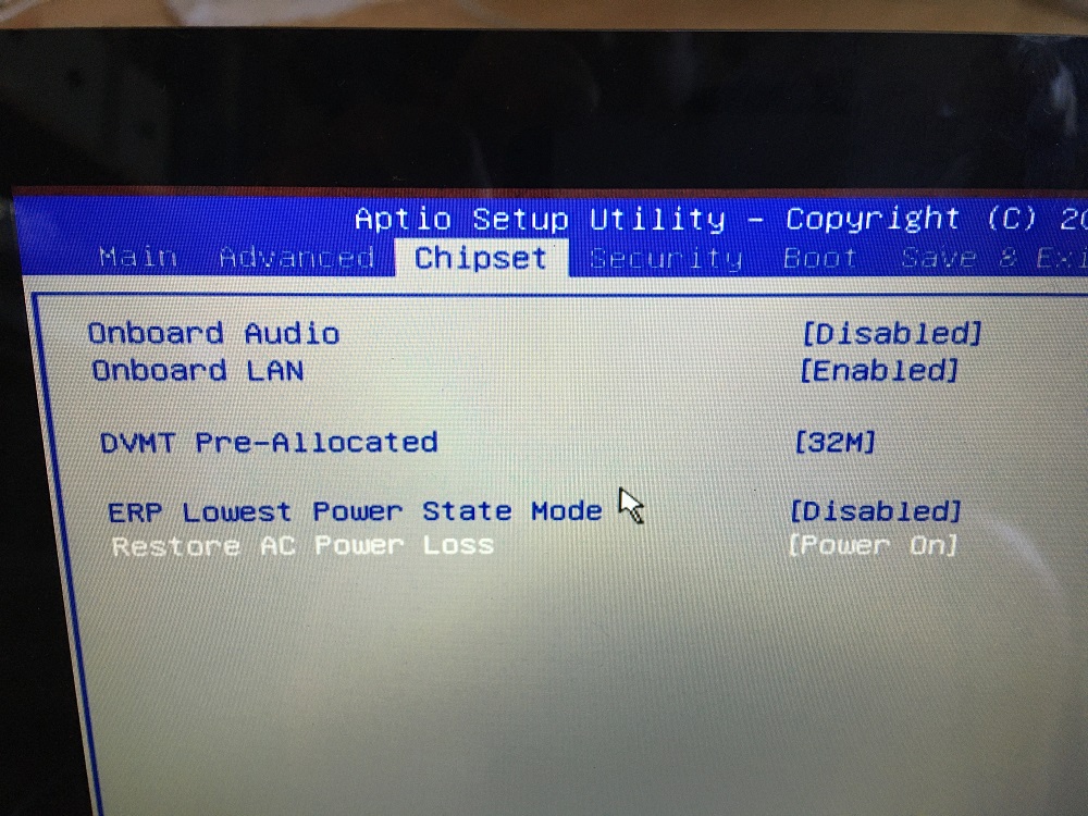

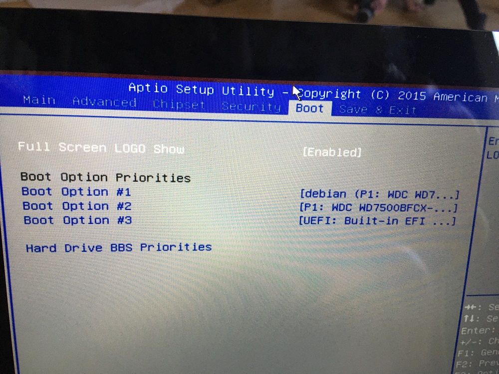

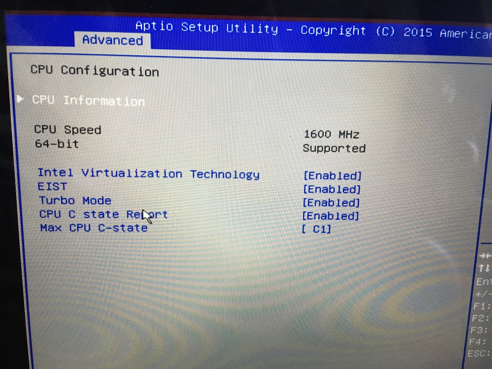

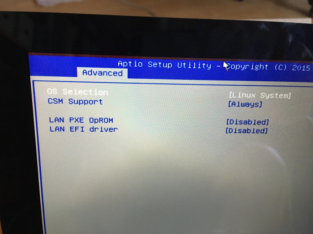

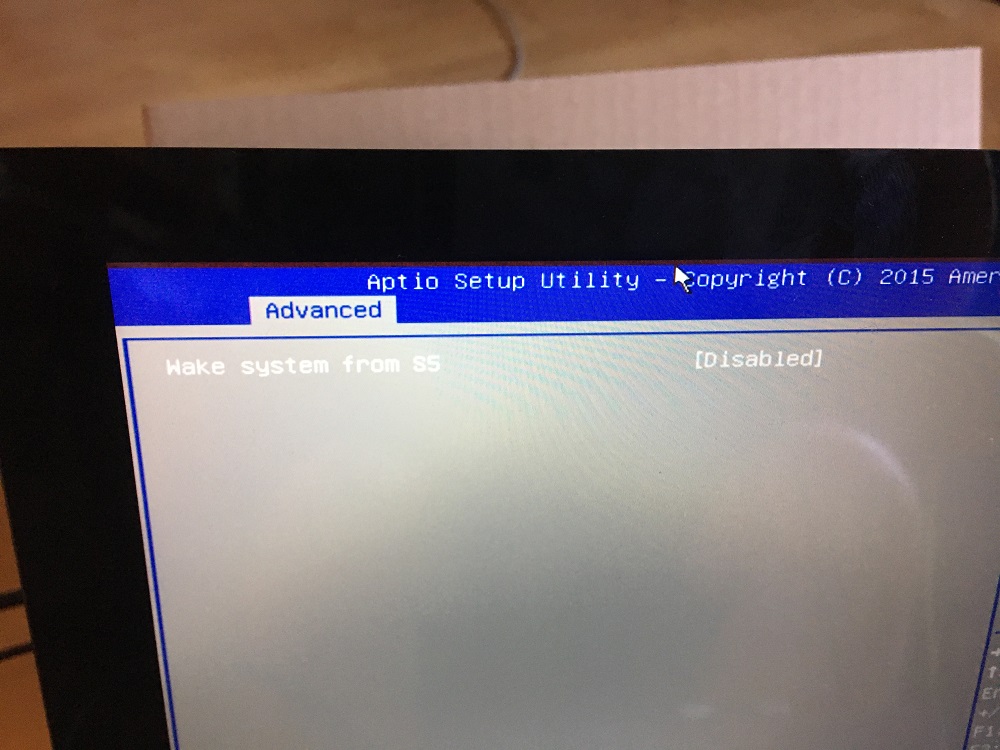

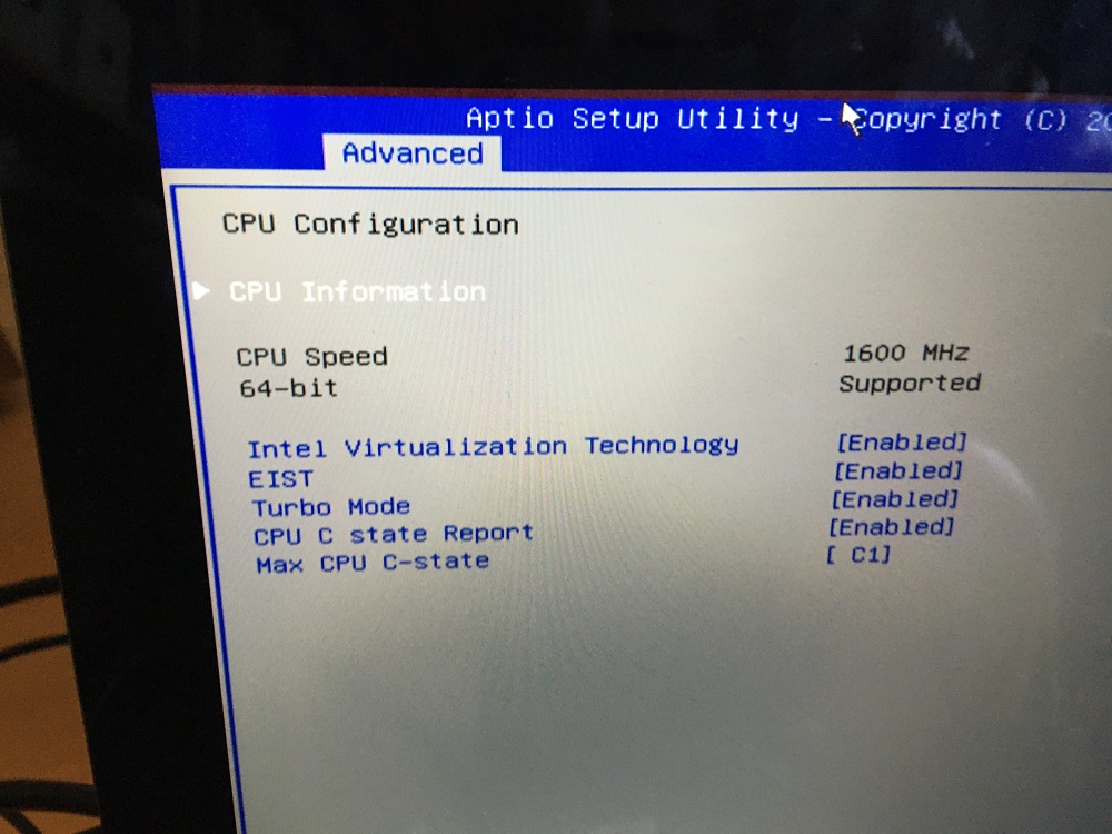

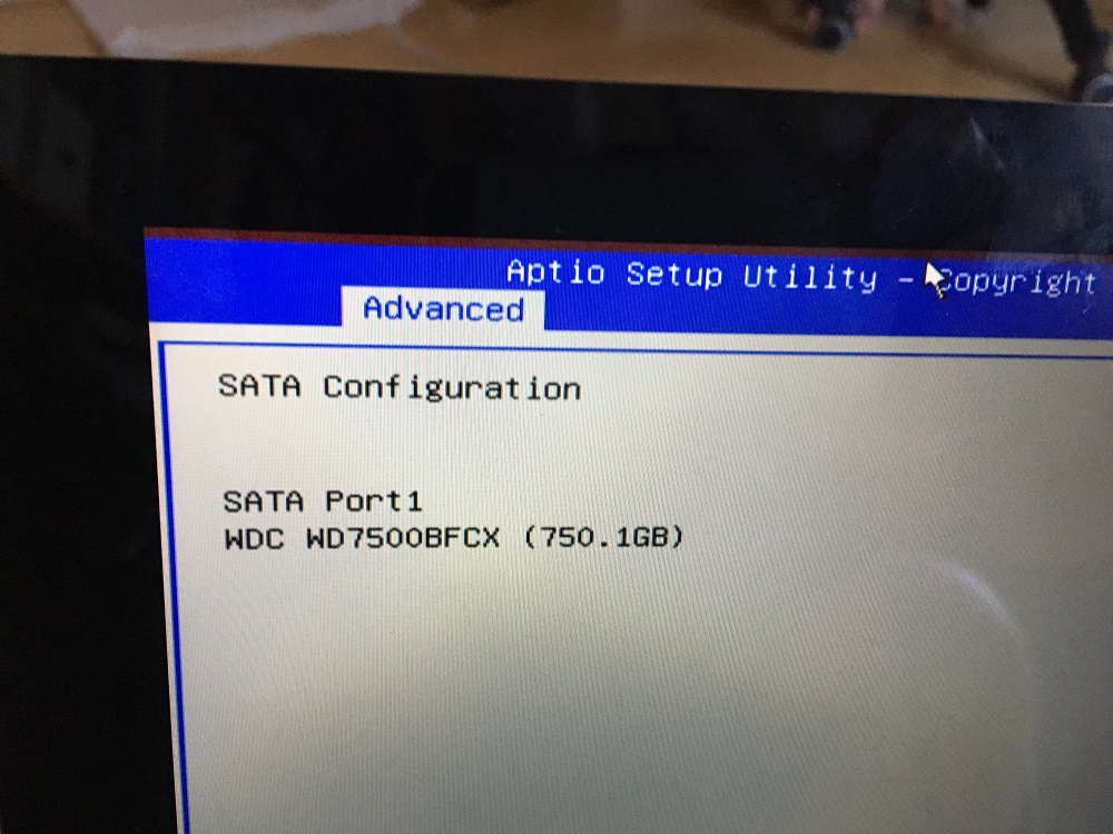

Here are the current bios settings...
Any suggestions of changes appreciated.
It did run for longer befoer locking up today. About 3 minutes, so maybe there is a heat problem. That would suck. I was doing a latency test, and it was giveing about 64000ns on the servo thread and 55000ns on the base thread. Also not great.
Mark
Mark

The latency is fine for this kind of PC and the mesa card will be happy as. This sounds very familiar to what I experienced with a couple of J1850's.
I would suggest you uninstall thermald
There are reports of similar lockups on the N3150., See arstechnica.com/civis/viewtopic.php?f=16&t=1322553

I would disable EIST and Turbo mode.
The lockups may be Intel video related, you might try adding
intel_idle.max_cstate=1 to the kernel command line (with grub)

My feeling is that you should switch off nearly everithing on the first page.
For yor freezing have a look
www.tipro.net/shared_files/support/disab..._state_reporting.pdf
Disable C-State reporting with J1900 CPU - Tipro
