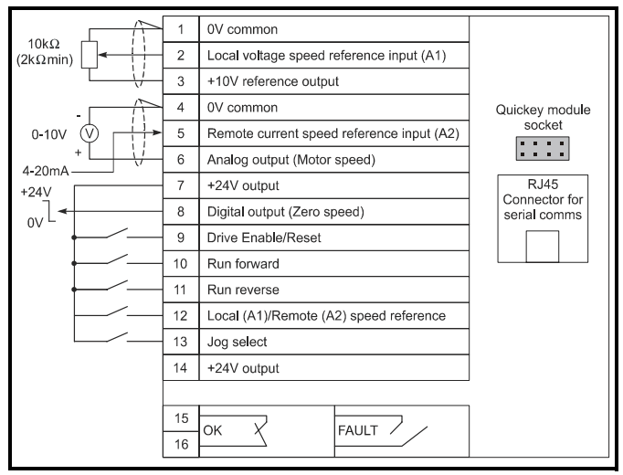

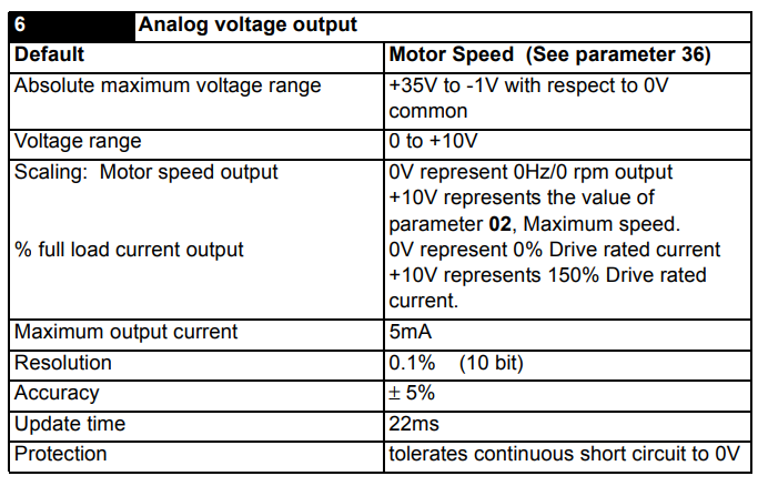

21 Aug 2019 15:44 - 21 Aug 2019 15:45 #142738
by randypetersen
Replied by randypetersen on topic Retrofit of Precix 5x10 CNC
Thanks Todd! Great info.
Not sure if my VFD has that output, it does have an analog output, not sure if would correspond to the ramping issue. Do you think I could use the attached VFD output to make sure the spindle is up to speed?
Also, I will review ramping of the VFD. It's lumbering up to 12000RPM now, and the coasting to a stop even takes a bit longer as i recall.

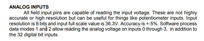

- randypetersen
- Posts: 136
- Thank you received: 15
23 Aug 2019 12:52 #142988
by randypetersen
Was thinking I will check voltage on that pin #6 to see if it climbs as the spindle ramps to speed or if it mirrors the analog input voltage.
Not sure how I can set that up in LinuxCNC instead of "at speed" pin it would have to be "at a level about to the output speed" I know the 7i77 has an analog inputs.
- Posts: 22043
- Thank you received: 7506
23 Aug 2019 14:55 #143000
Replied by tommylight on topic Retrofit of Precix 5x10 CNC
It should work.
I have it set for 3 axis on a mill with yaskawa drives, they output only 3V max for the 150% load so i had it scaled in hal and pyvcp, it can also change colors so it is easy to see from far.
Mesa 7i92 with 7i77 set to mode 2.
